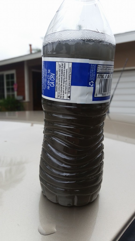

How's your timing? IIRC, wrong timing can make engine run hotter.
How's the shroud? Need that to direct airflow through radiator.
Was the system flushed recently? Coolant passages may be blocked.
I did a heavy-duty flush on mine as described by Prestone on its flushing solution container. Even with our 2007 Corolla which had fresh-looking coolant, I found the water this dirty when I did the "heavy-duty flush"
Timing should be good. The crew that did the timing chain have done it plenty of times before. That said, I wouldn't know for certain. I'd have to figure out how to check.
Shroud is great. Fan is pulling strong.
System wasn't flushed, though it did lose a lot of coolant during the work on the system and was filled with mostly new fluid. Could be sediment in there though.
