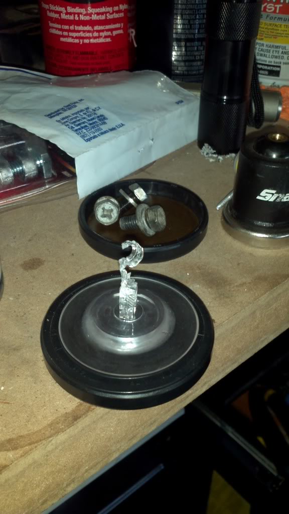

I just did the driver side cam plug. Its very doable without removing anything. Its a little tight getting a wrench in there but a ratcheting 10mm box wrench worked well for me.
Getting the plug out after removing the plate was no easy feat. While at a walmart, I looked around the bathroom section and found some suction cups that looked like they would work. Clean the old plug real well and slowly work it out with the suction cup. It took me like an hour because I was pulling too hard and popping it off.
Pull slow and firmly and mine eventually popped out. I put a small film off black rtv and reinstalled. No leaks yet, still gotta do the pass side. Good luck.
Heres a pic of the suction cup I used, I forget the exact size.
Great info! When you bolted the cover plate back on did you torque it to specs or just tighten it up? How can you get a torque wrench in such a tight spot anyway??
