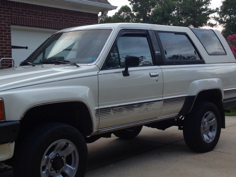

So here it is guys I'm looking to put this 92 engine that has been rebuild from a donor truck into my 86 runner. I know the long blocks r the same. But my question is how much can I keep off of the engine and use in my runner. I know I have to use my harness and the injector r different but what else is different.
Here why I ask. My 4runner all of the vacuum lines have been capped off and I would like to restore it back to original as I can. My engine is on it's last legs and I need something else ( also I'm not able to rebuild it cause the block is crap and been done already once).
The truck I'm looking at I can get pretty cheap and everything is their but the guys has put all performance part and heads (LCE from top to bottom) did a great job on the engine but I know the long block will work but what else can I use from the truck.
Any information would be great. Thanks guys
Attached Thumbnails 92 22re to 86 4runner need help-image-3995346456.jpg   92 22re to 86 4runner need help-image-325045210.jpg

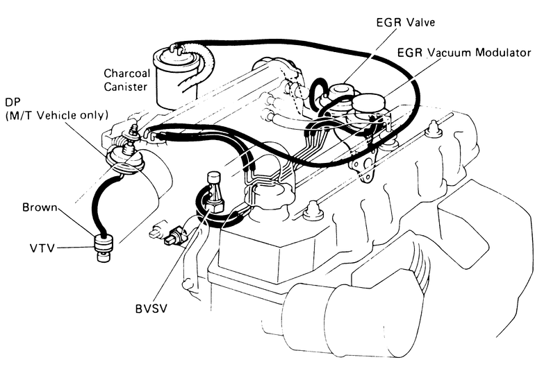

You should be able to make it work. Correct your vacuum lines, VSVs, TPS, and I think that is it, but could miss something.
1985-87Toyota22RE

For the most part, the main vacuum lines should work, they are very similar....You should be able to get it running and then tune from there. I would take a pic of whichever engine has all the vacuum lines routed to use for later or look on the net, there are plenty of pics showing the stock vacuum line routing and all the valves and sensors, then take the engine out of the 92, put the upper intake plenum and injectors from the 86 onto the 92, and drop the engine into the 86.
