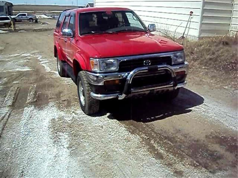

ya fair enough. I dove the 22re last night and it was a little sluggish. nothing i couldn't live with. but it got me thinking that the 5spd 3.0 might be the way to go. this is her:

Looks nice on the pictures. Check carefully for rust. Not having the chrome trim around the wheel wells is a good thing in that regard. The chrome strips trap moisture and lead to premature rusting there.

ahhh turns out the guy was skeezy and he was claiming the 4runner was in mint condition nothing wrong with it, factory parts, never been fixed. ... he left out that it was written off in 2011.
