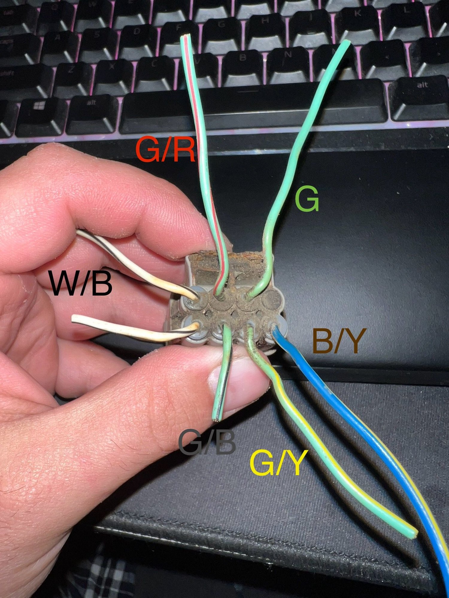

Using the old wiring cut the not needed end off and add your plug and color match the wiring i did
Making Wiring Harness
Green/Black = black
Green = Green
Green/Red = Red
Green/Yellow = Yellow
Blue/Yellow = Brown this is for the sensor it can be used for an indicator light
2 White/Black can be combined

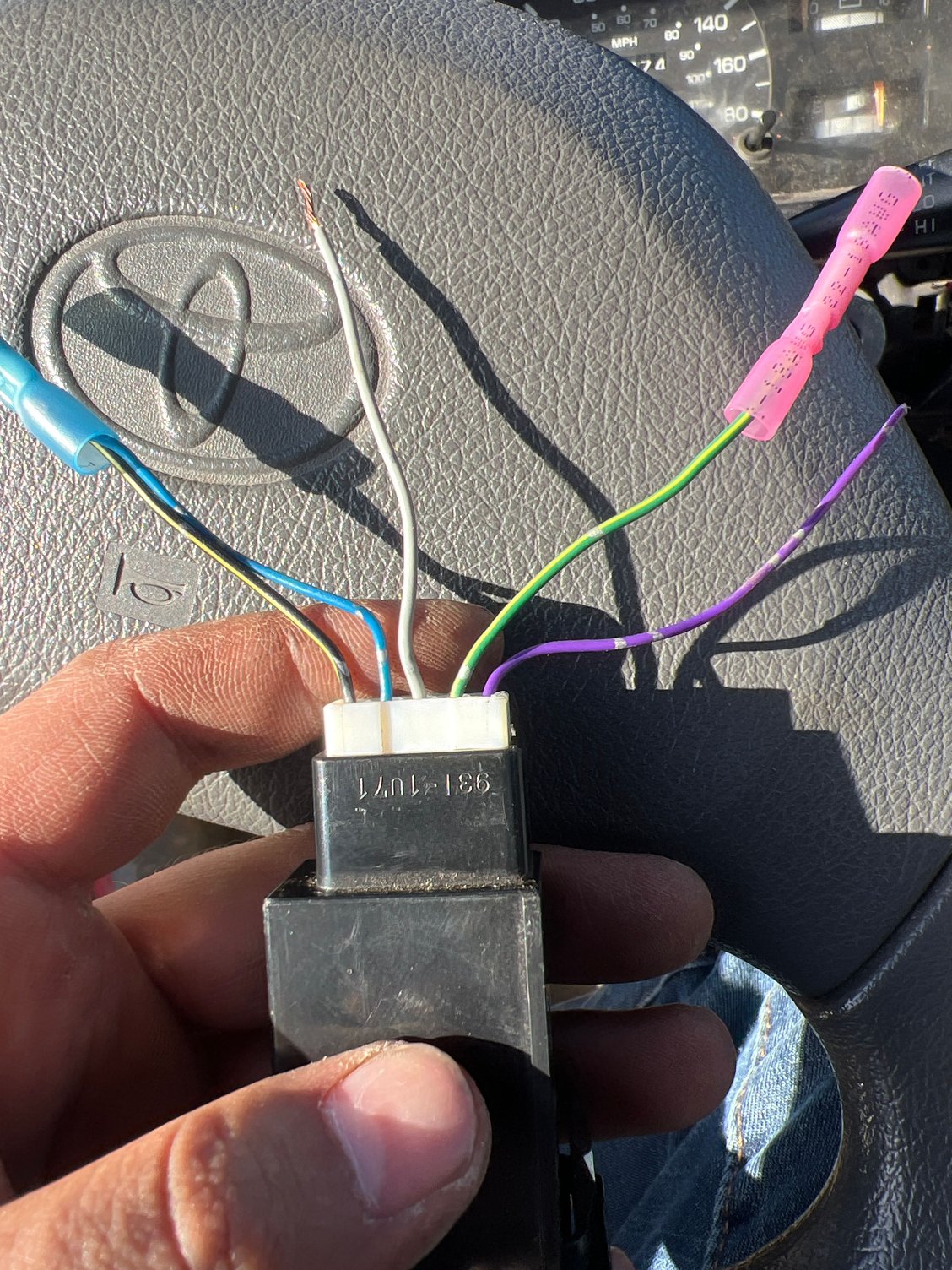

Toyota Switch
Now the stock Toyota Switch only came with two wires
The black and green
There is a light in the switch that has no connection if you want to uses the light you can cut and unpin the clock wiring and use the pins and wires
I added Blue, Gray, and Purple
Blue and Gray are for the light inside the switch
Purple is another power out source if you want another exterior light when it is pressed in
Blue and Black can be combined
Gray is Ground
things get a bit fussy for me cuse it was the las thing i did, but i believe black and blue are power and green is power out (could be the other way)
