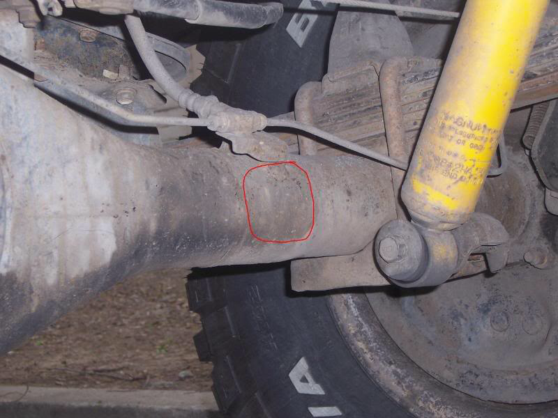

Old Jan 21, 2014 | 03:57 PM
Tugs's Avatar
Joined: Dec 2013
Posts: 19
I had to get the leaf spring seats from a junk yard due to the previous owner of the truck not having any shocks or lower mounts on the rear. I told them what vehicle I had and what I needed. I tried to look at some pictures unline but have been unsuccessful. The leaf spring seats which have the lower shock mount on them are on the opposite side of the axel as the upper shock hanger so when you put the shock on the lower mount the upper mount is on the other side of the axel. The shock tube hits the axel and won't let the shock mount on the upper mount. if you turn them upside down they will work fine. My passenger side leaf spring plate has the lower shock mount in front of the axel ( if I mount it the other way the shock is offset the wrong way not straight) and the upper shock mount is behind the axel. Does anyone have pictures of your rear lower shock mount? Are there different plates for different year trucks? I think the 2wd one is not curved it fit the round axel it is more flat.
Old Jan 21, 2014 | 04:12 PM
JasonYota's Avatar
Joined: Mar 2013
Posts: 2,121
From: Mobile, Alabama
Best pic I found on google.
Old Jan 21, 2014 | 04:28 PM
Tugs's Avatar
Joined: Dec 2013
Posts: 19
I am assuming that is the passenger side from the rear according to the gas tank location. it looks like your leaf spring plate is opposite of mine. If I turn mine that way the bolt will be towards the wheel and the shock wont be straight. DO you know if they make different year shock plates?
Old Jan 21, 2014 | 04:33 PM
JasonYota's Avatar
Joined: Mar 2013
Posts: 2,121
I'm not sure on the year differences. Did the PO of the truck happen to do a U bolt flip and just didn't weld on lower shock mounts?
Old Jan 21, 2014 | 05:31 PM
Tugs's Avatar
Joined: Dec 2013
Posts: 19
I don't believe so it looks like yours just backwards. Is there a difference between the ext cab and standard cab? They are priced different from Toyota. Like $20 each
Old Jan 21, 2014 | 06:01 PM
JasonYota's Avatar
Joined: Mar 2013
Posts: 2,121
There shouldn't be a difference. I know the 2wds are spring under, and the 4wds are spring over. Post some pics of the mounts you bought
Old Jan 21, 2014 | 08:42 PM
Punchy's Avatar
Joined: May 2012
Posts: 591
From: 91765
Jason's picture above is what I have on my 92 EC 4x4.
Old Jan 22, 2014 | 03:45 PM
Tugs's Avatar
Joined: Dec 2013
Posts: 19
I think the guy at the junk yard game me the wrong leaf spring seat (lower shock mount)
Old Jan 24, 2014 | 04:38 PM
Tugs's Avatar
Joined: Dec 2013
Posts: 19
OK I got a resolution the guy at the junk yard mistakenly gave me T100/Tacoma leaf spring seats. he got me the correct ones and shizam!
