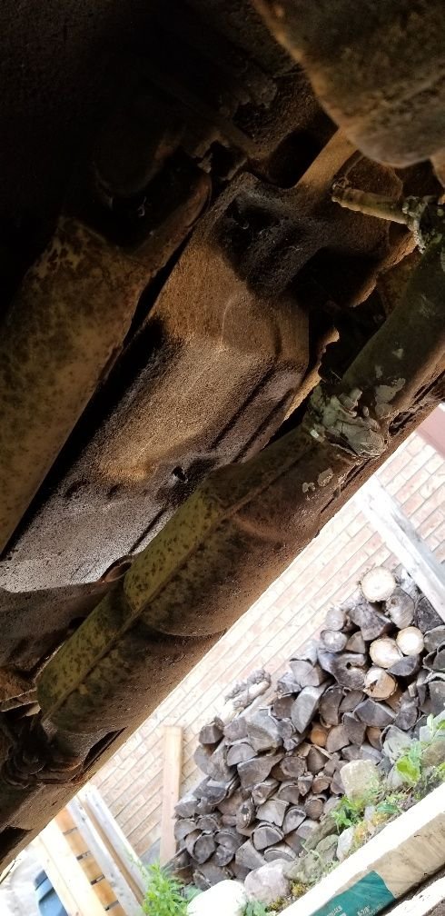

You can see the rust hole by the exhaust
