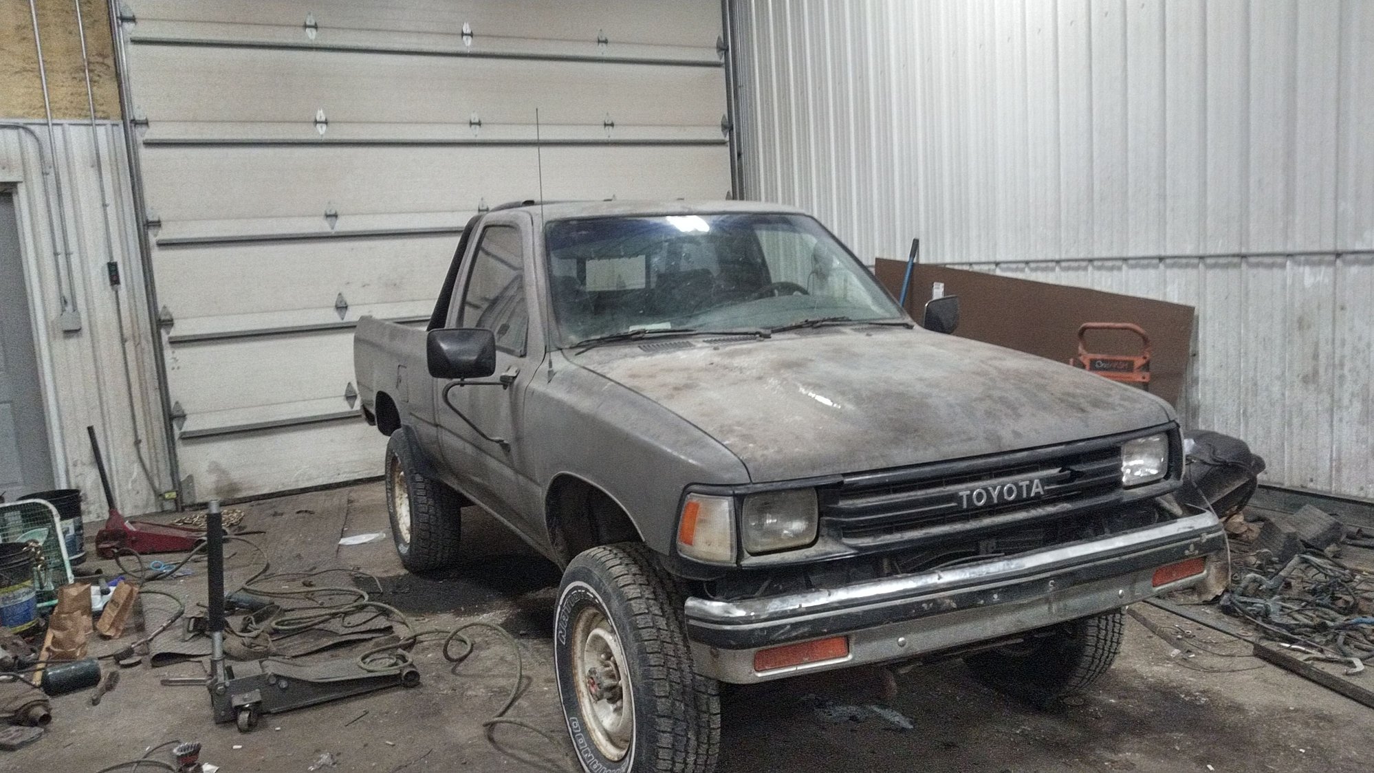

now the biggest issue was the donor truck was a long bed mine is a short bed so i had to shorten the frame under the cab 9 inches move the rear 2 cab mounts the cross member and front two bed mounts also had to move the short bed tank mounts and fuel tank over to the 86 frame.
after the frames matched i painted the rest of the frame and then started putting my 89 body on it
used all the brake lines ect from the orrigional frame started getting everything hooked up had to cut out the floor for the transfer case shifter
after all the nessisitys were hooked up was able to take it for a spin around the yard

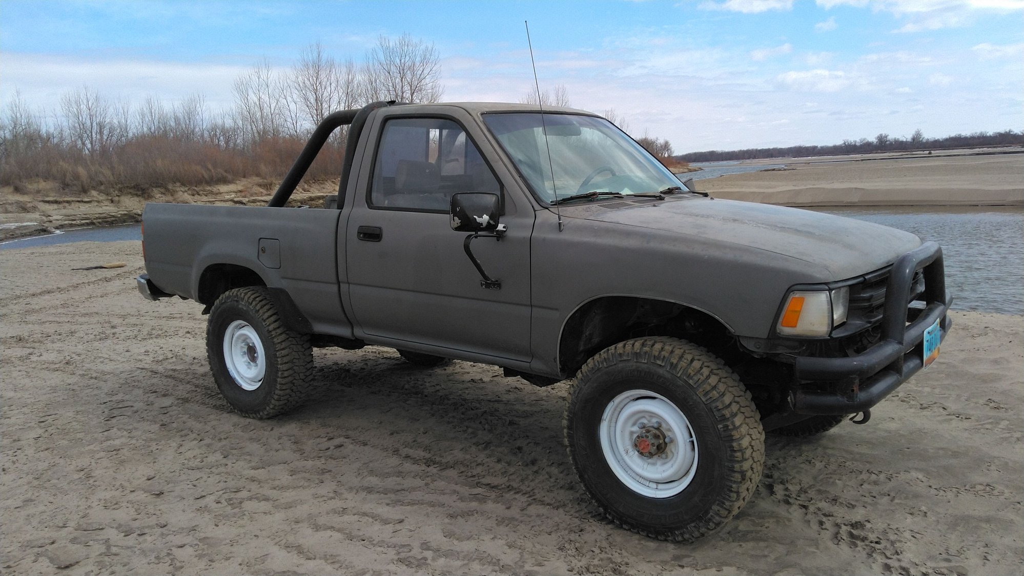

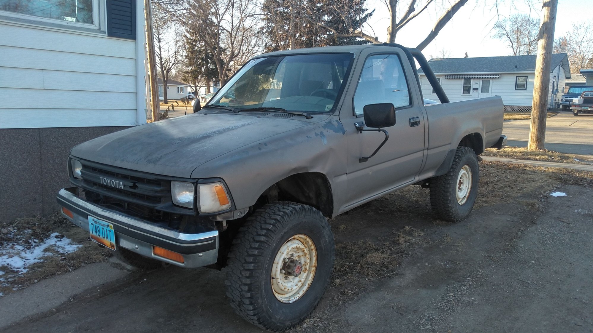

after things were mostly sorted out i could set the bed back on
after the hood went back on it was actually starting to look like something again
first time on the highway
even drove it home for the first time in many years and got its 31's swapped over to the 4wd rims

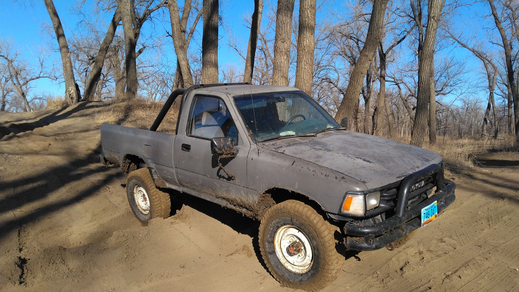

swapped out the s10 bumper for the tube bumper that was on my truck before and then took it out and did a little wheeling
the rusty rims were bothering me so i had to clean them up and paint them
still a lot more to do to this truck, engine will probably have to come back out at some point to be freshened up. it was locked up a week ago after all...lol but its very enjoyable to have this truck derivable again after so long.
