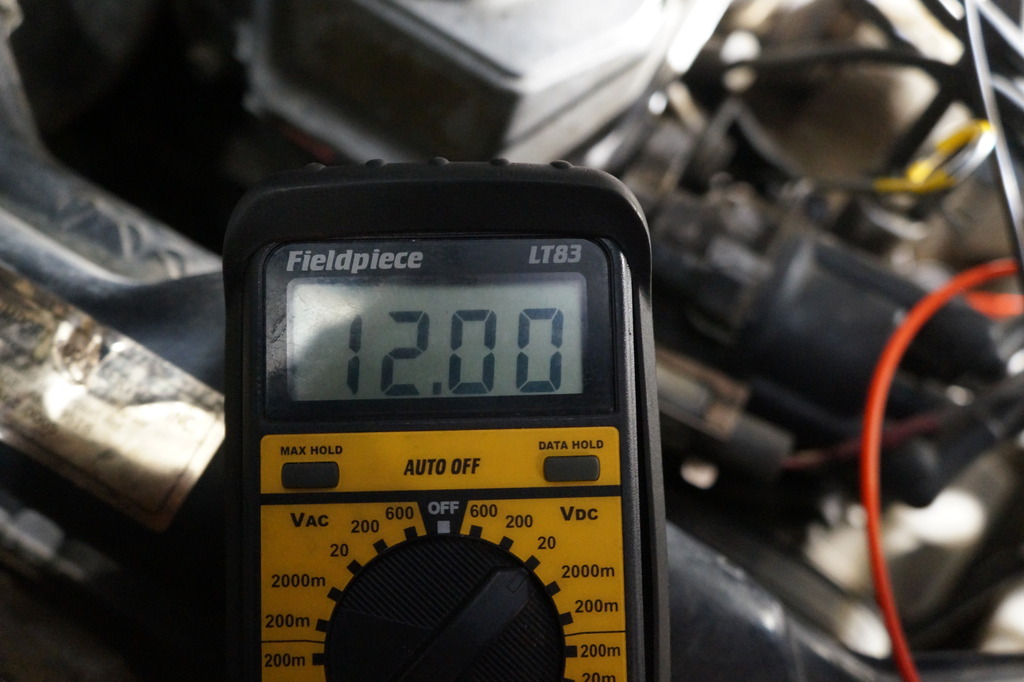

Okay so tested altinator, passed twice failed once. Swapped for a new one, and put it in.
Ignition is reading 12v,
white S read 12,
And I believe the other white one "B" was also 14.7 if I remember??

I was measuring at the battery. 11v on with no draw, goes down to like 9.3 and chops out past. I measured the altinator I had before I got the new one tonight and It was only charging to 30amps. New altinator does the same but I didn't measure the amps it was putting out

Old Jan 4, 2016 | 09:14 PM
Radchadtrinidad's Avatar
Joined: Jan 2016
Posts: 60
Recap:
think white wire "B" read 14.7 cold. Can't remember what it was hot so I'll test it again tomorrow
"S" read 12
"IG" read 12 constant

Sounds like you have bad battery. What do you read at battery post when all is off?
Old Jan 4, 2016 | 10:51 PM
Joined: Jan 2016
Posts: 60
Put a load tester and tried 2 different batteries, same story. Read 12

A charged battery (without load) should read about 12.6volts. A big load could pull it down to 12.00v, but if it's just sitting there at 12.00v it's almost completely discharged (the last few tenths are temperature dependent, so don't over analyze this).
When the engine is running it should read about 14.1v AT THE BATTERY (and everywhere else on the "12v" bus)
If you're getting 14.7v at the alternator (altinator?) but 12v at the battery (or S or IG), the alternator may be working but you may have a broken B output wire (the big one from the stud) between the alternator and the battery. With 12.00v on the S (sense) wire, the alternator's regulator keeps boosting the output voltage trying to bring S up to 14.1. That could explain your rather high 14.7v on the B wire. http://www.cygnusx1.net/Media/Supra/...otaTech/h8.pdf
And if the B wire is not connected to the battery, you will have no charging.
