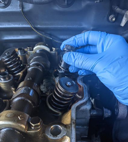

Bought a machined head, timing kit, oil+ water pump, gasket set, rocker arm assembly and head bolts
but now number #5 head bolt is broken..
