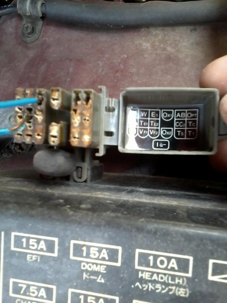

To set the timing and to pull codes, you use a paperclip in like what is in the top picture for yours. The older style is on the bottom, just posting it for others.
I have had clogged converters to fuel filters to not letting a tuck run to its full potential.
Codes... http://4crawler.com/4x4/CheapTricks/...es/index.shtml
How to get Check Engine Codes. I just put this up for others. Applies to 87 and up. 86 and older is the bottom picture.
The Diagnostic port for the 85-86 is on the Drivers side inner fender and is nothing the same as the 87 and up. Here is T1 and E1 jumped. The codes and engine flashes are the same as the rest of the trucks on the dash.
