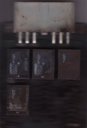

Battery was dying. Finally found source of 150 mA drain. Seems the rear window relay can get wet when the top is off all summer. By the looks of it, it been wet a while. I have a spare. Just a heads up for thos who go topless and things get rained on. Poor pic attached.
