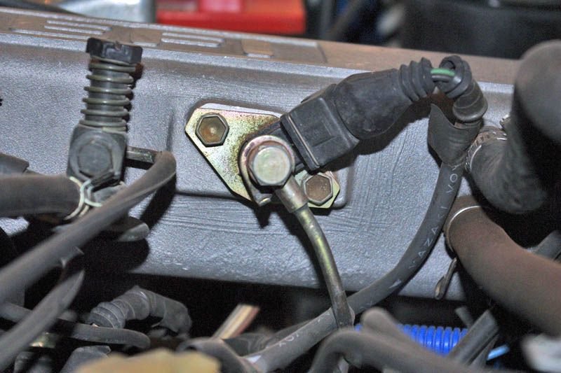

Just make sure the cold start injector plug is seated all the way in the injector itself.
Not my pic. by the way.

"Maco35"- yep! The cold start injector plug appears to be seated properly. Perhaps they go bad? Would this be something to replace or clean?
Today, after shoveling snow off the hood, I removed the intake hose from front of EFI area & shot a little engine starter in there. She started up after x2 tries. So, thoughts? Suggestions?

Hey Macro,
I double checked that the cold start injector bolts were tight. I actually have a gasket (paper) between this plate & the grey surface. It has not been tampered with and starts when it's warm, not when it is cold however. So I am guessing it is seated fine. Thoughts?
