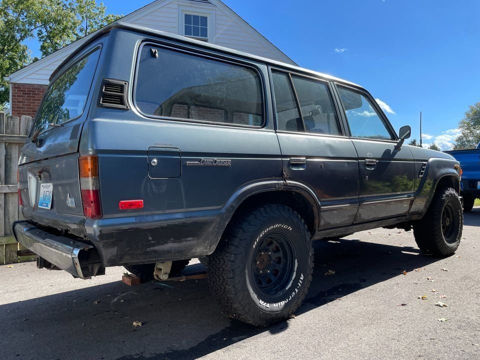

and a couple random pics of the 80&60

Excellent pics!!!! Personally I like the 14’s on a 2wd, although they are getting harder to find at tire shops they are so so much cheaper and I love old steel wheels. I’m going to ditch my aftermarket wheels next tire change and get old steelies with hubcaps

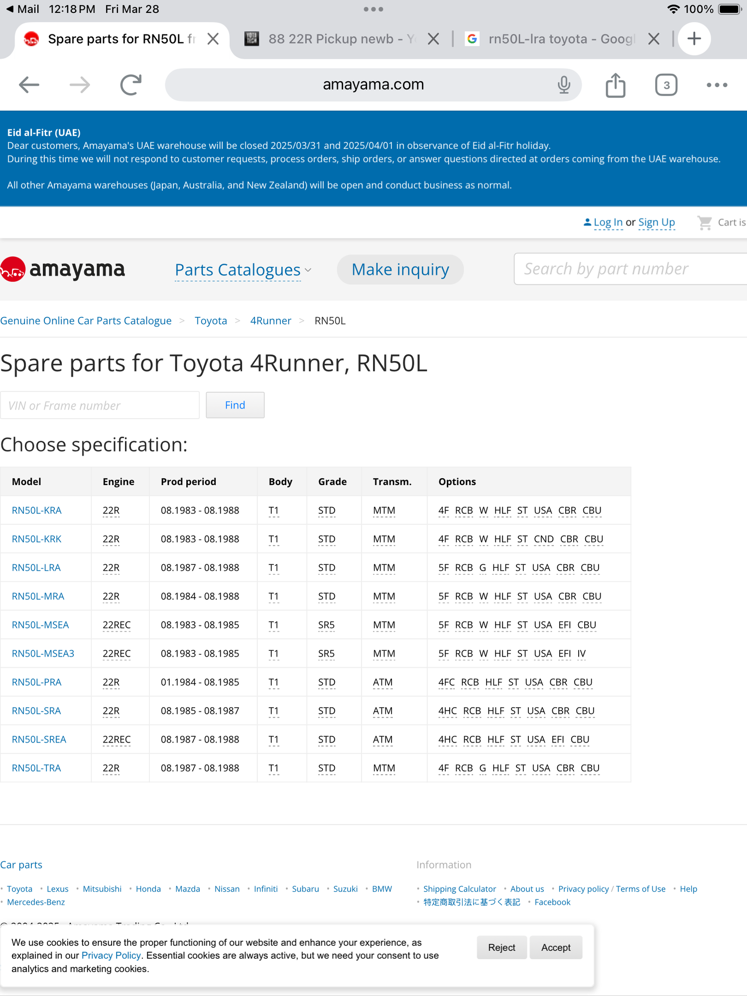

Hey @Jimkola here is a pic of that model number RN50L-LRA…wondering what you can (or where I can) decipher from this ?
Old Mar 28, 2025 | 11:21 AM
Jimkola's Avatar
YT Community Team
5 Year Member
Joined: Jan 2020
Posts: 2,253
Likes: 1,003
RN=22R truck(hilux)
5=2wd
0=short bed
L=left hand drive
L=no idea
R=STD
A=built for USA market.
oddly, it’s listed as having been built 100% in Japan(cbu) but it has a USA built bed. Maybe not original? You’ll notice in the image below the one SR5 is listed as having been “IV” incomplete vehicle, meaning it got shipped to USA without a bed.
