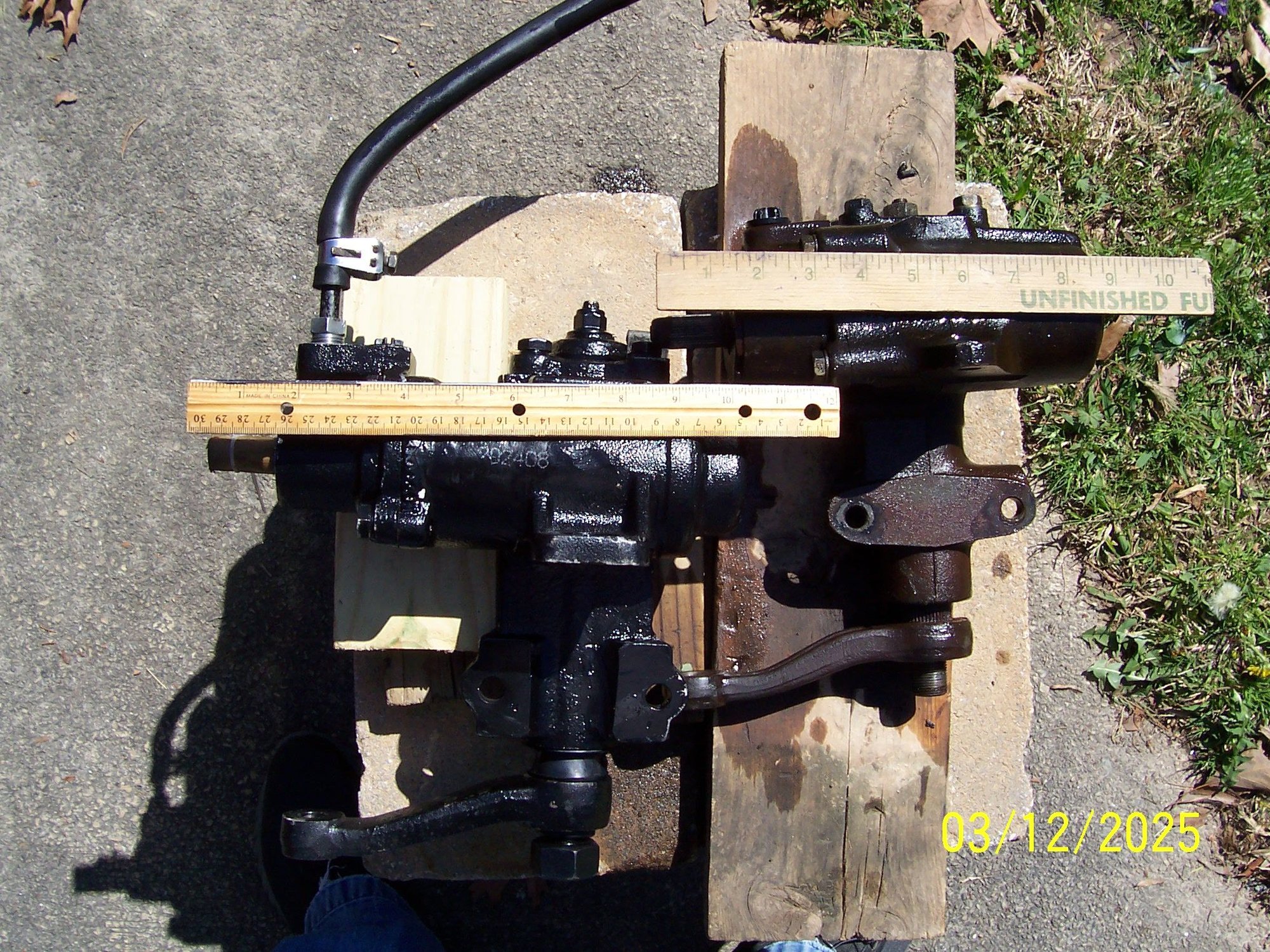

This feels like I going down the steering box rabbit hole. I am wondering if I could use the new box with a different (shorter) steering shaft I found some information, on the other forum, indicating the next generation is using a longer snout A photo with an example of two boxes with the same bolt pattern and different snout lengths is shown (It isn't my bolt pattern). Could I find a steering shaft from a next generation salvage truck/4runner that would bolt up and be shorter in length? I tried to post a link to the relevant thread I could not. A link is embedded in a thread on this forum. In general the boxes with longer snouts could be superior in durability, In other words Toyota may have upgraded the steering boxes on the next generation. Since I am not the only member who has run in to difficulties finding a new replacement box that fits, some out of the box thinking may be worth considering.
One inch difference in snout length?

Here's some good info from Pirate4x4. IDK if this applies to 2WD steering boxes though. The pics you posted look like 4WD boxes. http://www.pirate4x4.com/forum/showthread.php?t=587515

A part number is being used by different vendors for two versions of the gear box. Cardone has an oem remanufactured unit listed as 27-8470. This unit appears identical to my old box as does the GM reman unit. The new casting with the longer snout is also listed with the same part number. I measured the travel on my steering shaft and it is 1 and 1/4 inches. As is it stands, the longer snout appears to be a no go on my truck However, I can not rule out the possibility that other 1986 Toyota rwd pickups have shafts with more travel that could accommodate a 1 and 3/4 inch longer shaft
