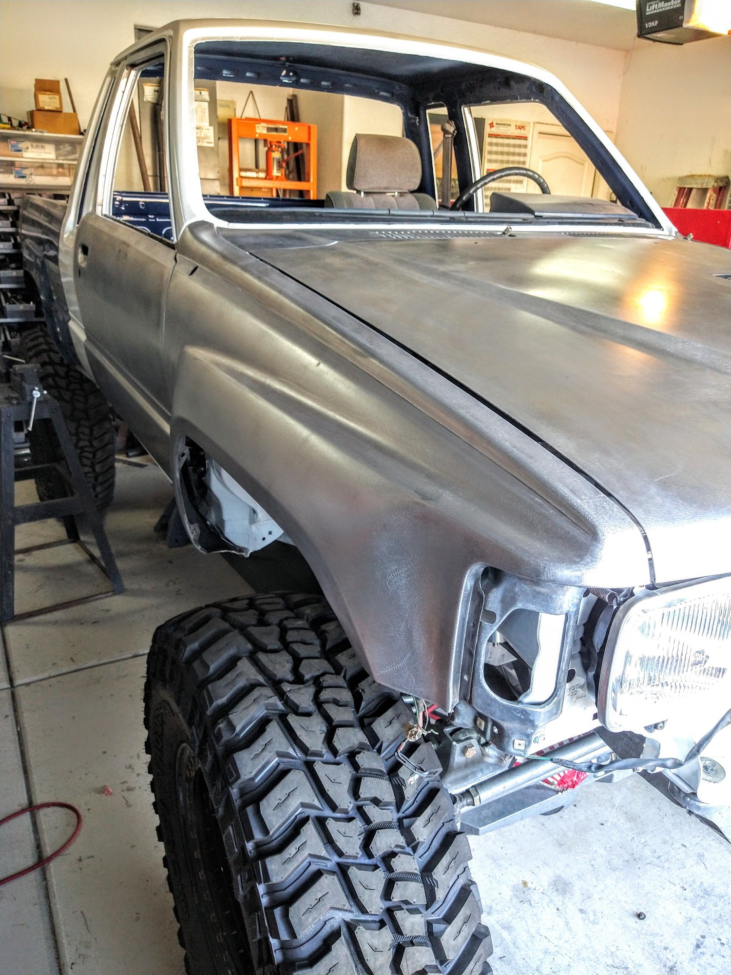

I just like to be able to do my own work and I like the look of the gasket better than the large gap left around the glued in windshield. Debris gets collected behind the trim over time and often rusts out the frame, even here in dry AZ. I completely stripped my cab and the window frame had some pretty bad areas of pitting. None of it rusted through fortunately. I used epoxy to fill the few pits I had.
The trim is crazy expensive. I have several straight sets but the rubber edges are dried out and turned to dust. The installers often just stick it down with the urethane. My current build has no glass installed yet and I will most likely try doing this when I get to the glass install. It's a crawler and not an original "restoration" so not too concerned with being original.
