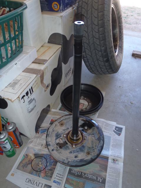

Sorry if I was not clear - I was considering leaving the differential carrier in place along with the leaf springs an shocks. I was trying to determine if I could pull the brake drum / hub and axle shaft out in one piece by removing the 4 bolts behind the drum dust shield (as if I was going to replace the bearings).
Like the picture attached but with the drum still attached and the parking brake and brake lines disconnected. From the thread I got this pic from the person mentioned gear oil with the differential carrier. I guess I should read up on that as well.

Yes, take brake lines off, 4 bolts the backing plate and away you go, you can leave your tires on if you want to. Put some rubber tips on your brake lines so they don't leak all your fluid out.
