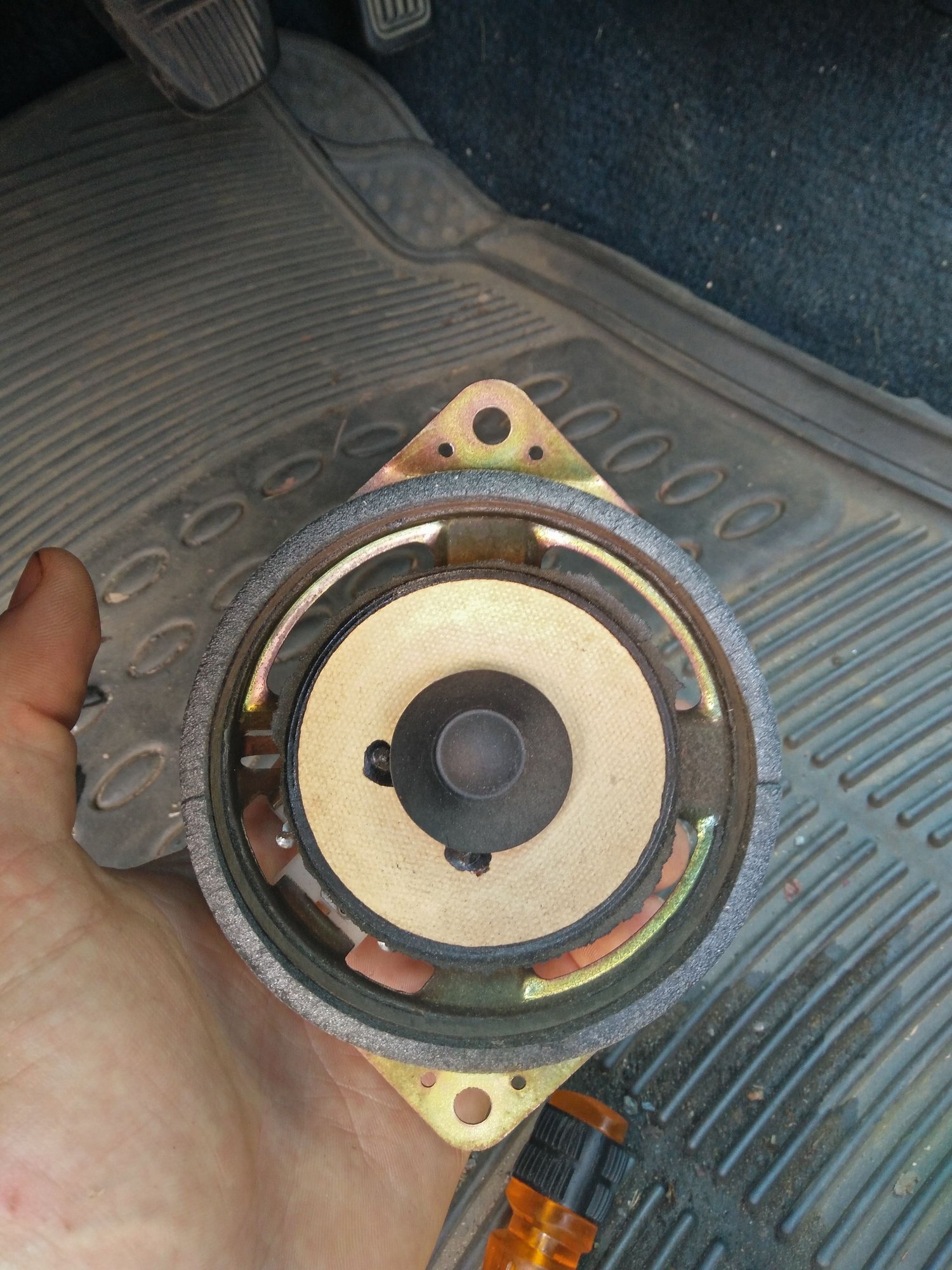

Hmm, we might have different setups, I'll take some pictures.
I'm not so convinced it's a matter of "slight" modification.

The dash looks a little different but they mount the same way in my 92 with 2 screws opposite of each other. My problem was the oval shaped mounts on the speakers were hitting the plastic of the dash not letting the speakers sit flush so i just took my dremel and cut them off. And the mounting holes were off just a little so I drilled them out on the speaker slightly and they went in nice and snug.

I had the same problem, however, the speaker wasn't even close to seating. The closest I could get me was maybe 3 inches.

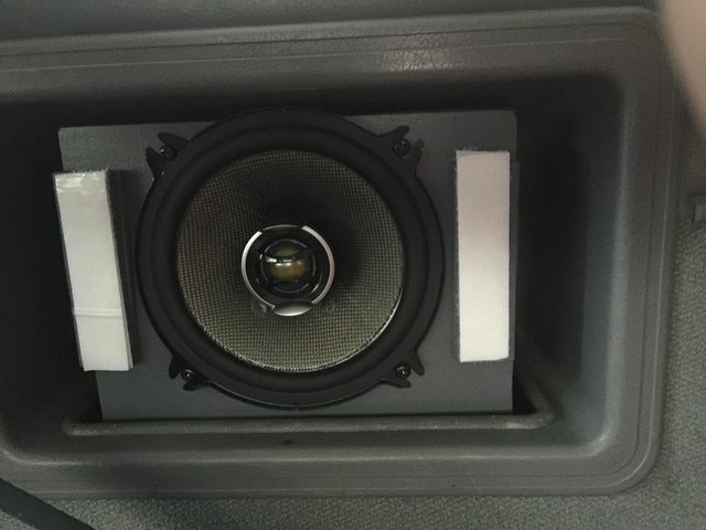

I have these speakers in my truck (with stock head unit) and really like them. I do not turn the sound up very often but they have a much wider range of frequencies than the stock speaker. Not a lot of bass but a 4" speaker can only do so much. These speakers have the right balance of sound for me.
They are a tight fit but they DO fit without any modification to the dash. All I had to do is bend one of the "ears" on the speaker to mach the angled speaker mount. Then I cut off the two unused "ears" so the speaker fits better.
I didn't even cut the tabs off. They just fit.
Like the guy above you, I've got the foam baffles behind them, too.
I put the 5 1/4" in the rear seat pockets. Much better.
