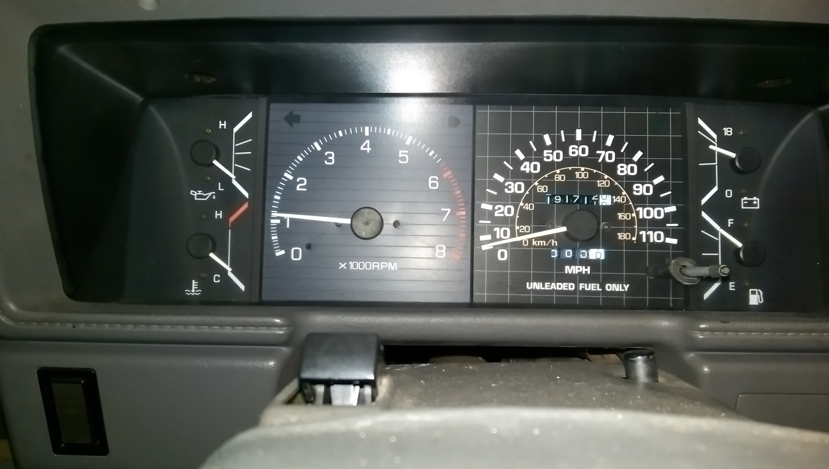

Replaced the old cluster with an SR5 cluster.
Took all of 30 minutes from start to finish!

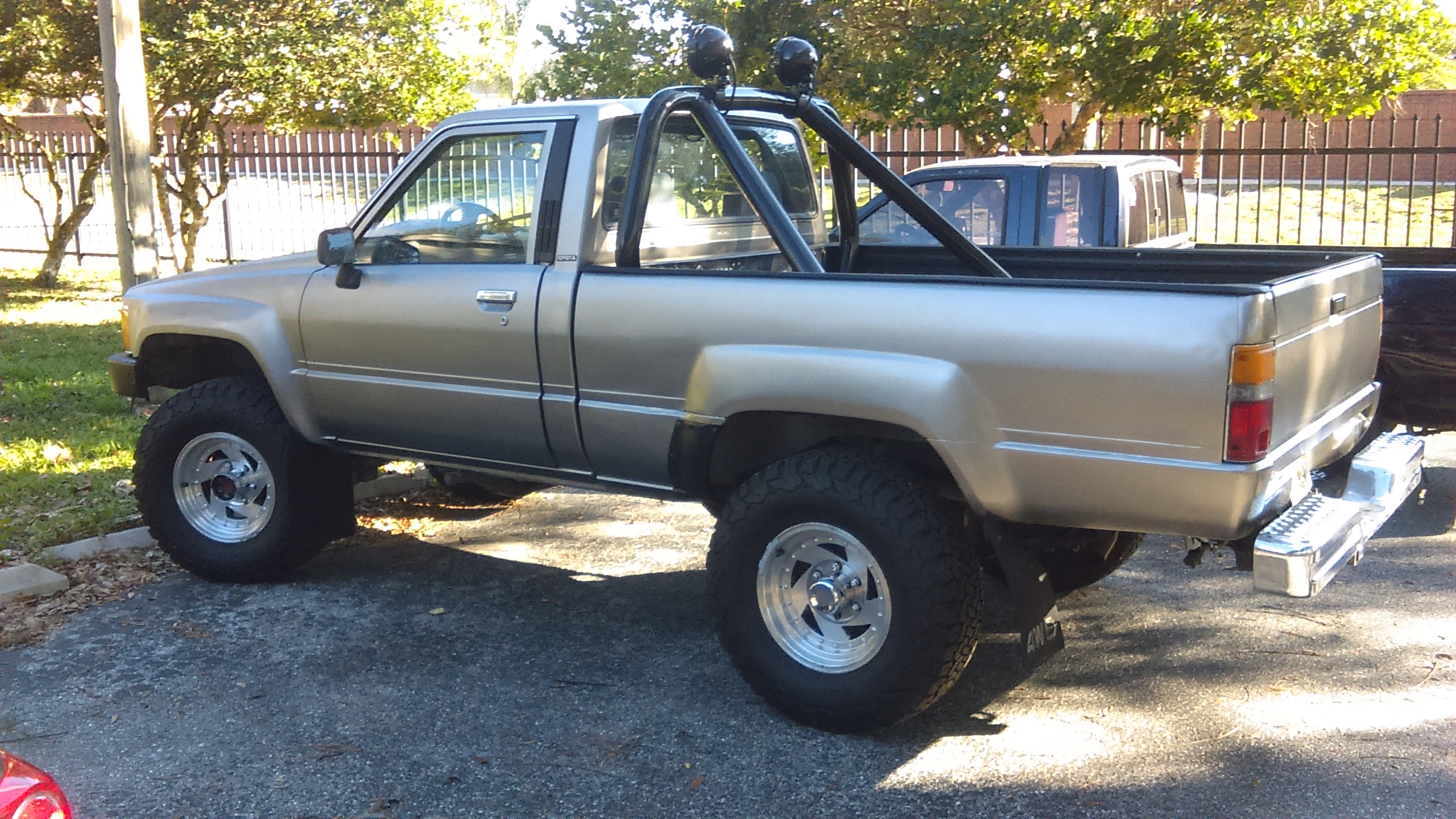

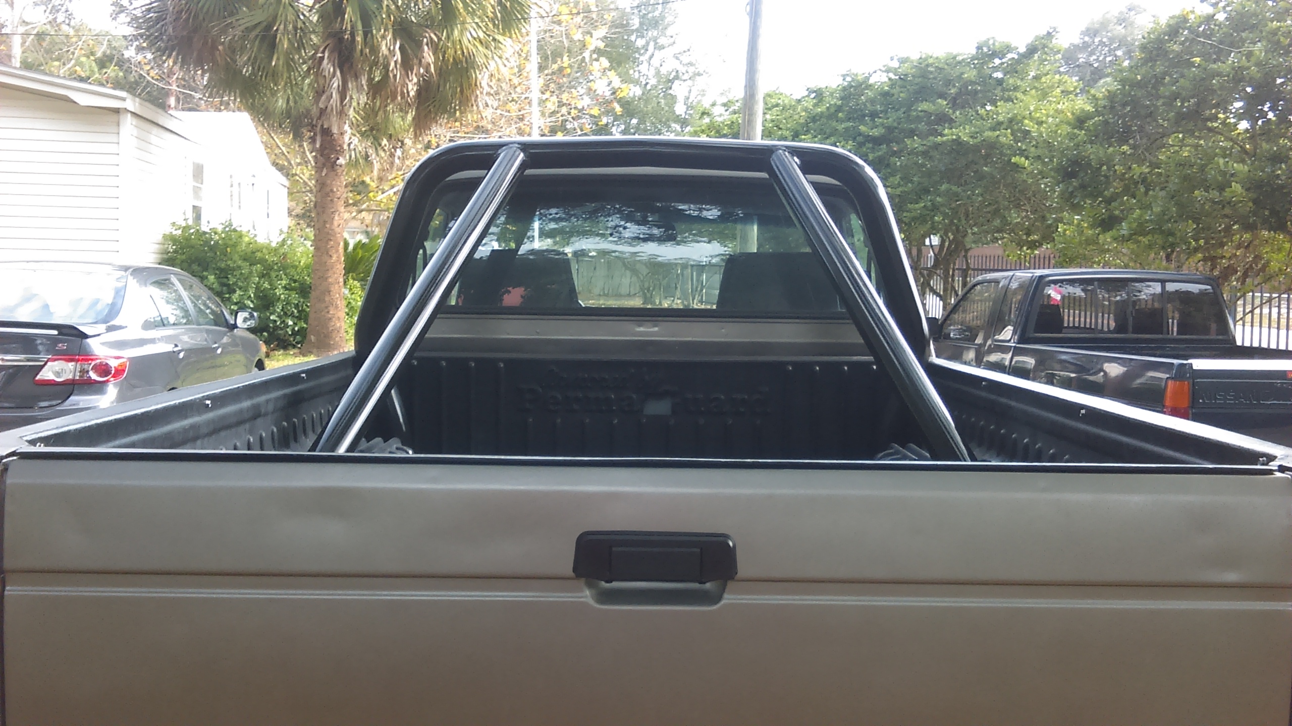

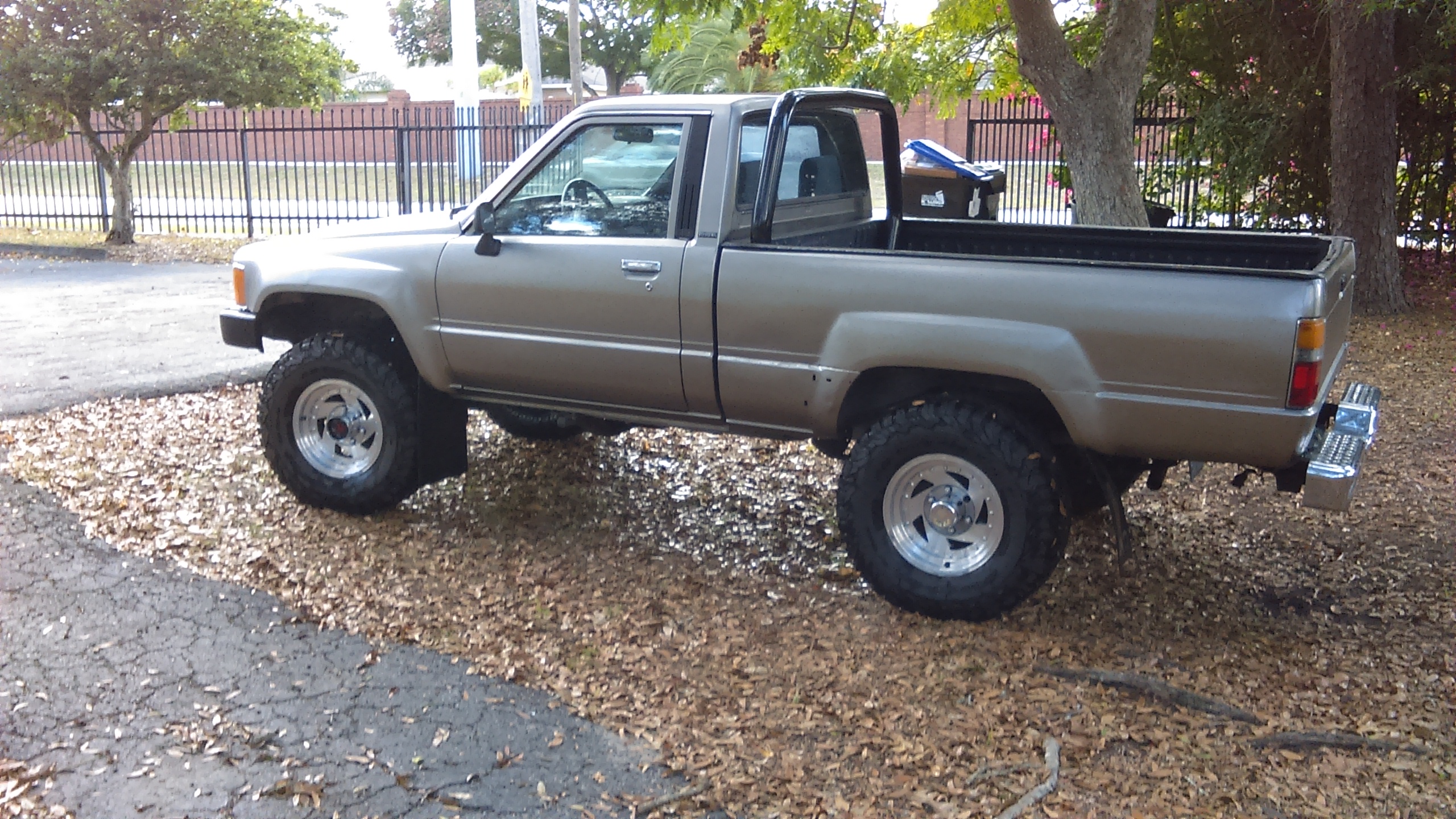

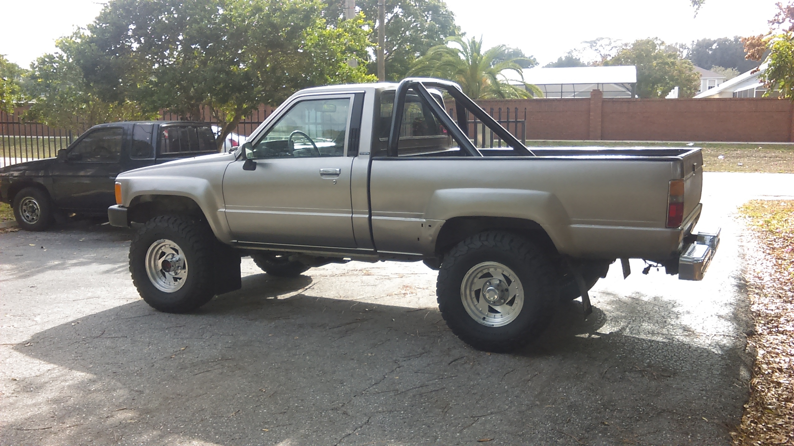

Started on a roll bar 12/24.
Gonna try and add the two back bars today.

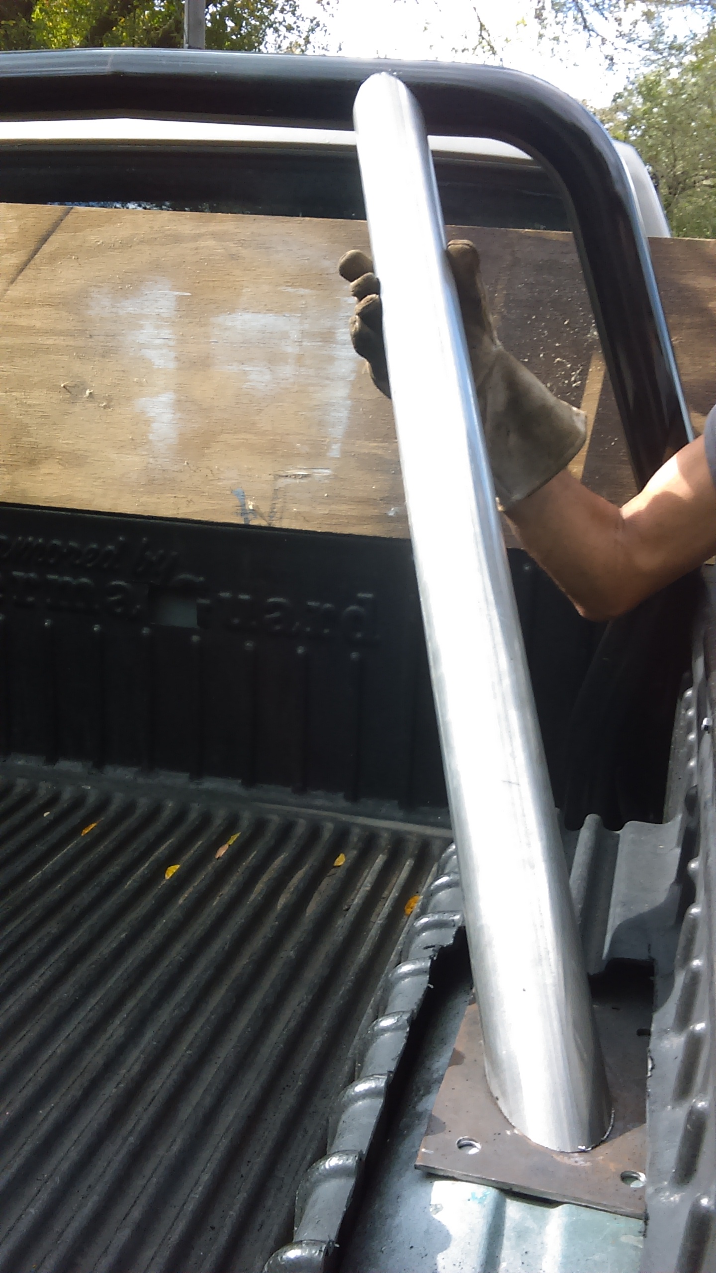

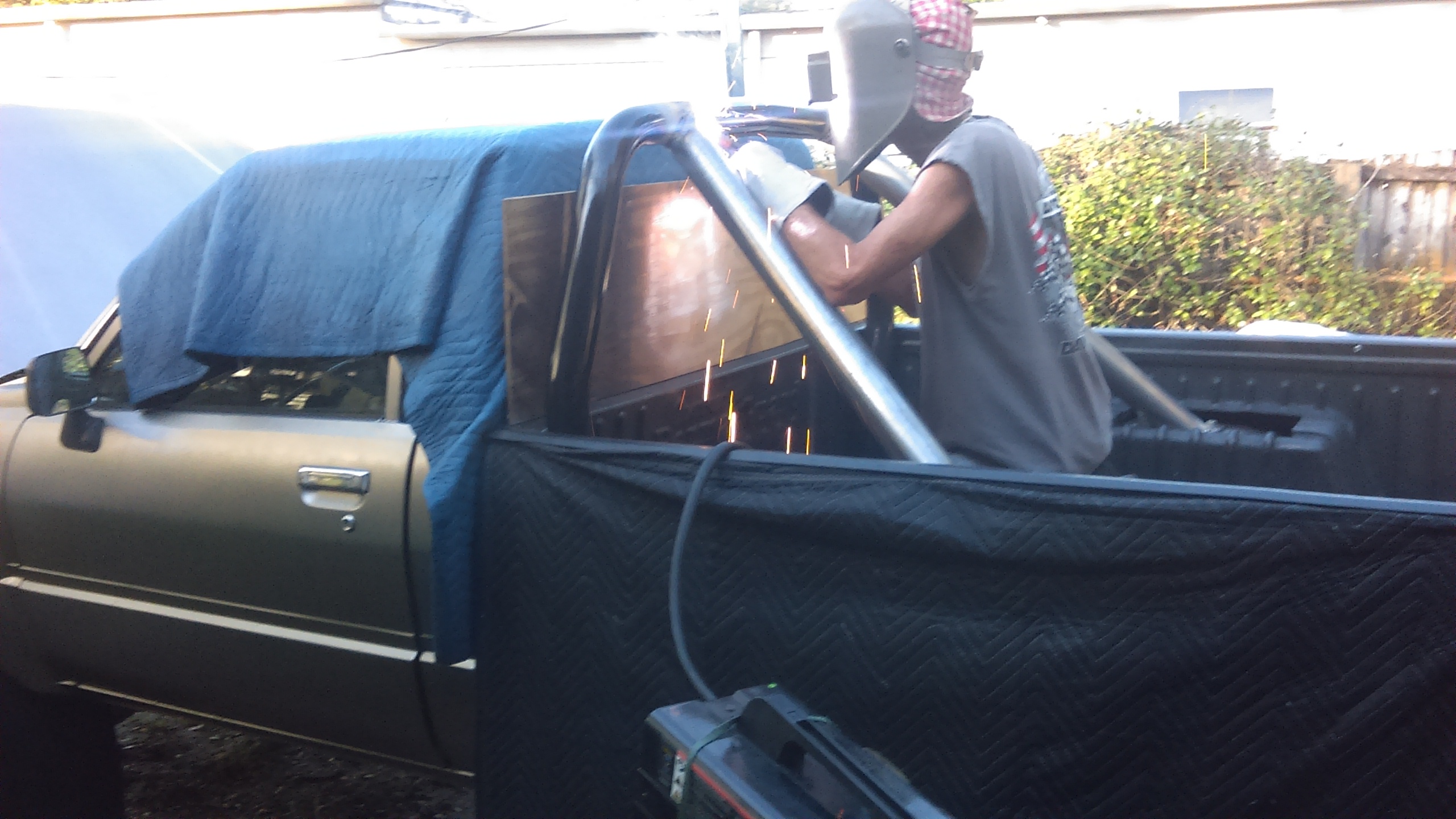

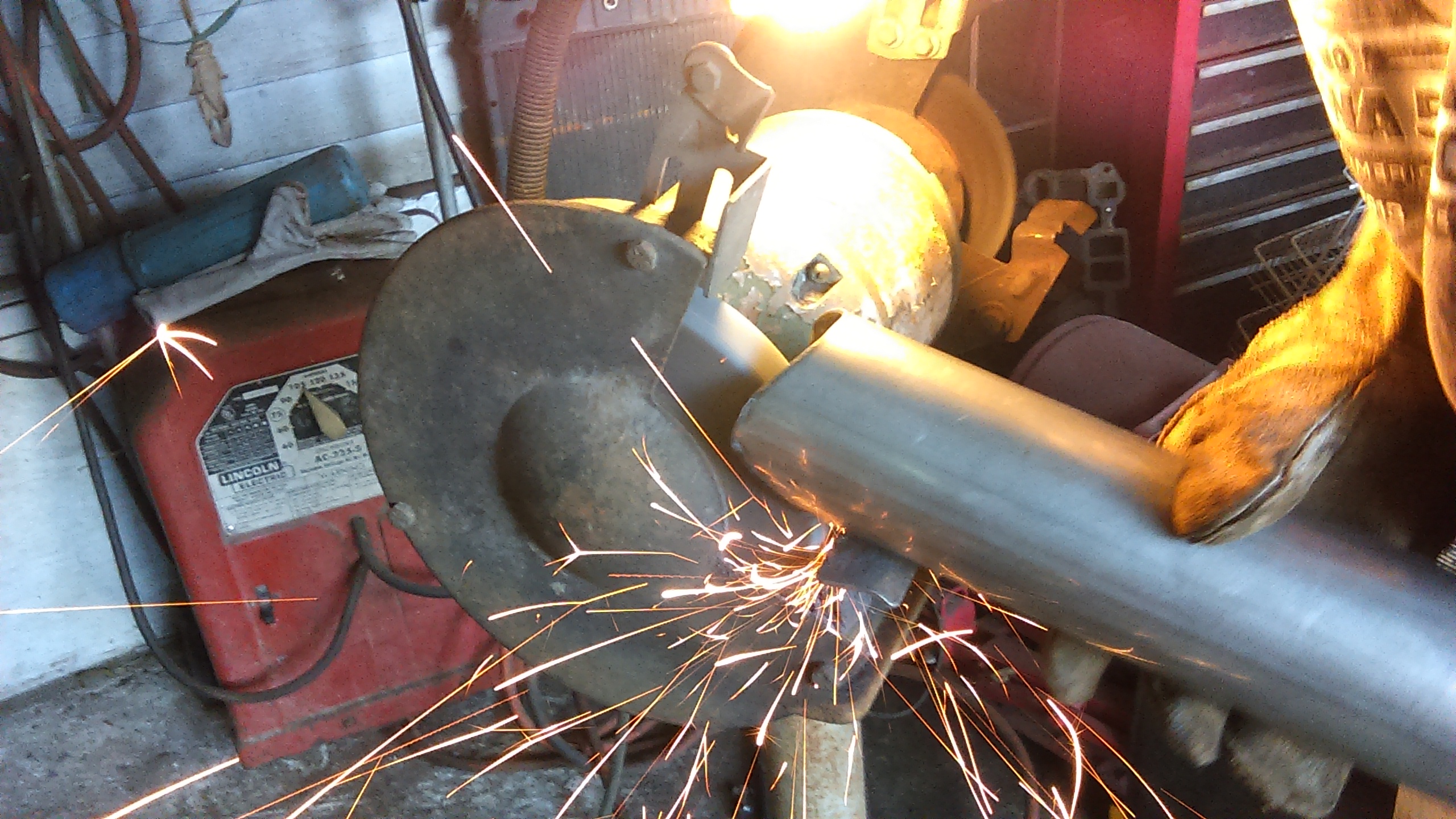

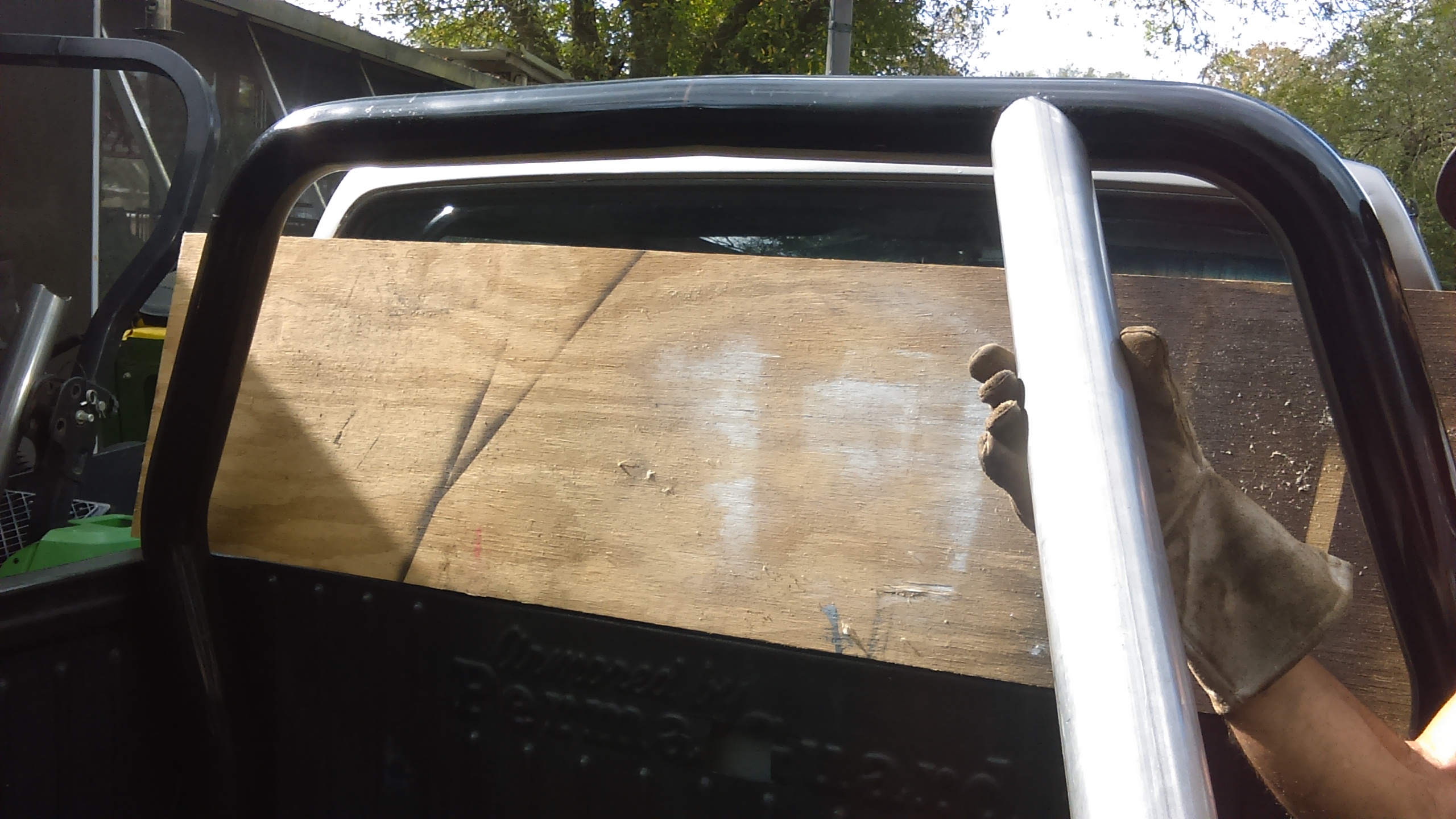

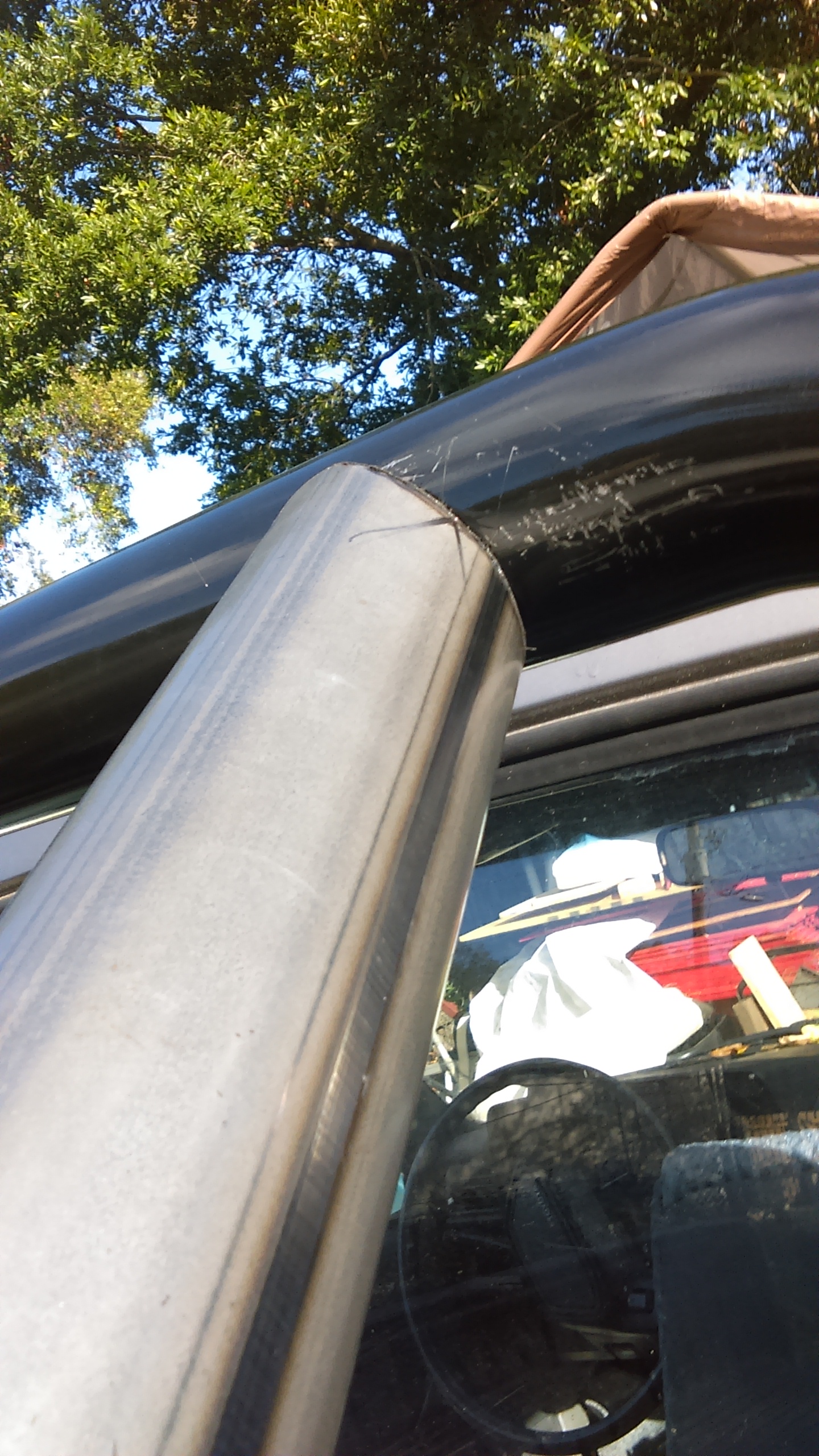

A few pic of building the roll bar.
I wanted to keep the bed liner so I cut it to fit.
My wife came up with a good idea of using fiberglass cloth to make form fitting boots reseal the liner.
Attached Thumbnails 87 4x4 pickup-001.jpg   87 4x4 pickup-002.jpg   87 4x4 pickup-003.jpg   87 4x4 pickup-004.jpg   87 4x4 pickup-005.jpg

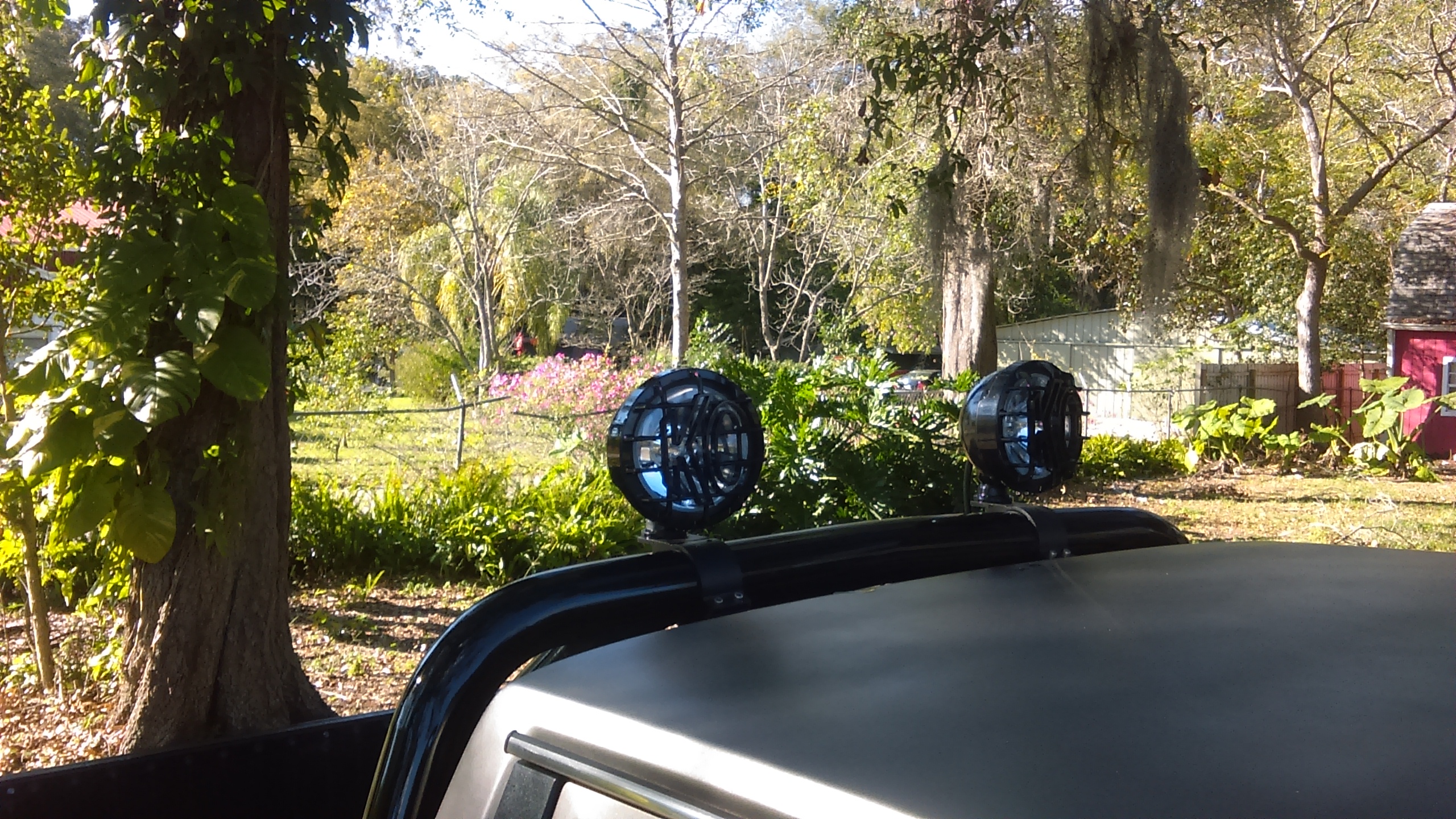

Well I have added (2) 6" lights and scored a set of chip guards from Jrheingans.
Attached Thumbnails 87 4x4 pickup-imag0405.jpg   87 4x4 pickup-imag0401.jpg   87 4x4 pickup-imag0406.jpg

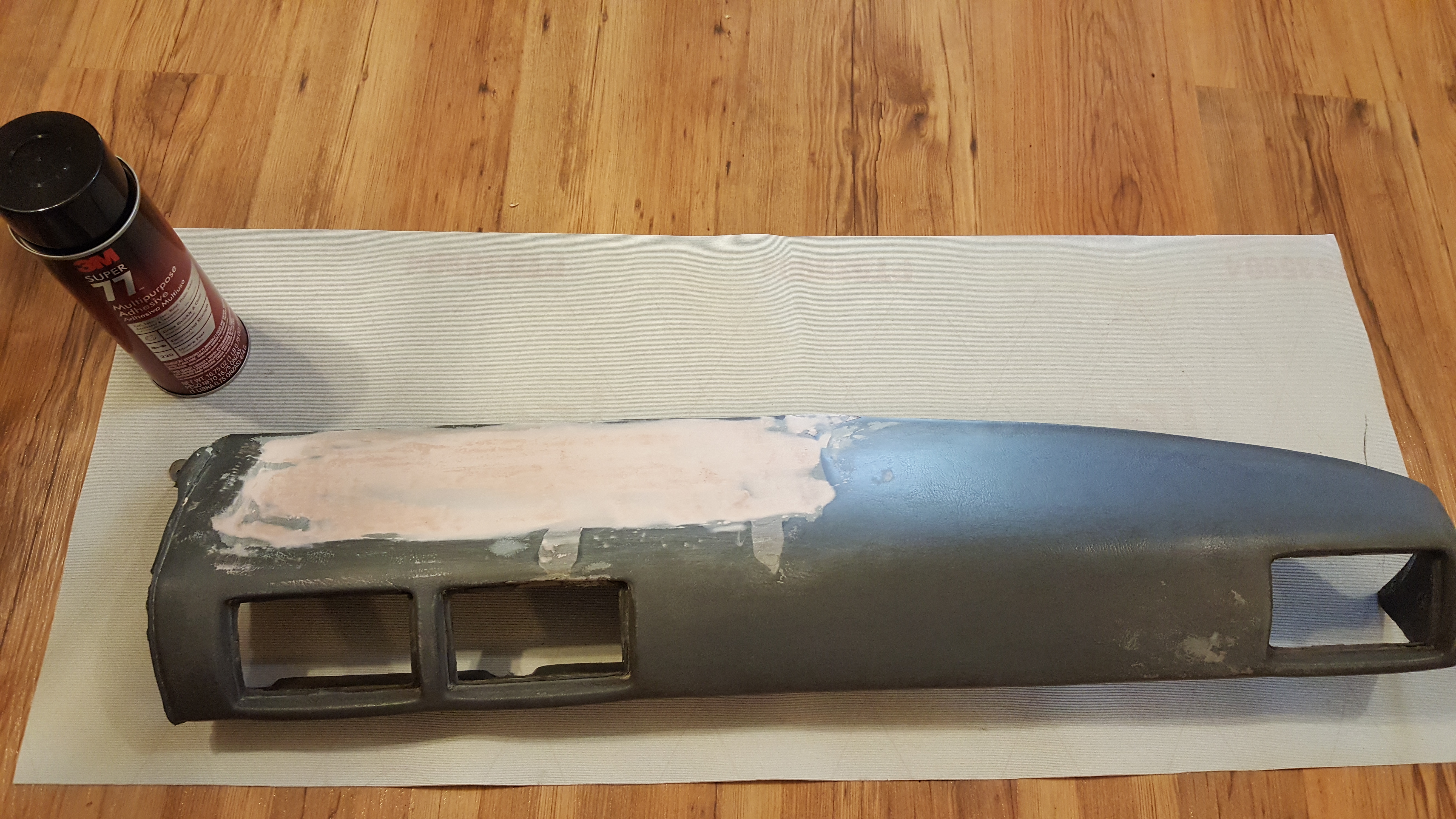

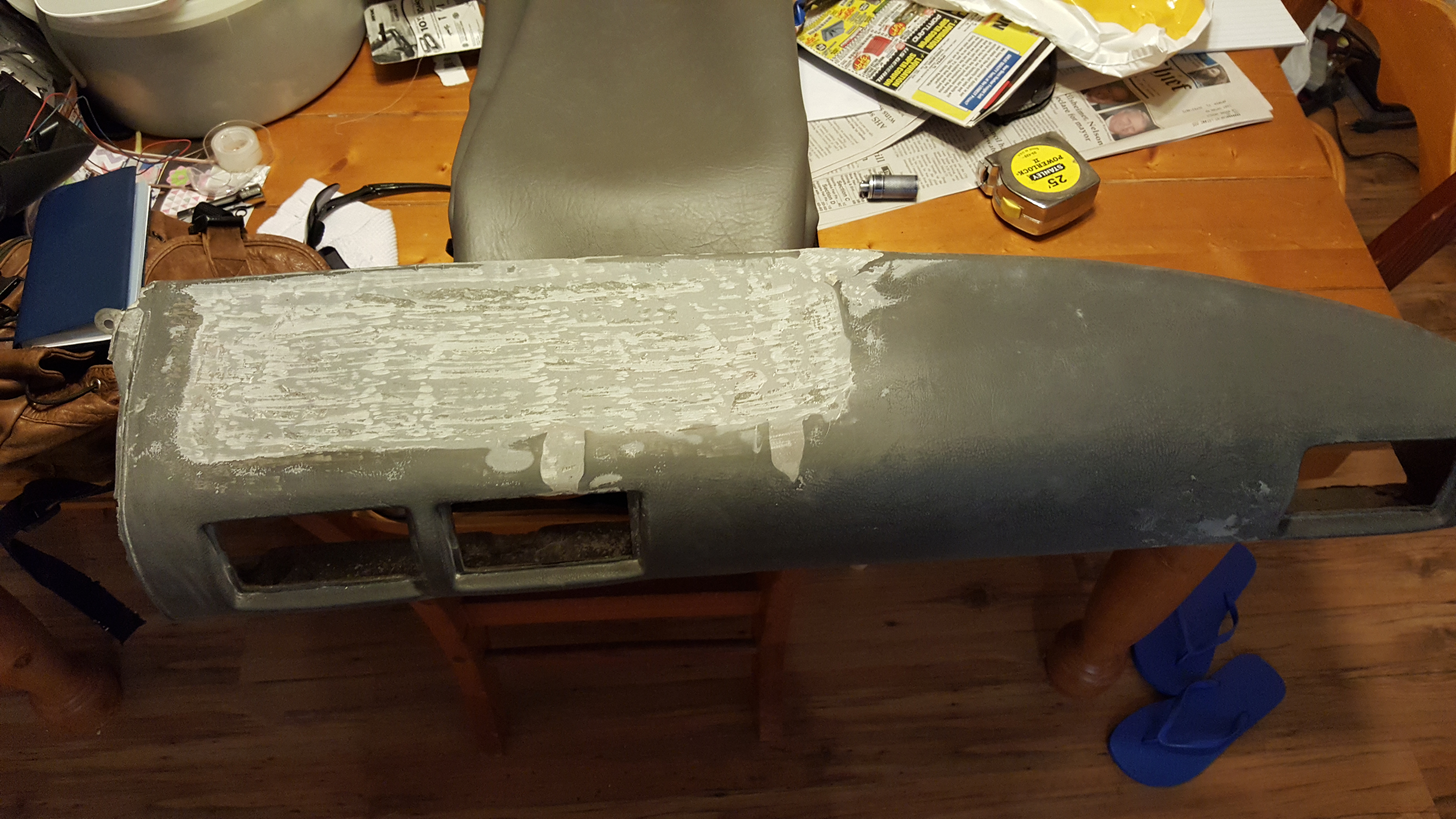

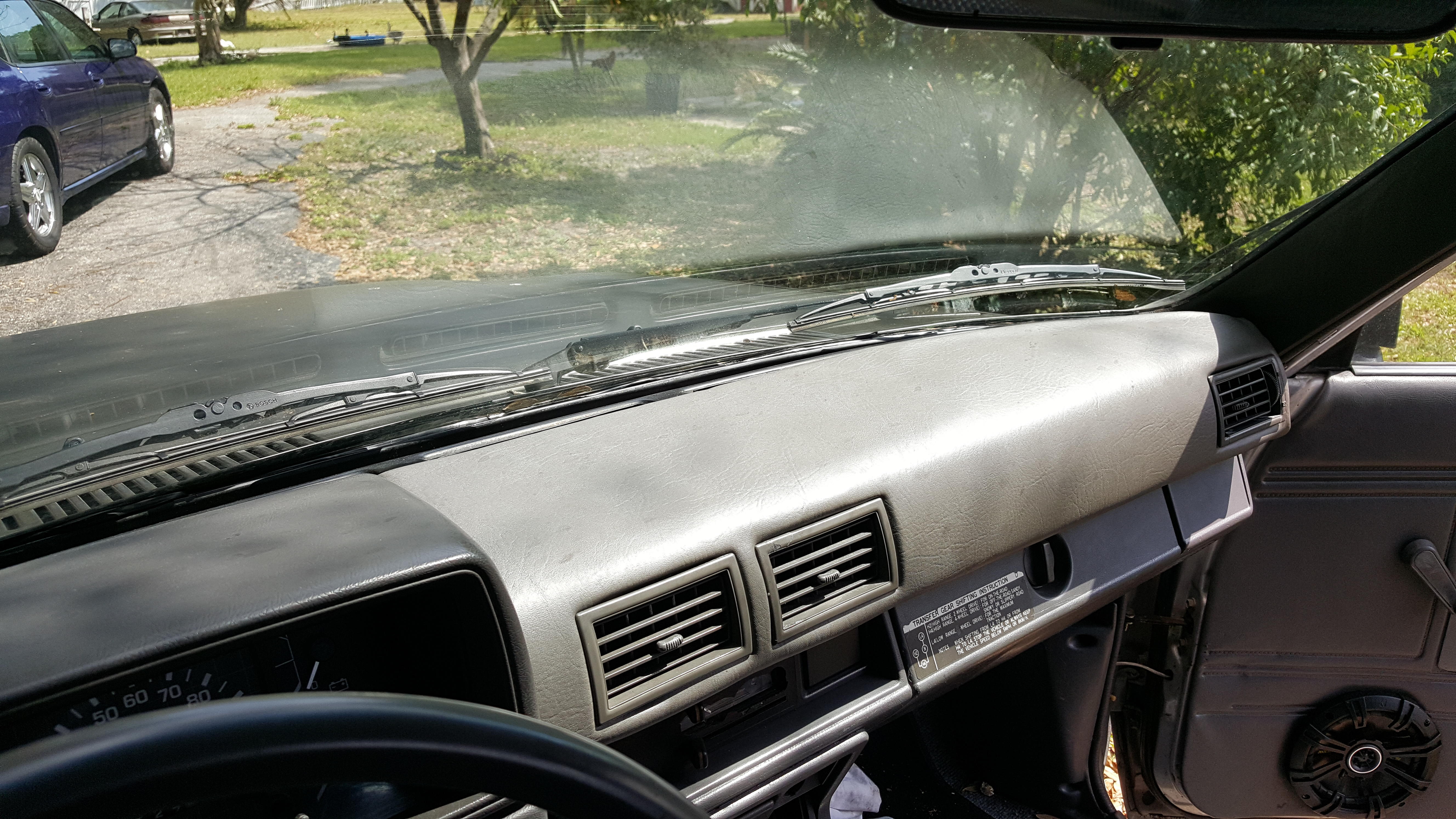

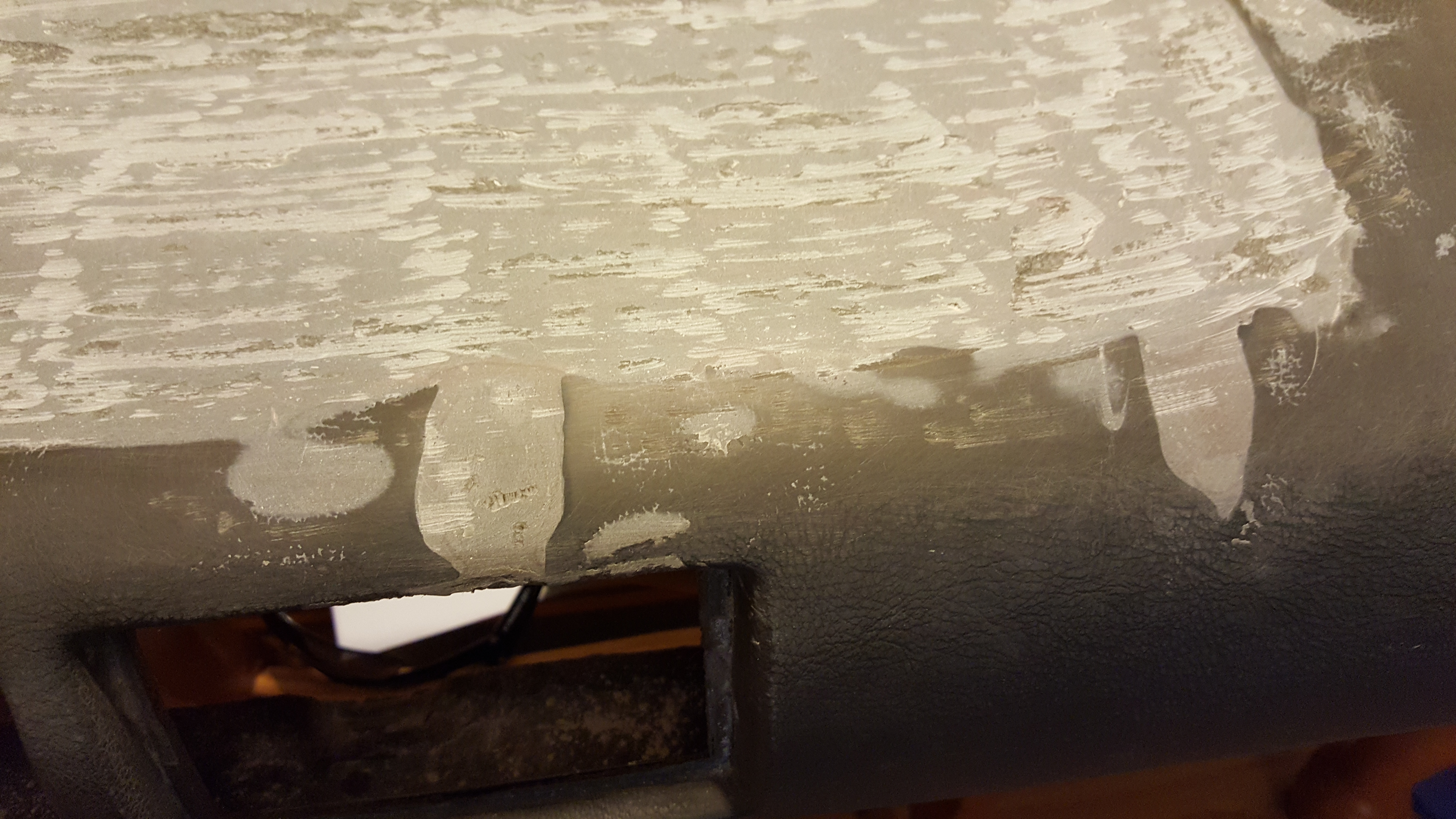

My attempt at repairing my dash. I didnt remember to take any pictures of the damage(my bad).
Started off by filling in the pocket.I never used it in 30 years and I'm thinking of installing a gauge pod for a set mechanical gauges.
I used fiberglass and bondo in lifts to fill in the cracks and pocket.
Final skim coat was just bondo. Everything bonded like a rock.
Attached Thumbnails 87 4x4 pickup-03.jpg   87 4x4 pickup-01.jpg   87 4x4 pickup-04.jpg

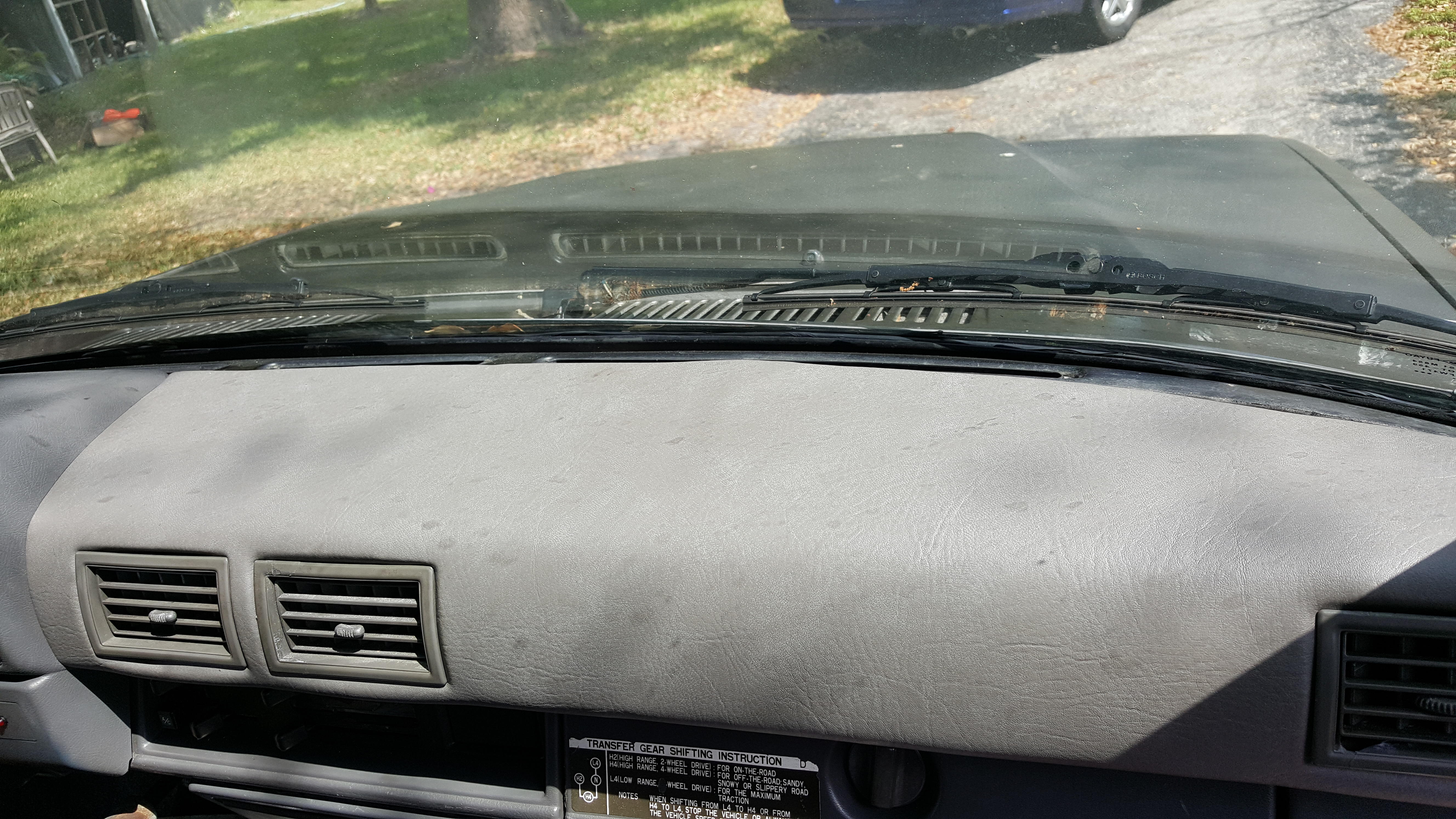

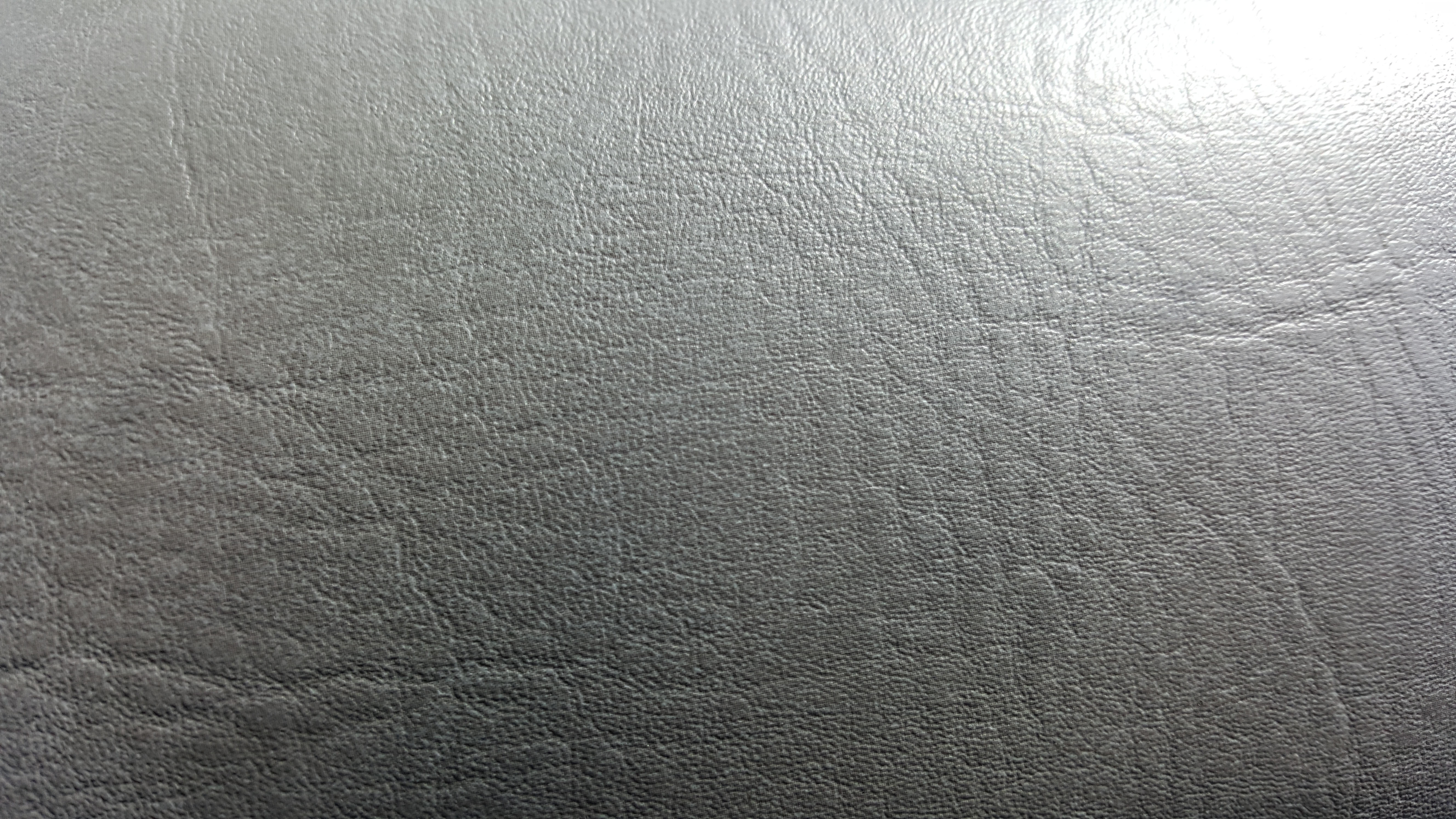

With my wife's help we found Marine vinyl at Joann's fabrics for $19 per yard.(wife had a 50% off coupon) It measured 36"x52" for $8.50
I used 3m 77 spray glue. Total cost for all the material was $40 out the door.
Attached Thumbnails 87 4x4 pickup-07.jpg   87 4x4 pickup-05.jpg   87 4x4 pickup-06.jpg

Nice! Exactly how I plan to fix mine. I never use the pocket either since the 80's when I watched a nice fountain pen slide off and fly out the window at a turn. LoL!
Wasn't it hard to make the vents fit? No wrinkles there?
Old Apr 3, 2017 | 10:19 AM
  #35
TrafficTechII's Avatar
Joined: Oct 2010
Posts: 148
Likes: 16
From: Florida
Thanks.
With the vents I had to take the locking tabs off. I cut an "X" in the opening and folded the material in. I simply pushed the vents in the opening. Its a very snug fit.
I ended up cracking a couple of the vents, 30 year old plastic. After I install the gauges I plan to look for a fix for the tabs.

BTW, did you also use plain bondo to fill the pocket?
Old Apr 4, 2017 | 05:04 AM
  #38
Joined: Oct 2010
Posts: 148
Likes: 16
From: Florida
I used the long hair fiberglass bondo mix and a skim coat of plain bondo to finish it off smooth.
