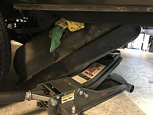

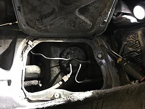

Update: here is the proper sequence to get to the fuel sending unit on an ‘87:
1) Disconnect negative terminal on battery
2) Lift access hatch under rear passenger seat
3) Disconnext fuel filler and breather hoses and plug them with rags
4) Remove fuel tank skid plate (6 12mm bolts)
5) Drain fuel from tank
6) Remove 6 12mm bolts holding fuel tank up
7) Use floor jack to keep front of tank higher than rear so you can access fuel sender from rear
Pics below

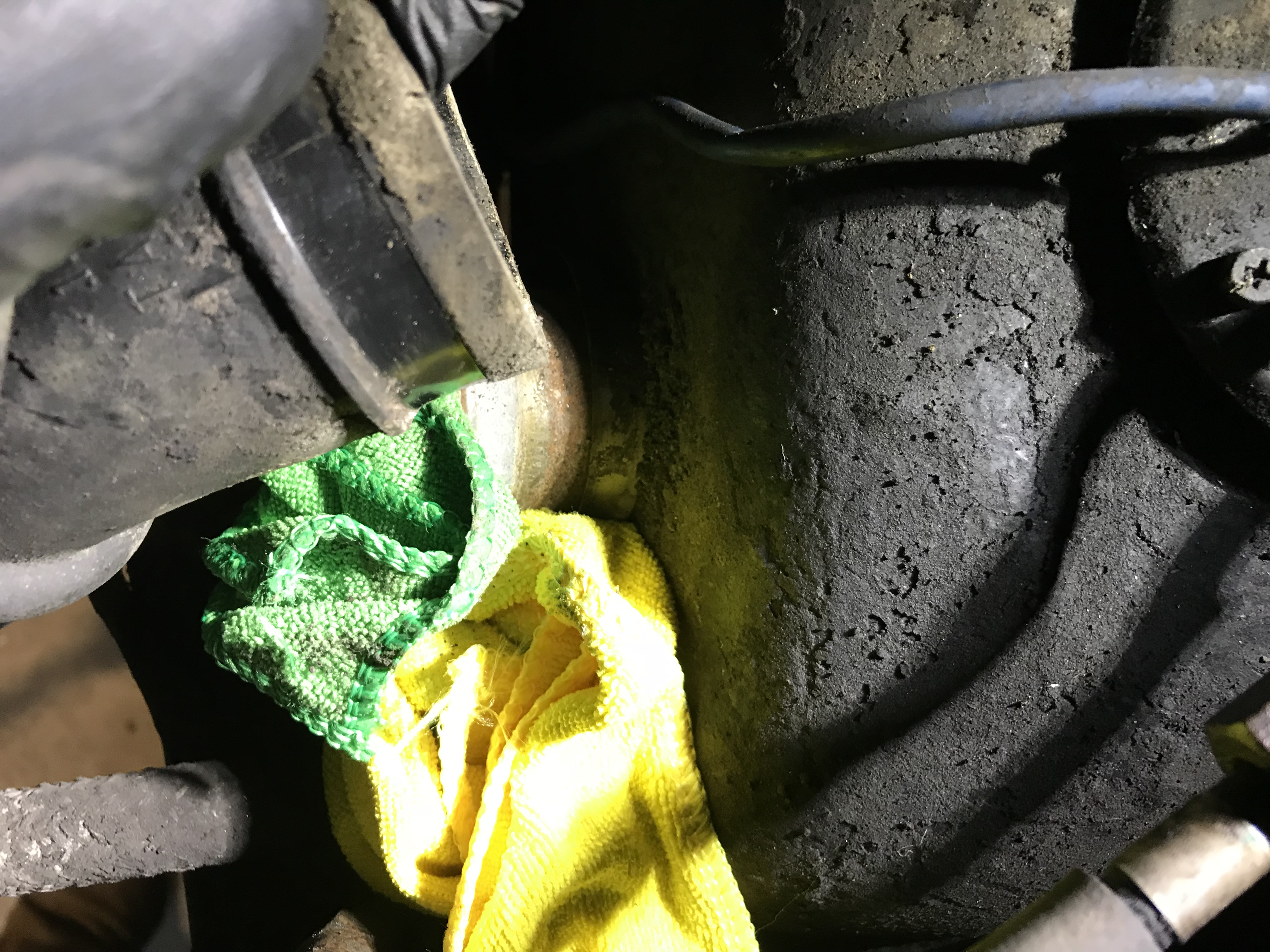

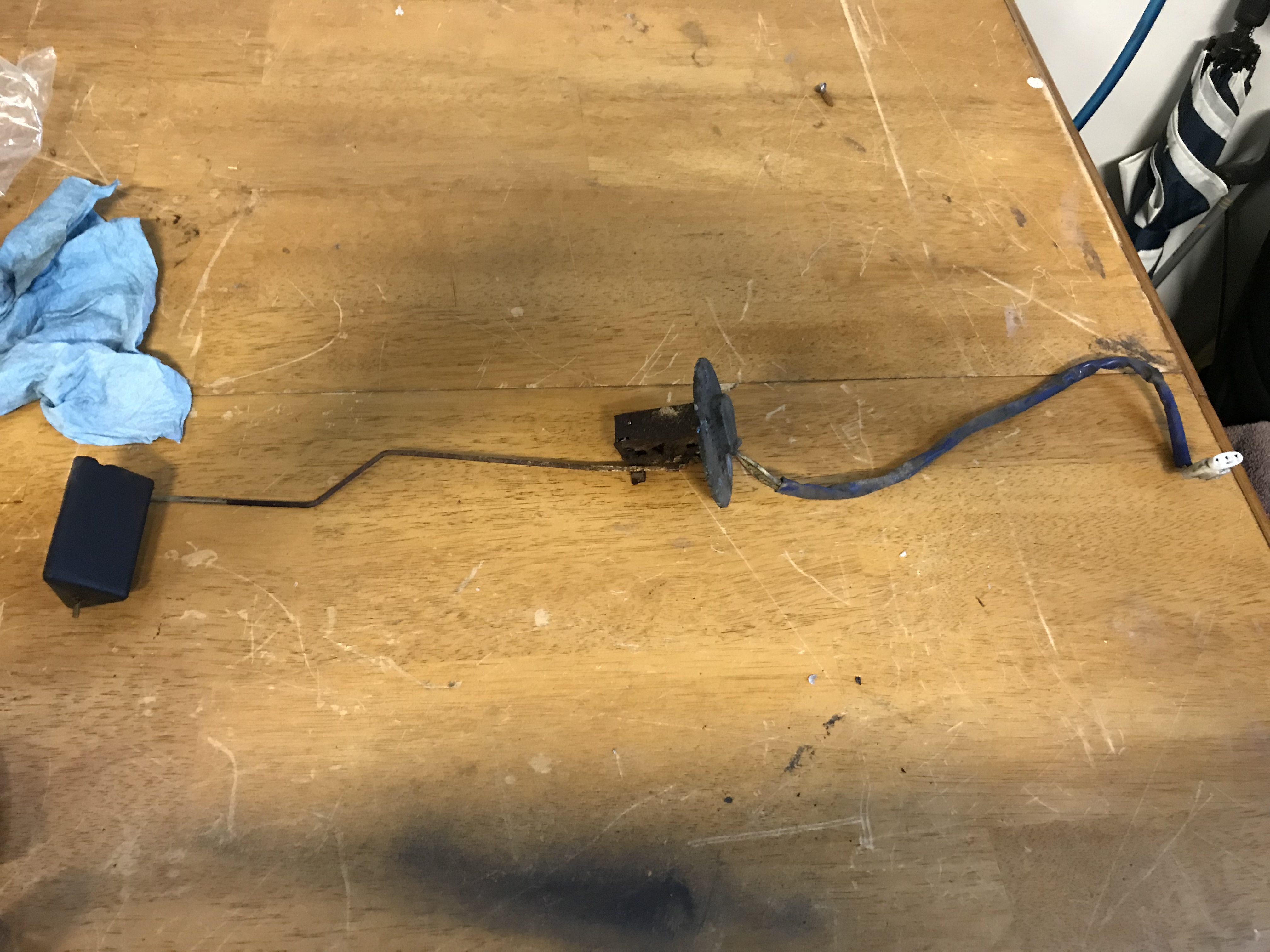

More pics. This is the sender you’re trying to get to - it’s back a little ways behind the fuel pump you can easily access through the hatch. It’s much smaller than I was thinking.
Attached Thumbnails '87 4Runner SR5 22RET WTB Fuel Sending Unit?-40115565-75e5-4e47-aa57-d93b8dfa037e.jpeg   '87 4Runner SR5 22RET WTB Fuel Sending Unit?-b9f20ef4-8c34-4135-ba32-b7e270dd6f82.jpeg

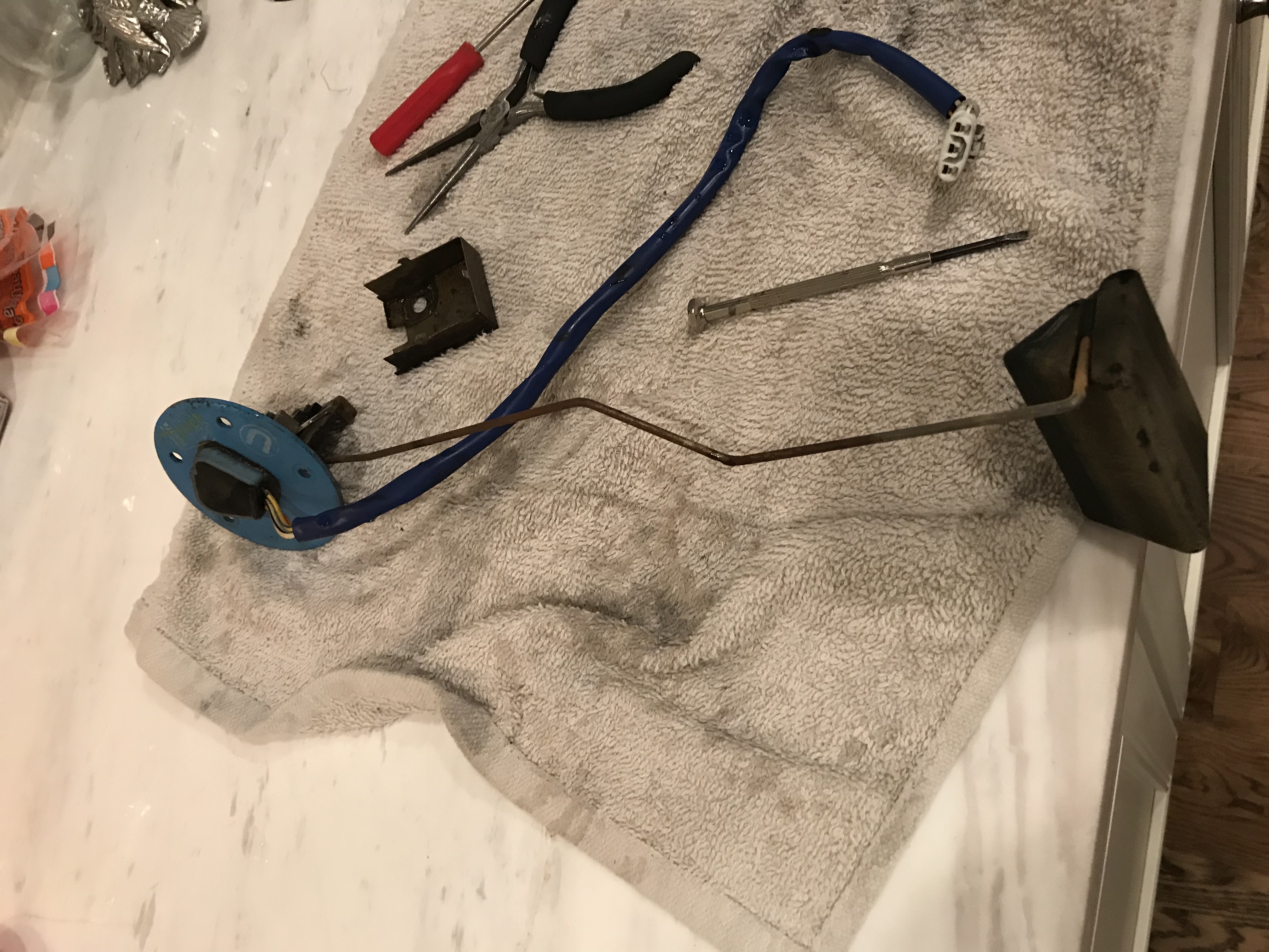

Now here is my problem. From studying the sender, it looks like the internal wiring in the middle is broken and the exterior housing is rusted. While it somewhat works, it’s probabky close to the end of its life.
Since this is a discontinued part, I was trying to fix it but I don’t think it is repairable. I’m not even sure I can open it up without destroying it - seems to be riveted together. Agree?
if not, where can I buy a new one for a Turbo that works with the digital dash?
Attached Thumbnails '87 4Runner SR5 22RET WTB Fuel Sending Unit?-a06e210a-af76-42f3-93a9-d1410e3b3aec.jpeg   '87 4Runner SR5 22RET WTB Fuel Sending Unit?-5d84f25f-12fb-4191-b68f-d837de141929.jpeg   '87 4Runner SR5 22RET WTB Fuel Sending Unit?-e6857743-8566-4be2-88ac-71eaa11495ca.jpeg

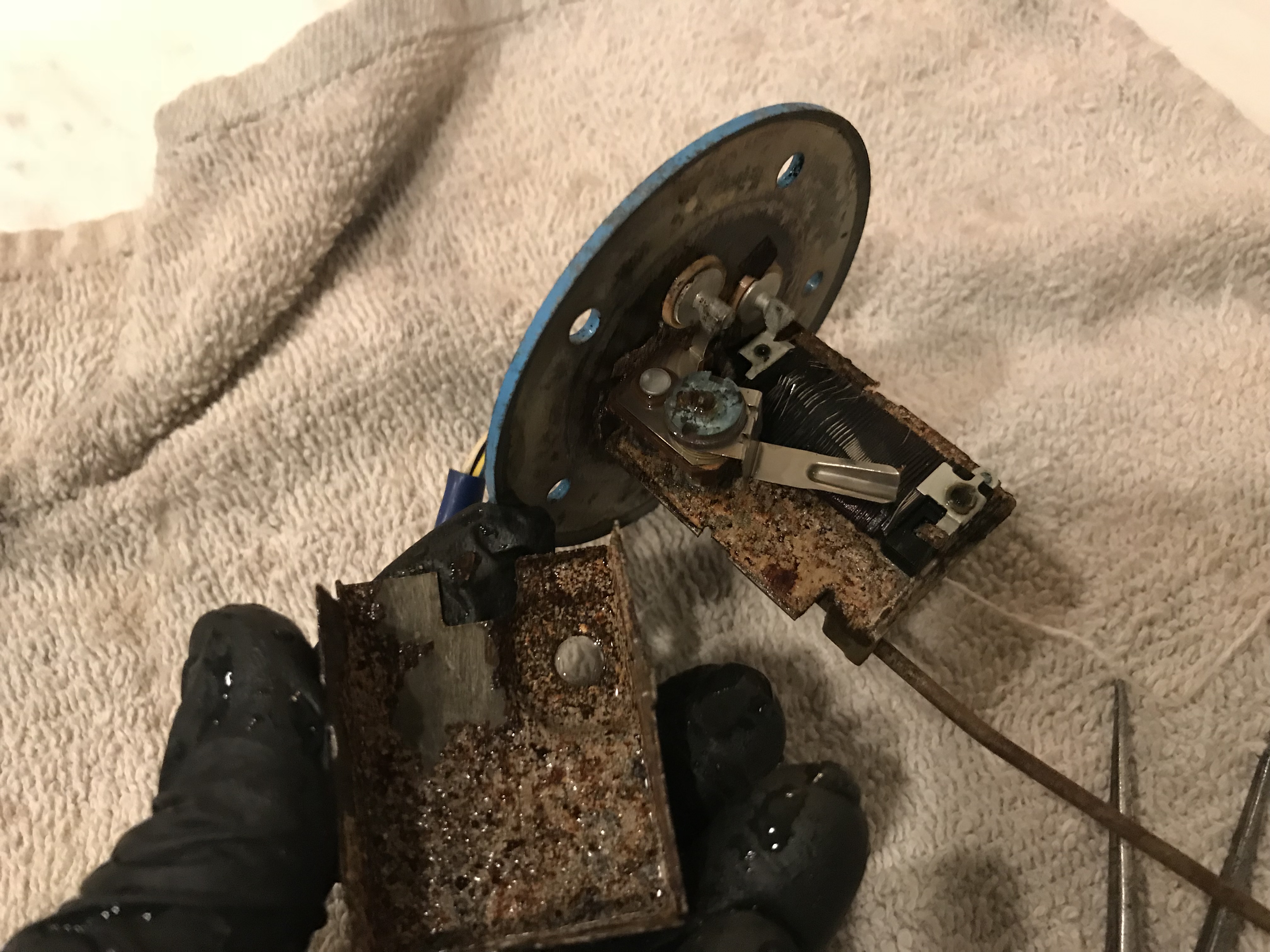

Looks like I can take it apart per this post:
https://www.yotatech.com/forums/f114...repair-252091/
But his internal wiring wasn't broken like mine. Guess I'll pull it apart tonight and see where it goes.

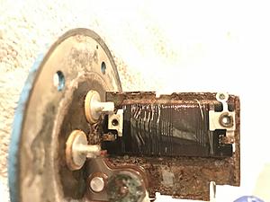

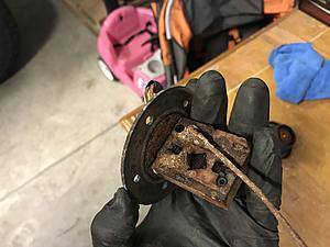

Got it all clean, but there are a lot of broken wires in there. Any ideas on how to fix these? Doubt soldering them is the right fix...
Attached Thumbnails '87 4Runner SR5 22RET WTB Fuel Sending Unit?-b9f7778f-0d90-45da-90e4-bce5daa5d7d5.jpeg   '87 4Runner SR5 22RET WTB Fuel Sending Unit?-e688bf9a-c301-4da0-a11a-89c340f240a6.jpeg   '87 4Runner SR5 22RET WTB Fuel Sending Unit?-e315a43f-b22b-40d3-8541-eeae8ab0c0fa.jpeg   '87 4Runner SR5 22RET WTB Fuel Sending Unit?-6f9105b2-0f85-4bfe-869f-0ed8dbdf6dfb.jpeg

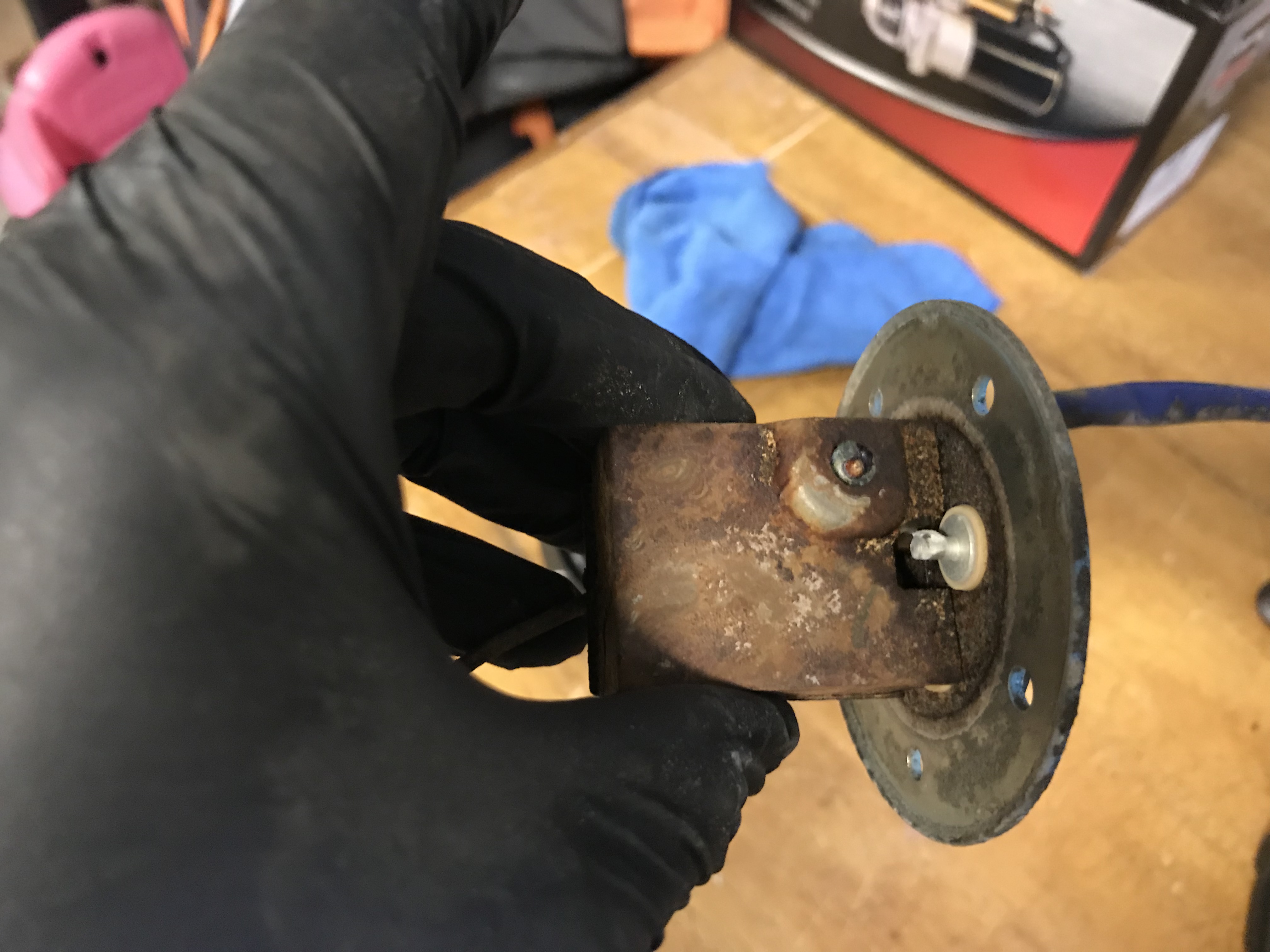

This is the best I could do. After cleaning the lower half really good (getting the Black gunk off so the wires become shiny again), I got resistance up and down although it jumped around some due to the broken wires. It’s reinstalled so we’ll see how well it works.
Attached Thumbnails '87 4Runner SR5 22RET WTB Fuel Sending Unit?-2fa48399-c9aa-40cf-bcd9-fedbb6dd1f94.jpeg
