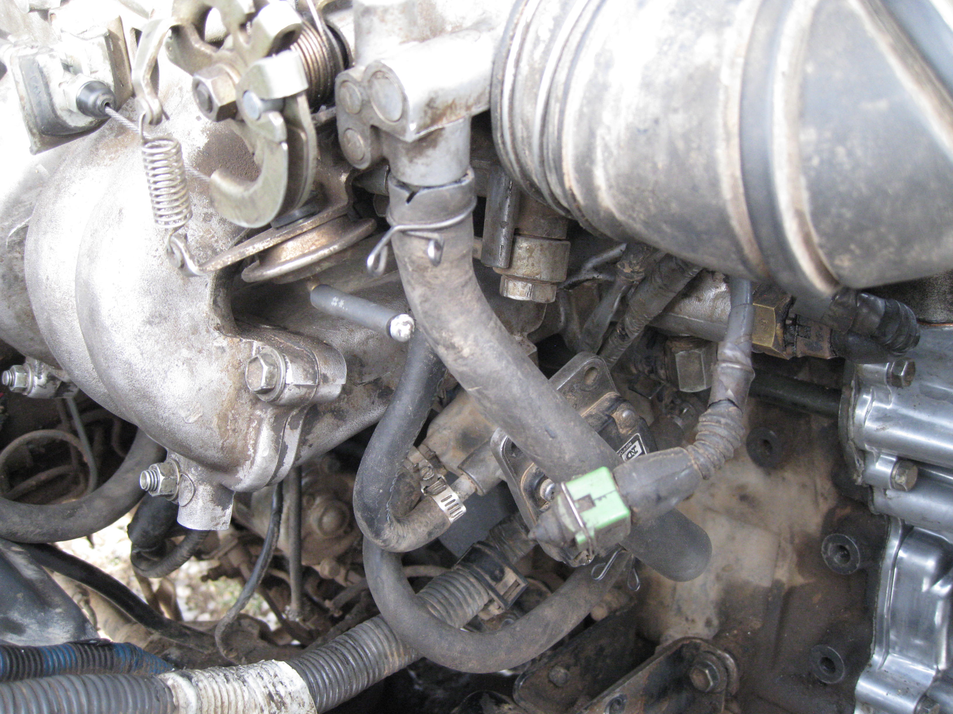

Ok, well in that second pic, the green connector kindof hanging there in front of the IACV is suspect...that probably goes to your coolant temp sensor, but might be just for the gauge. I'd have to go look at mine to be sure. Other than that, I didn't see anything weird in your pics. Another thing to consider is your EGR could be stuck open, giving you some trouble when cold...speaking of which I need to clean mine probably. I assume your valves are adjusted and your timing is set and all that good stuff...is your warm idle properly set to 900 or whatever the recommendation is?

What about the hose connection in 2nd pic that is capped off. I cant seem to find where that should come from or go to. maybe there was some kind of double connector that is missing ???

Ok in thinking more about it, that green connector might be an electrical plug for the IACV, I seem to recall it might be sortof pre-heated when IGN is turned on...even more reason to suspect it now since it kindof looks unplugged to me.
As for that capped hose you are referring to, I believe that is the dashpot, which just slows down the closing of your throttle when you let off of it. I think what is normally there is a little piece of hose with just a filter on the end and it goes nowhere, it does not need vacuum or anything. Many people remove the dashpot because sometime it can get hung up and cause your idle to stick at a higher level than normal because it won't let the throttle level go all the way back. I don't think you want it capped like that, it should be open to vent to the atmosphere.

the vacuum line connector under throttle.
​​​​​​​This model came with air conditioning ...I think that green connector might have been part of it

OK, , yes the green connector is actually "connected" but the wires/wire is missing, broken off

that line goes to a breather for the dashpot (the round "bell" above it) to retard the release of the throttle plate on deceleration. most do not have the breather, but are open ended rather than capped. i'd remove the screw plug, and allow the throttle plate to close without this.
i think the green connector goes to either the start time switch or the ECU temp sensor (i cannot remember which).
edit: your pic shows the brown connector for the start time switch, so the green connector is probably the ECU temp sensor.

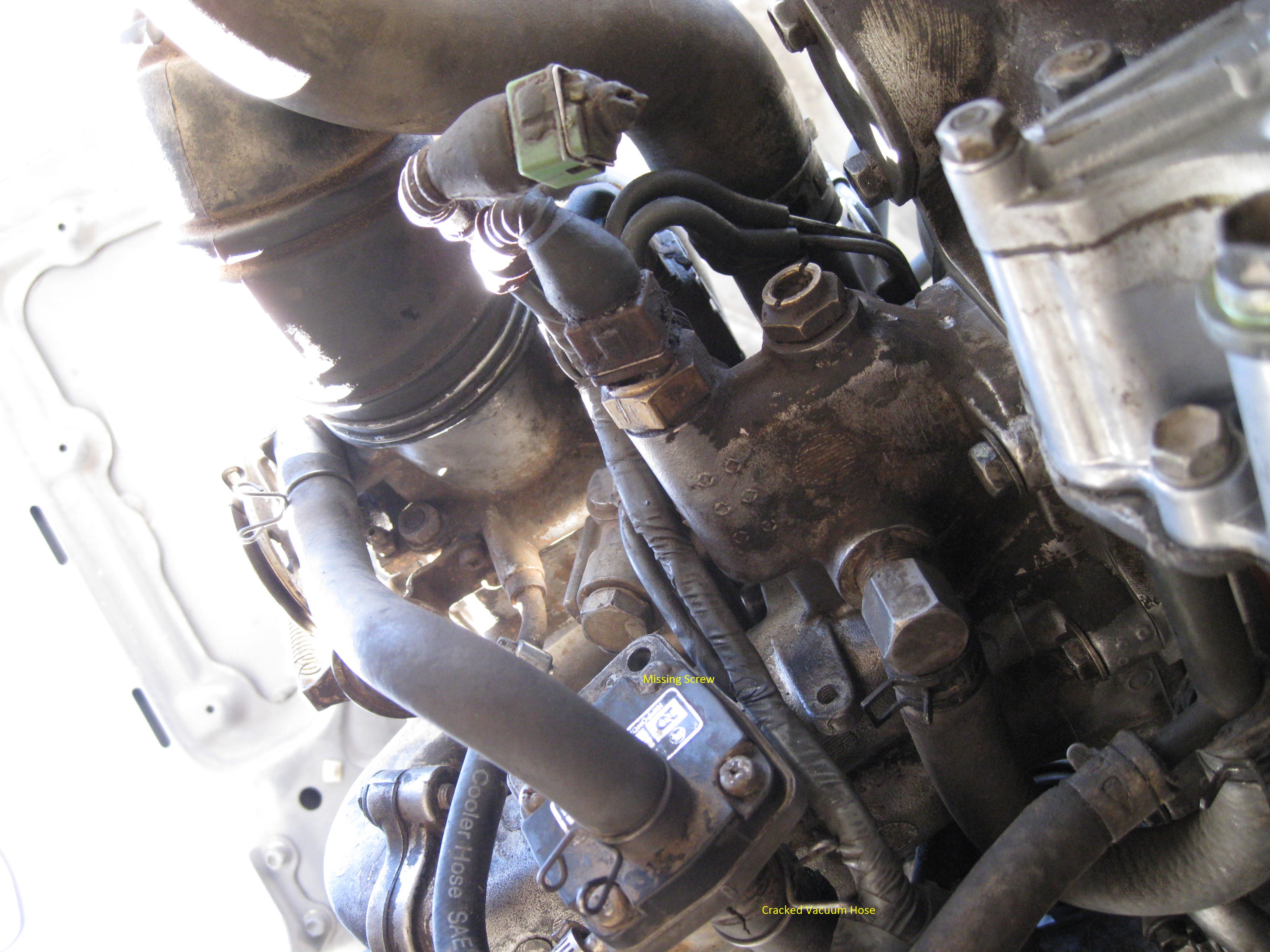

Well I found what the broken {green} connector goes to....under the coolant jack there is a brown connector coming out of a brass fitting on front side of manifold, next to it {on right } is a smaller brass fitting going into same area of manifold. I dug around inside the middle of fitting and found two wires. This must be where the connector broke off from wires. The connector is on such a short lead that it makes sense. included are two pics one from under side the other from over radiator

definitely the ECU temp sensor, so you'll want to replace it.

Just to clarify what Wally is saying, the ECU temp sensor itself is broken, that green connector looks like it still has a piece of it lodged in there, so what you really need to do is go to the parts store and get another temp sensor, it doesn't look like you are missing any of the wiring, just the connector broke right off the sensor itself.

There's no IAC on 22RE engines. This particular model uses an external Auxiliary Air Valve to increase cold RPM's. Speaking of that, I see 2 problems:
Problem #1 There's one screw missing on the AA valve itself. This is a 2 piece design with a gasket affixed and sealed using 4 screws. Any vacuum leaks here will affect engine performance,cold or hot.
Problem 2# There's a large crack in the rear vacuum hose of the AA valve. This, too, will greatly affect engine performance, both cold and hot.

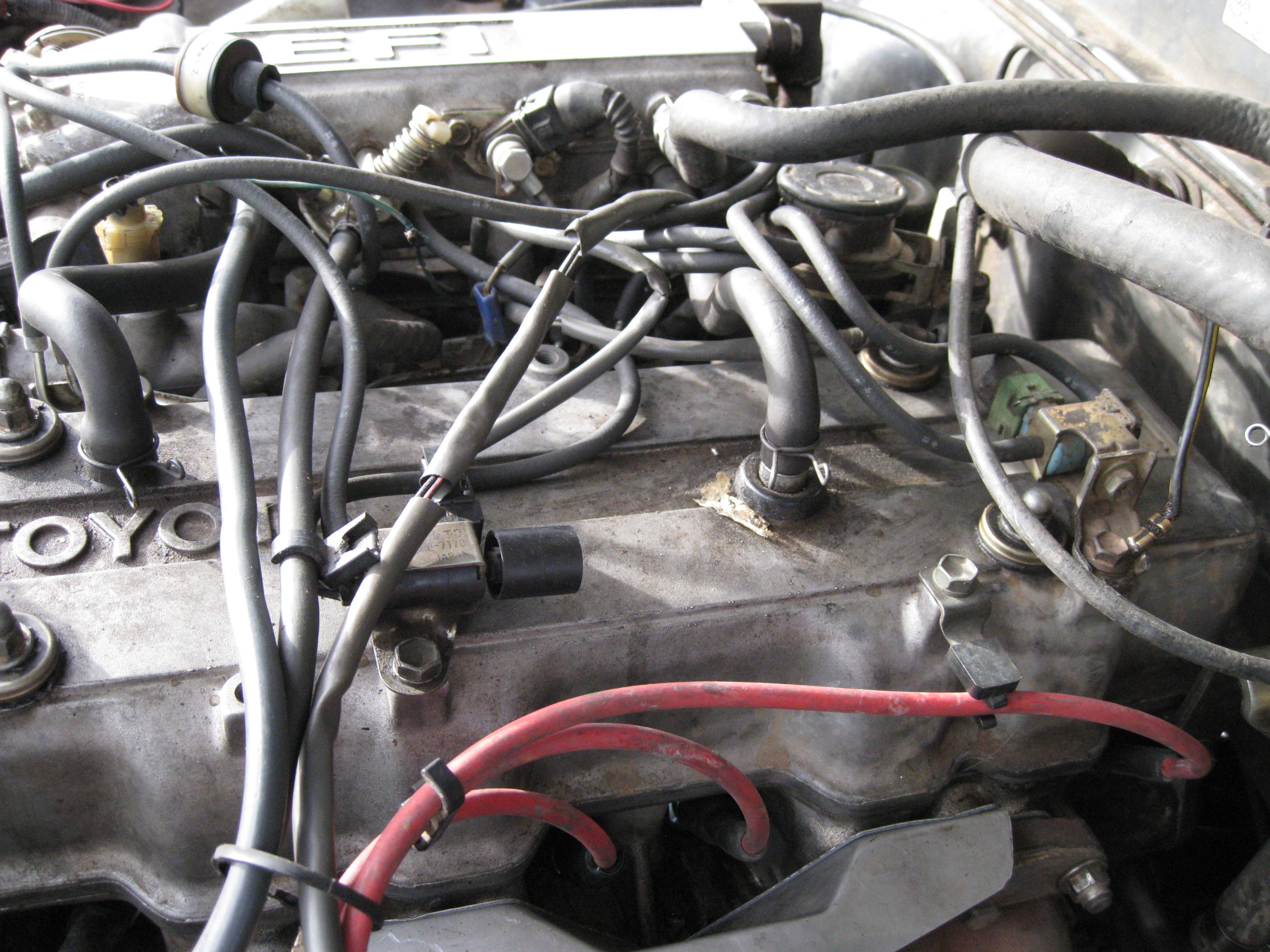

OK in the across the engine picture from the exhaust side, the blue lug hanging unconnected is the temp sensor for the gauge you'll find the sensor located a few inches below about the middle of the engine.
Same image just to the left is an exposed wire, runs to the sensor on top of the thermostat housing.
same image far right, is the heater valve cable it goes to the valve right above it there should be a metal arm sticking down off the valve.
Same image, center of the picture is a switched valve, this appears to be hooked to the R port of the throttle body and the large valve on the plenum? That's not right, but I got lazy and am not going outside to see where it's supposed to go.

You are not missing a screw in the AV (air valve) that is one of the mounting holes showing, you'll find two corresponding holes to mount it to the lower intake manifold. There is one showing just to the right of it.
As noted there is a crack in the hose on the back side of the AV, if you have a leak here it is after the throttle plate and is a major issue. If nothing else trim off the crack and hardened bits and reattach it.
