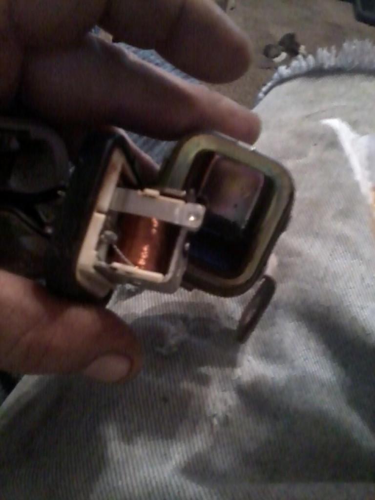

If I am understanding it right, it is just clicking. You can try cleaning the Starter Relay Contacts and that helps. Also replacing the contacts in the starter helps some too. To fix the problem for good, I follow RADS fix for it. I will see if I can find the information that I do to fix it.

Take a finger nail file or some fine grit sandpaper and clean the contacts.

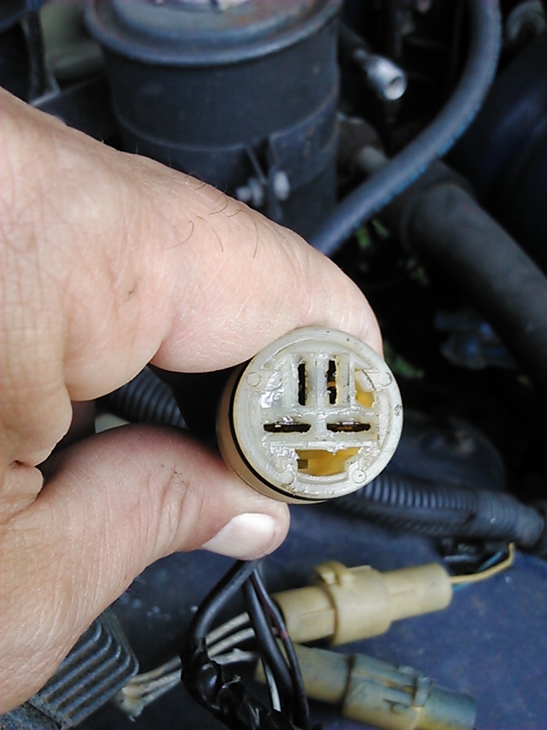

If you look at the plug with eyes, mustache and a smile, the one you need to cut is the right side of the mustache as you are looking at it, hehe

What I am trying to show here is the thinnest little black wire with the red stripe is on the left. The wire on the right is the one you want to cut which is diagonally across from the red stripe wire. Going from Left, Top, Right and Bottom, it is the Right one. The wire that I cut and is where my pinky is going to get wrapped back up into the wiring harness and will not be used again.

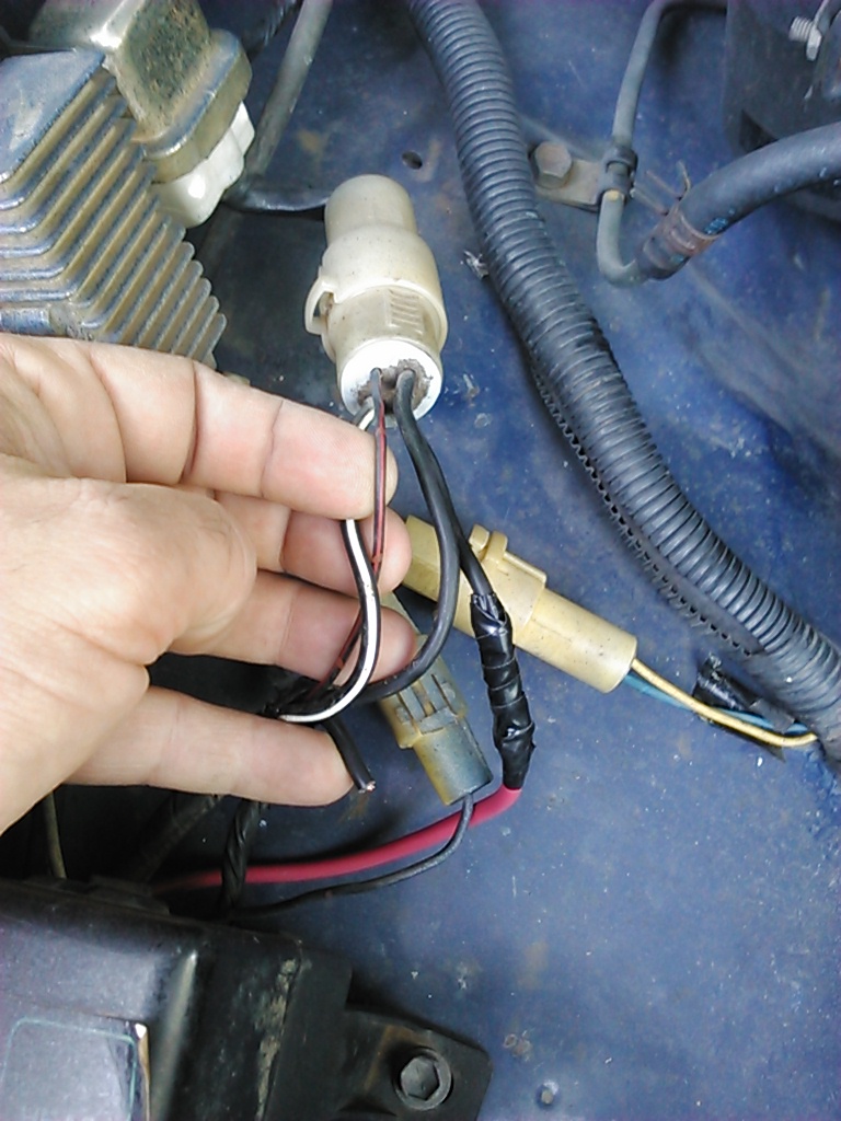

I eventually want to run a kill switch inside the cab and to do the AFM and Battery Swap. I also have an 82 Supra AFM that I want to install when I do all of that. I feel this will fix the click only issue and Thanks Ray for taking the time to step me thru it.

To try and show how I have it and how it is routed, it comes off of the batttery with a 30 Amp Fuse connector, along fender well to the Starter Relay Plug. I have left the wires loose just for explanation purposes but did route it tighter and cleaner.
