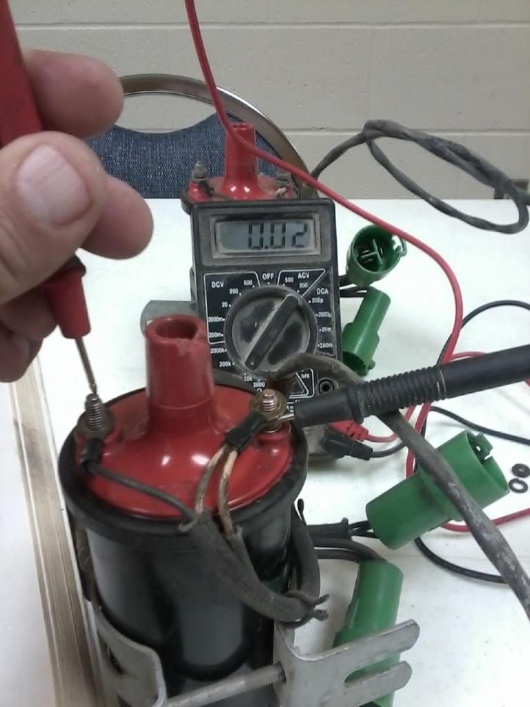

I think the 22r uses a different Igniter, but if not here is for a EFI.
Copied...

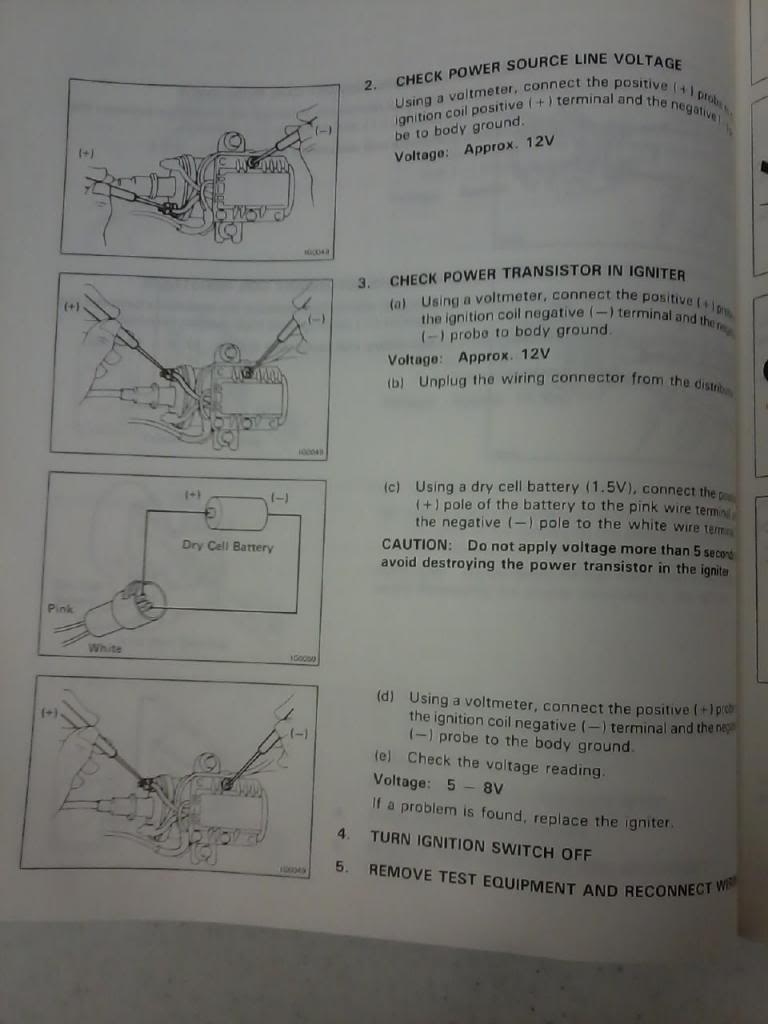

I found out that my coil is bad. It will pass the secondary resistance checks but fails the primary resistance checks. I had to look into the FSM on how to test the Igniter. I wanted to post the information up, but Photobucket isnt uploading right now. Test for it isnt in Haynes but is in the FSM.
It should be .5-.7

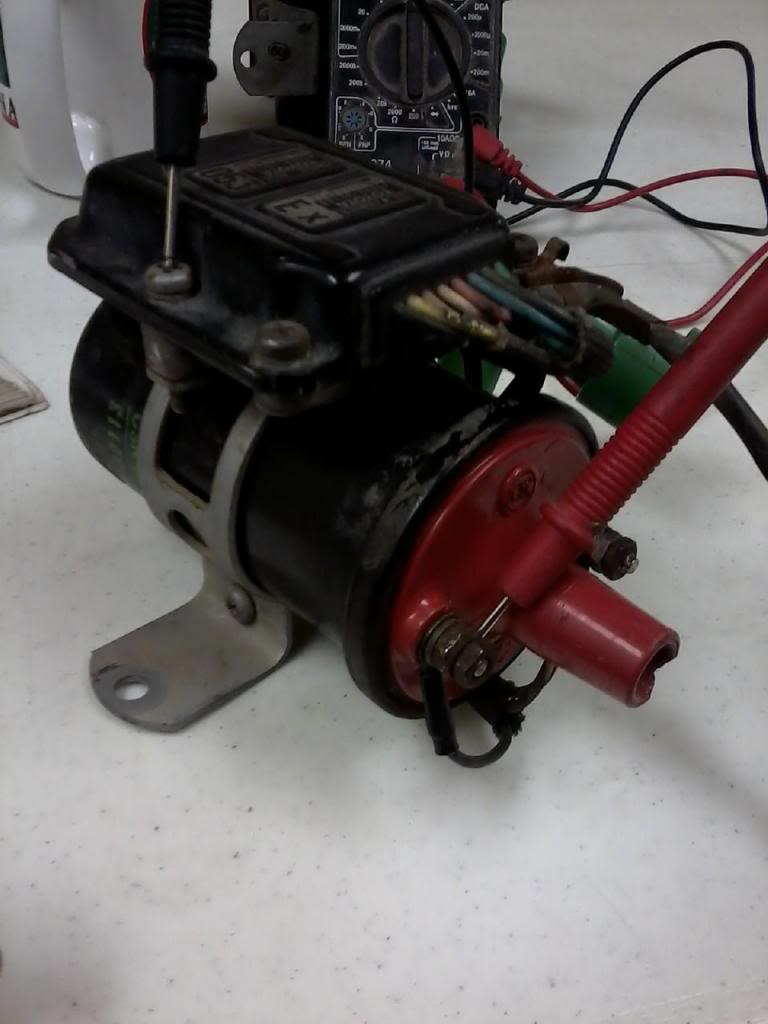

I have not been able to find out how to test in Haynes or on the net. This is out of my FSM. Electric test is easy. The screw is the ground to the igniter with the bracket. With the key on you just look for 12 volts from the ground screw to each of the coils post. Where you hook up the battery it says you have 5 seconds. I think I will pass doing that test. It would take me 5 seconds just to see what is on the meter. My eyes are not as fast as they used to be.

Igniter ground screw.
