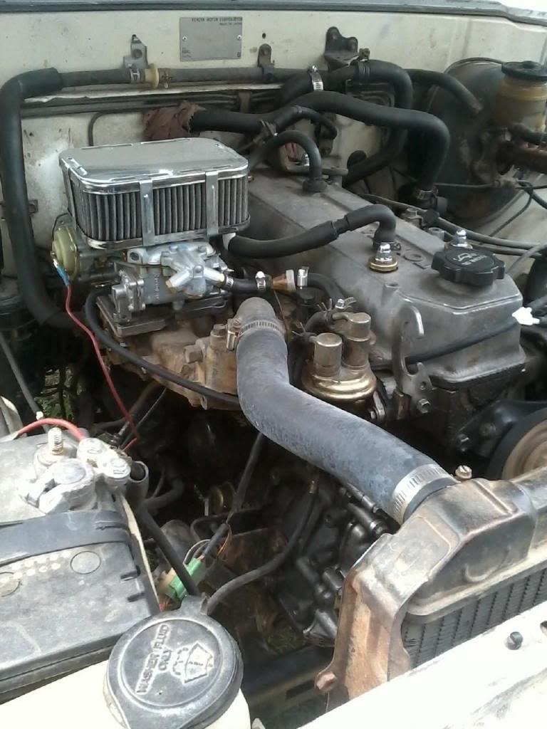

As far as rebuilt carb or a Webber. I suggest a Webber. It gets rid of the vacuum hose nitemare that is on the factory carbs.

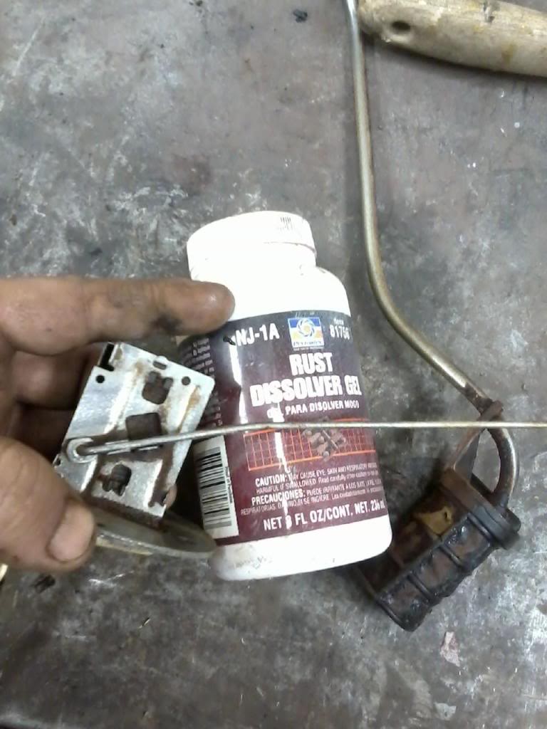

The float was frozen solid. I put the rust dissolver on it and had it working in 2 minutes. I am really starting to like this brand over PB Blaster. Here it is frozen up with rust. Fuel filter is hard as a rock also.

Here is a Webber installed on my brothers truck.Very few vacuum lines.

OK so the wd-40 "blue torch" stuff seemed to work really well. I wish I would have taken a before picture of the sending unit. Mine has Philip head screws that def weren't coming out with a screw driver. Vice grips got them turning, all of them! I was really surprised, sending unit and float assembly. The plan is to run white vinegar in the tank for a couple days..let dry and then maybe red kote. That brings me to some questions the unit and float assembly are pretty rusty inside the tank. If insoak them in vinegar as well...what do I seal them with to prevent rust? Also what are my options when the time comes to put unit and float back on clean tank as far as screws? If I buy a new locking ring ill need one for both components and wonder if they come with new screws?

Mikey... I dont have any suggestions for cleaning the pieces while in the tank. Afterwards you will still need to get the cleaning stuff out of the tank. On the float assembly I suggest spraying some rust dissolver on the outside and scrubbing it with a brass toothbrush. It will clean up in about 5-10 minutes. You can get moving freely by gently cleaning around the pivot points and just getting it looking good on the outside.
As far as inside the box where is basically a resistor, the cover will come off and you can get it clean in there. But I would suggest not taking it apart because really not much that you can do in there to get working. It is not hard to get apart, but if you can get it moving freely, just spray alot of WD-40 in there and rinse it with water until you get no more gunk out of it. Inside the box, the resistor is mostly a wire that is nearly the same diameter of a strand of hair. As the float rises and falls, it increases or decreases resistance that is in sync with your gas guage. I have seen where the wiper that rides against the hair like wire that the wires are broken. Not much you can do other then replace the whole assembly. If your gas guage is working fine, I wouldnt mess with inside the box. When done rinsing, just add plenty of WD-40. The float is designed to take the harshness of fuel and will get soaked with fuel. Anything you put on will just get washed off from the fuel.
I am sure Toyota sells those screws, but in very few instance that I use hardware store screws, I have used screws/bolts for the float and supply assemblies. I have reused my gaskets if they are in good shape and never had any problems. I have seen new gaskets on ebay for not too much.
