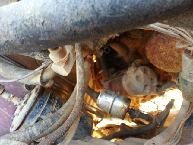

Old Nov 29, 2013 | 11:10 AM
  #36
mikeyd6789's Avatar
Joined: Nov 2013
Posts: 244
From: Virginia
Filter
Old Nov 29, 2013 | 03:48 PM
  #37
mikeyd6789's Avatar
Joined: Nov 2013
Posts: 244
From: Virginia
Another look...shiney inline filter of some sort attached to carb

Old Dec 2, 2013 | 10:34 AM
  #39
Terrys87's Avatar
Posts: 11,787
Likes: 28
From: Anderson Missouri
I looked at a 22r truck and it comes straight from the inner fender and goes to the fuel pump. The filter you are showing is what someone has added. Not a bad idea as it does offer more protection. It is not what came factory. Does yours have a filter at the tank? They may have installed that one to make it easier to change instead of the one at the tank.
Old Dec 2, 2013 | 10:54 AM
  #40
mikeyd6789's Avatar
Joined: Nov 2013
Posts: 244
From: Virginia
Yep it does have the one at the frame. That's what I figured, someone had added one.
