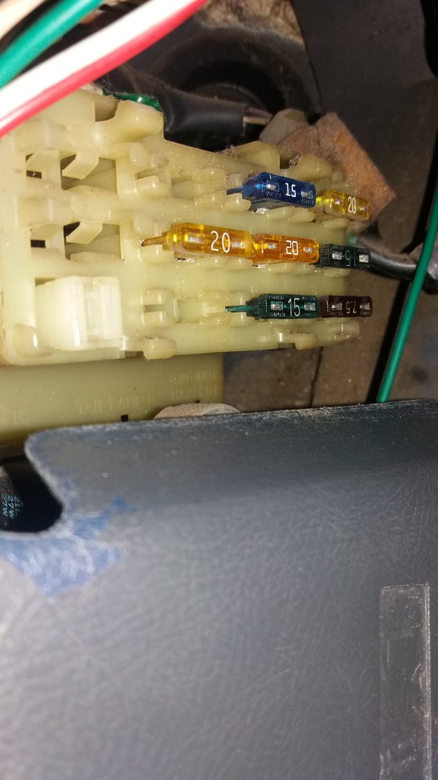

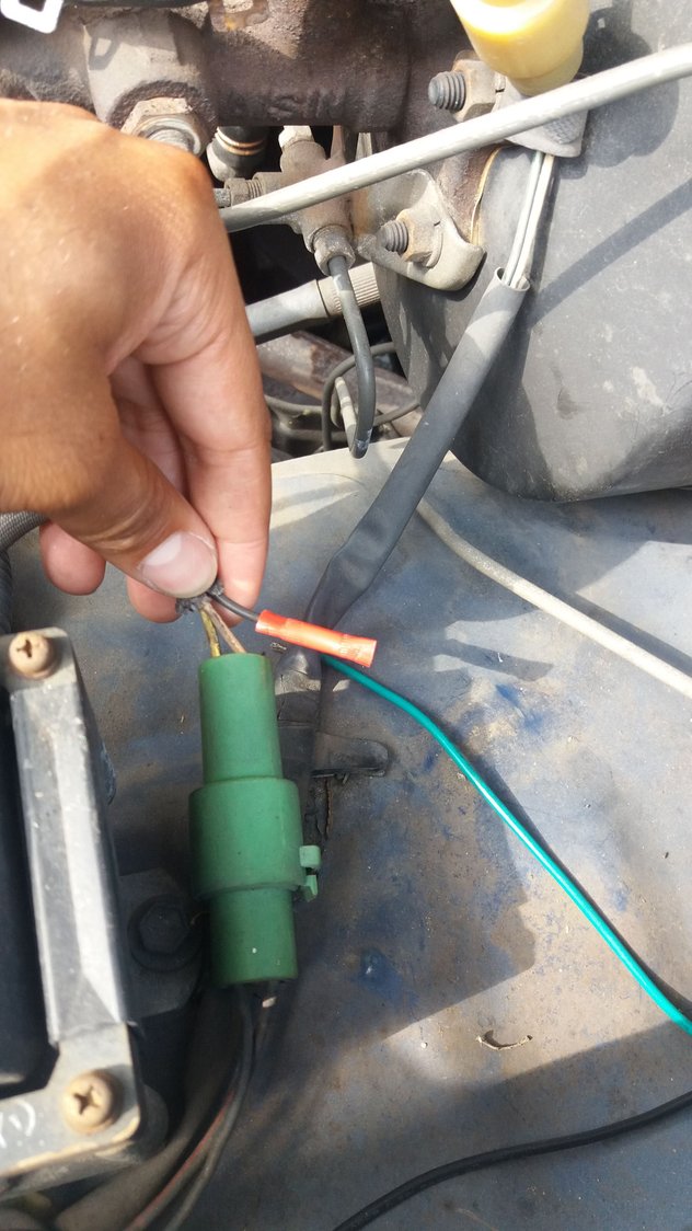

grounding wire is connected to the chassis where the coil ignitor is
The power cable splicing to where the SR5 cluster connector was.
The lighting wires were connected through the fuse box on the lower 15 amp and the left 20 amp
If you have an SR5 it should have a tach. If not your pic does not show or describe exactly which wire the signal pickup is coming from.
You wrote: "The lighting wires were connected through the fuse box on the lower 15 amp and the left 20 amp"
That is written like your taking power from 2 hot sources?????

I literally just copied what the guy did on the video. I don't have an SR5, the guy on the video said it was a cluster connector for an SR5 option I guess. It's a green connector that wasn't connected to anything just like the one in the picture, so I cut it off and spliced my power wire to. Not really sure to be honest. And I literally just wrapped the wire around on end of the fuses and plugged them back in. It was working for a couple days then ceased to start. The guy in the video was attaching his to an 83 pickup but it looked similar to what I have.

Hmmm. Well, I think we can say you are one lucky Toyota owner. The usual result of that sort of work is a fire.

First, if you don't want your truck, and/or house, to burn down, if you have done ANY other wiring as you described before undo it and make proper connections.
just wrapped the wire around on end and cut it off and spliced my power wire are neither good or safe connections
Second, get and install a fire extinguisher in your truck. Actually ATTACH it, with hardware - not tape, to something made of metal.
Third, based on what I've read here, a 1st Gen and an 86 are not very similar. Note that there are different sections here for both.
The "green connector that wasn't connected to anything" HAD a spade type connector inside - cutting it off was a BAD idea.

And please put arrows on your pictures. There are too many parts in them we could not see what you're talking about.
