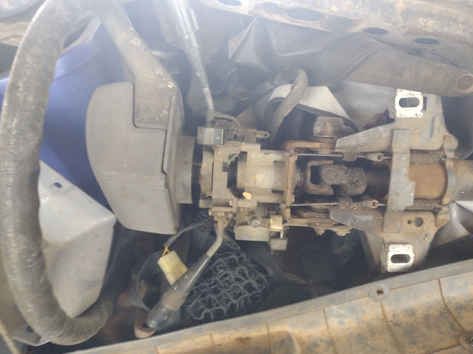

I removed mine to clean and lube it. Have to remove the steering wheel 1st. Screw at the horn pad base and a nut on the shaft. I used a puller the 1st time, then applied a thin coat of anti-seize on the shaft splines for easy hand removal. No need to apply too much torque as it stays secure. Needed that to clean the horn contact ring from time to time.
There are 4 sheet metal screws on front of the stalk assembly. Mine were lose so I used a slightly bigger diameter screw to reinstall the assy. It's an aluminum base, so they create new threads for a very tight fit. Then the whole assembly slips off. Only difficult part is the wiring harness has very little excess length/play so you have to gently pull on it to get the harness off the shaft. Check the small screws on the assy parts as they can loosen up.
It's also a good time to clean the horn rim with green pot scrubber and to buy some electronic cleaner/lube to spray all the stalk electrical switches and put some silicone paste lube on the pivots and indents.

I remove the horn pad, then loosen the nut holding the wheel on, backing it off until it's on the last 2-3 threads. Then I just grab the wheel at both sides and pull(while pushing against the floor with my feet), rocking gently back and forth. It'll break loose pretty easily. You leave the nut on so you don't smash yourself in the face with the steering wheel. Make sure to scribe the wheel and shaft so you get it splined right when you reassemble.
I took my turn signal switch assembly all the way out and removed all the old grease and applied new. I was afraid the original grease had thickened with age, and I wanted to reduce any resistance on the various moving parts inside.
Removing the stalk from the T.S assy is easy at this point. You're supposed to remove the wire pins at the connector so that takes the most time.
