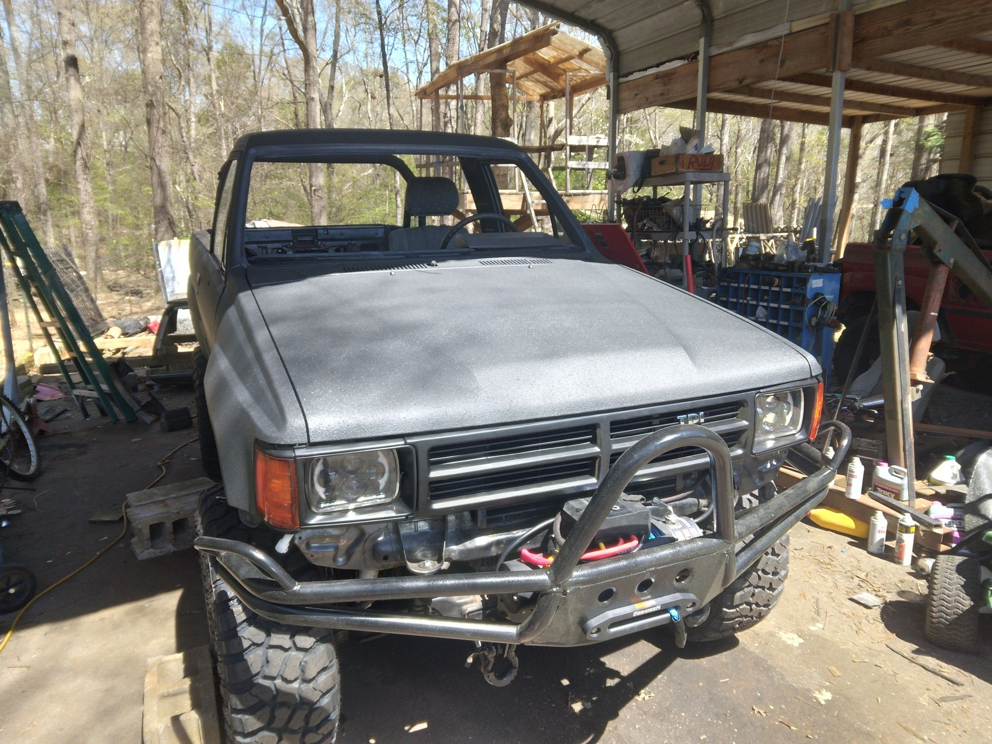

this is the all pro bumper, same company (a part of) trail gear.
In order to fit the winch without cutting the grill I needed a body lift. It's filled in with lawn edging to help cover the exposed parts. I needed the body lift to help the diesel clear the front diff.
This will likely fit near identical to the trail gear.
Jegs had it the cheapest when I made the purchase.
I'd imagine your next gen is very similar in fitment to my ifs 87

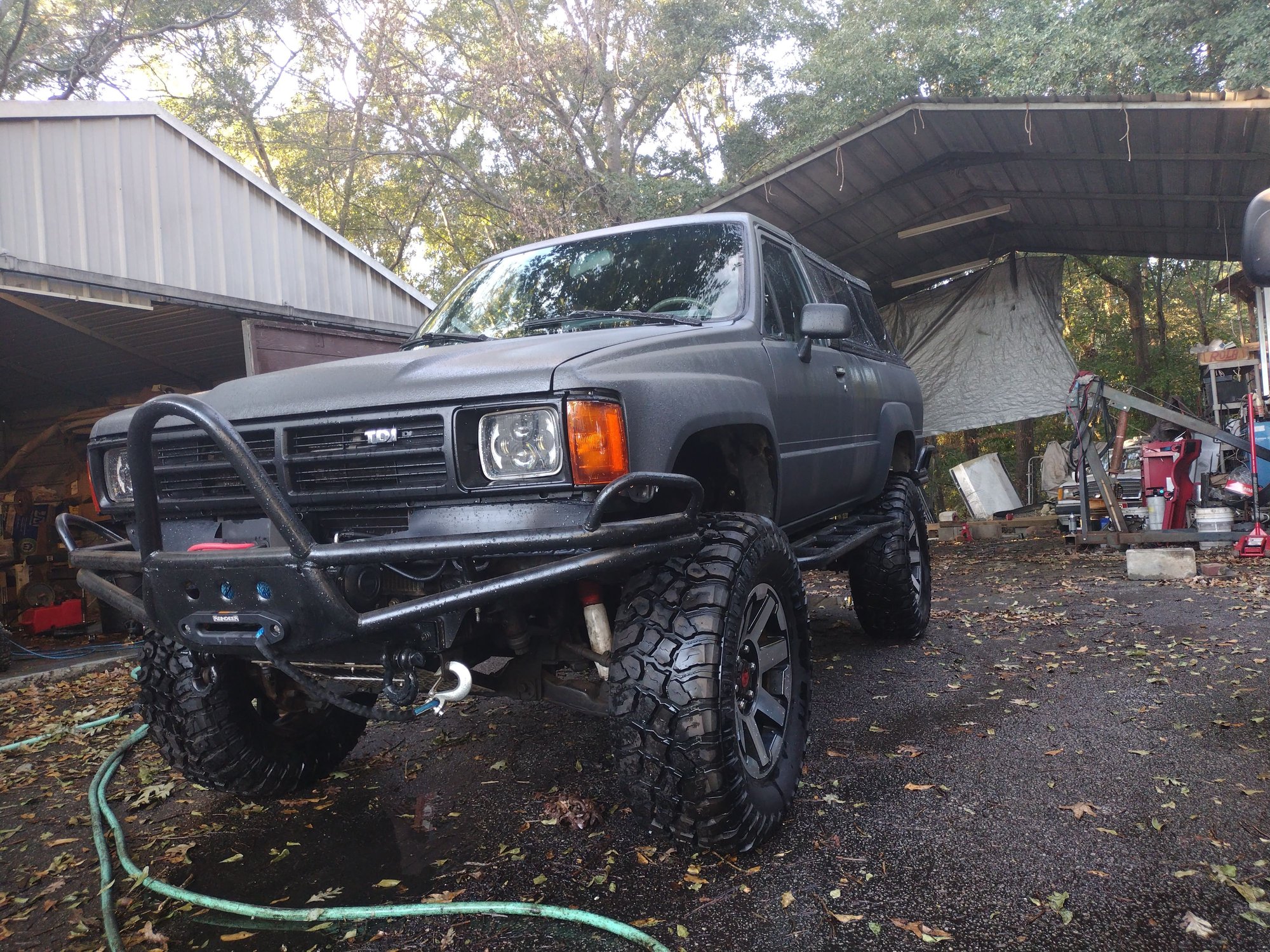

Just cut the grill.
Maybe a winch without a mounted solenoid pack would fit? Like a m8000 ? You would just have to mount the solenoids elsewhere.
I cant remember if we had to cut the grill on this one. But I dont think so. This is a m series winch.. The solenoids here are mounted right to the grill.

The solenoid pack could be moved and would likely net the extra 2 inches she needs. (Insert that's what she said)
On this cheap reindeer winch anyway.
Thanks man I think yours looks great however I am not too interested in doing a body lift. I took your advice and got a winch with a solenoid pack that can be mounted separately though. If worst comes to worst I will trim the grill a little to fit because function is the main goal here.
