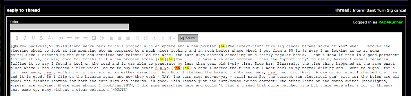

(Went to "source" mode and removed those pesky "h6's" in brackets...
Originally Posted by L5wolvesf
Annnd we’re back to this project with an update and a new problem. The intermittent turn sig cancel became sorta “fixed” when I removed the steering wheel to look at its mounting etc as compared to a much nicer looking and in much better shape wheel I got from a 90 Pu (a swap I am looking to do at some point). Once I cleaned up the dust and detritus and reinstalled the wheel the turn sigs started canceling on a fairly regular basis. I don’t know if this is a good permanent fix but it is, or was, good for months till a new problem arose.
Now . . . I have a related problem. I had the “opportunity” to use my hazard flashers recently. Suffice it to say I found a tool on the road and it was able to penetrate my less than year old 8-ply tire. Side bar: Bizarrely, the tire thing happened at the same exact place where I had shredded a tire which led me to buy the newer 8-plys.
So once I sorted the tires out I went back to my normal driving and I went to signal for a turn and nada, nyet, nothing – no turn signal in either direction. Woo Hoo. I checked the hazard lights and nada, nyet, nothing. Grrr. A day or so later I checked the fuse and it is good. So I flip on the hazards again and now they work – YAY. The turn sigs not-so-yay – still nada.So, the current (an electrical pun) situ is: the bulbs are all good; the flasher (common for both the turn sigs and hazards) is good. This leaves just the turn/combo switch correct? The other items on the combo switch (headlights, wipers) are working. Where else should I look/test?BTW, I did some searching here and couldn’t find a thread that quite matched mine but there were also a lot of threads that came up, many without a clear solution.
Sounds like you have two problems at the same time; mechanical in the case of not canceling, and intermittent electrical.
Need one essential info: Do you hear the blinker relay click even when either hazard, left, or right turn do not work?
Attached Thumbnails Intermittent Turn Sig cancel-screen-shot-2018-04-10-12.40.50-pm.png
Uhmmm OK I didn't see pesky "h6's" in brackets - you speak strange language stranger.

[QUOTE=L5wolvesf;52395720]Uhmmm OK I didn't see pesky "h6's" in brackets - you speak strange language stranger. [/QUOTE
LOL!

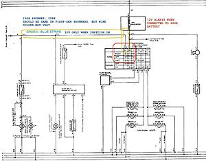

When you click "Source" (attached), you get into a little basic HTML editing mode.
When the hazard flashers are on I hear and felt the flasher clicking, and the dash indicator lights flash along with the lights outside.
When I turn on either turn sig no sight no sound - just the opposite of the Twilight Zone.
Most likely the contacts in red rectangle in attached, or power/connection to them...
You remember, of course, that hazards will work as long as good battery is connected, while turns only work with IGN On, right?
Attached Thumbnails Intermittent Turn Sig cancel-schematic_turn_signal.jpg   Intermittent Turn Sig cancel-source.png

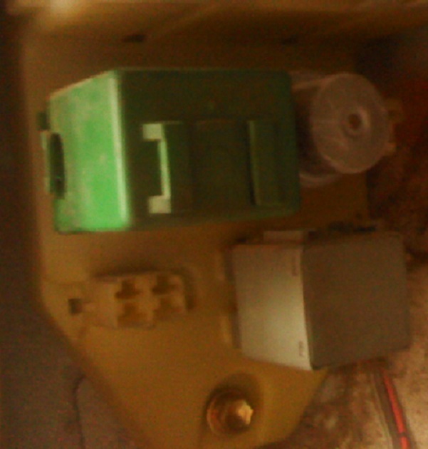

OK, hold up a bit. I went out to look at the flasher again and discovered there are 3 items under the fuse box. The one I felt clicking is the green one. I didn’t notice earlier that there was the round silver flasher behind that. So, I checked again and I can feel the clicks on all 3. Now another question: what are the 2 square items 1 green & 1 grey?

OKEY, found the check procedure. I revised above "question" post to make it the "Test Procedure" post...
On my 1986 22RE (here). The cube is the blinker. That should be the only one that clicks on-off when blinkers are on.
The one on top and toward front of vehicle is the tail light and the other one is the EFI (22R-e) main relay. Don't know what that other cube is on your 22R.
