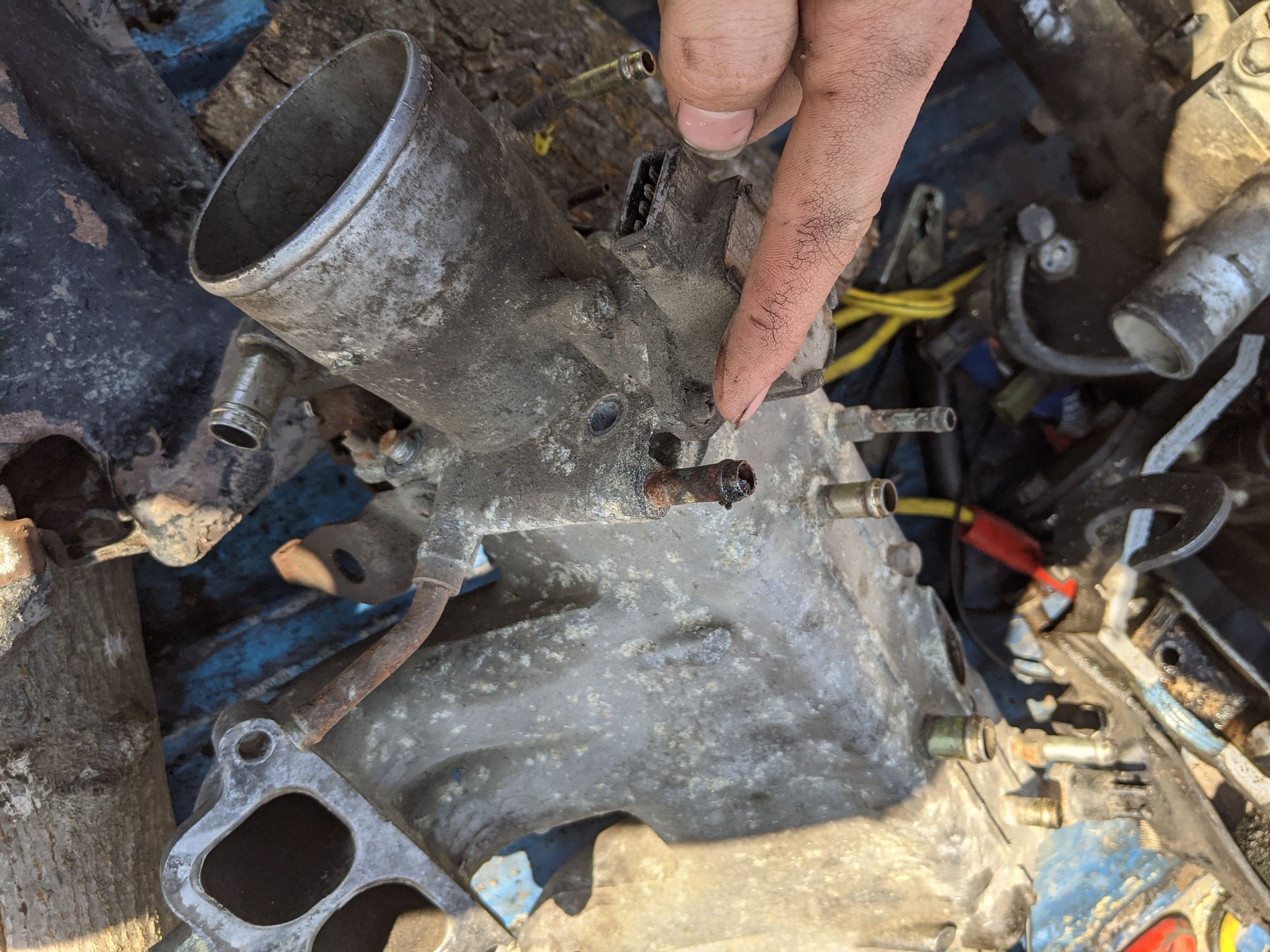

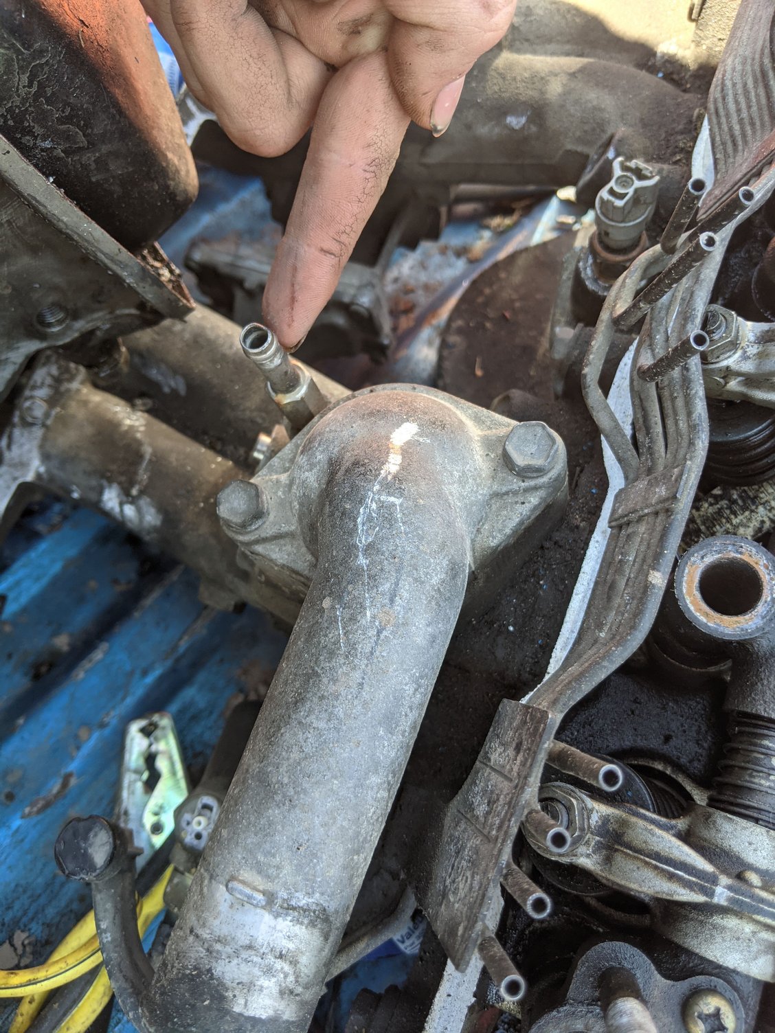

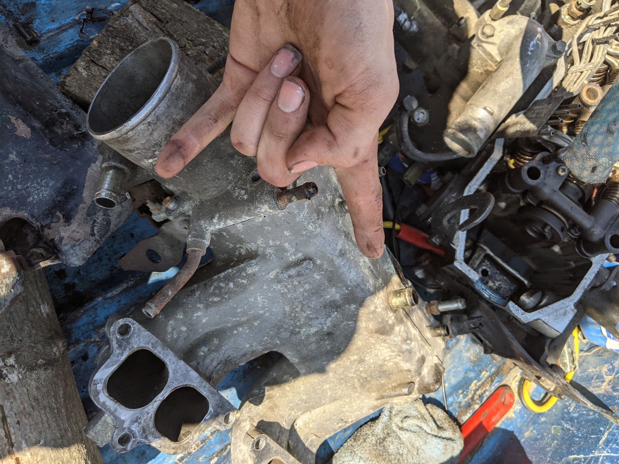

4runner's at school so I have to show you on my junk motor.
I put the temp sender here:
that connected to these lines for the throttle body de-icing, I just capped those off:
Then for the IACV I just plugged the lines for it and took off and blocked the coolant lines, it's still plugged in just hanging in the engine bay.

But all the idle up ports on the intake are gone, only the idle screw is there. So unless it can raise the idle via the injectors there's no way that can be caused by my deletes
