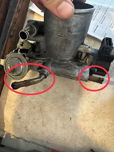

Im cleaning and replacing gaskets/hoses on my throttle body. When i took everything apart I noticed that these fittings are kind of trashed. Can I replace them?
Thanks

Yes, and then no. Followed by a maybe. Those pipes are pressed in, but can be removed without too much effort. Iirc i just used my heat gun till i could pull/rotate out with pliers
Once you get the pipes out you can tap the holes and get replacement pipes that screw in. Now, I've done the one on the right easily.
I've had a tougher time finding an adequate one for the one on the left. The length, combined with the bend, makes it more challenging to source.
I'll do some research later today and give you the size you'll need.

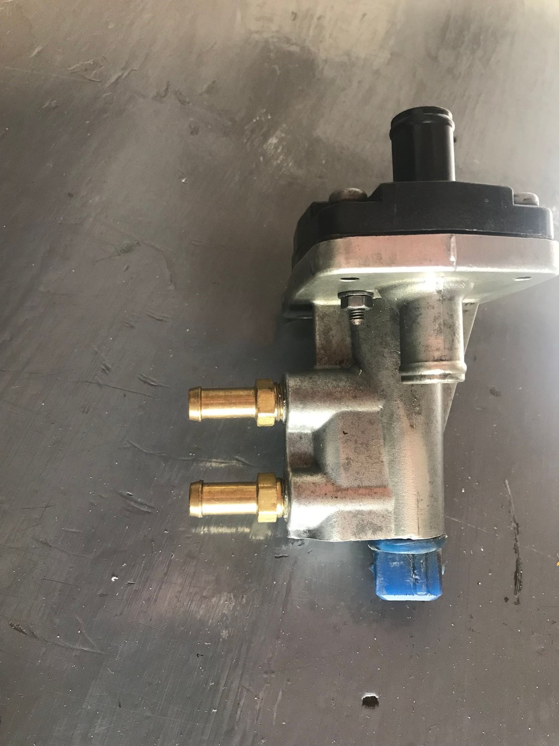

Ok. the tap I used. 1/8” 27-npt. If you google 1/8” mnpt hose barb you’ll see various fittings that could work.
Heres a picture of a spare IACV that I experimented on. It had pipes like yours, but everything in the valve itself was stellar. Again, the only struggle I’ve had regarding the throttle body pipes was finding one long enough to replace the one with a bend. The short one was easy.
