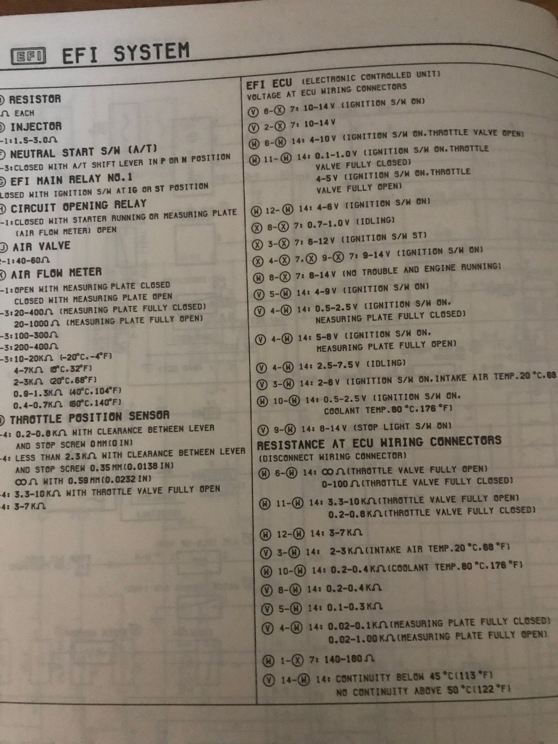

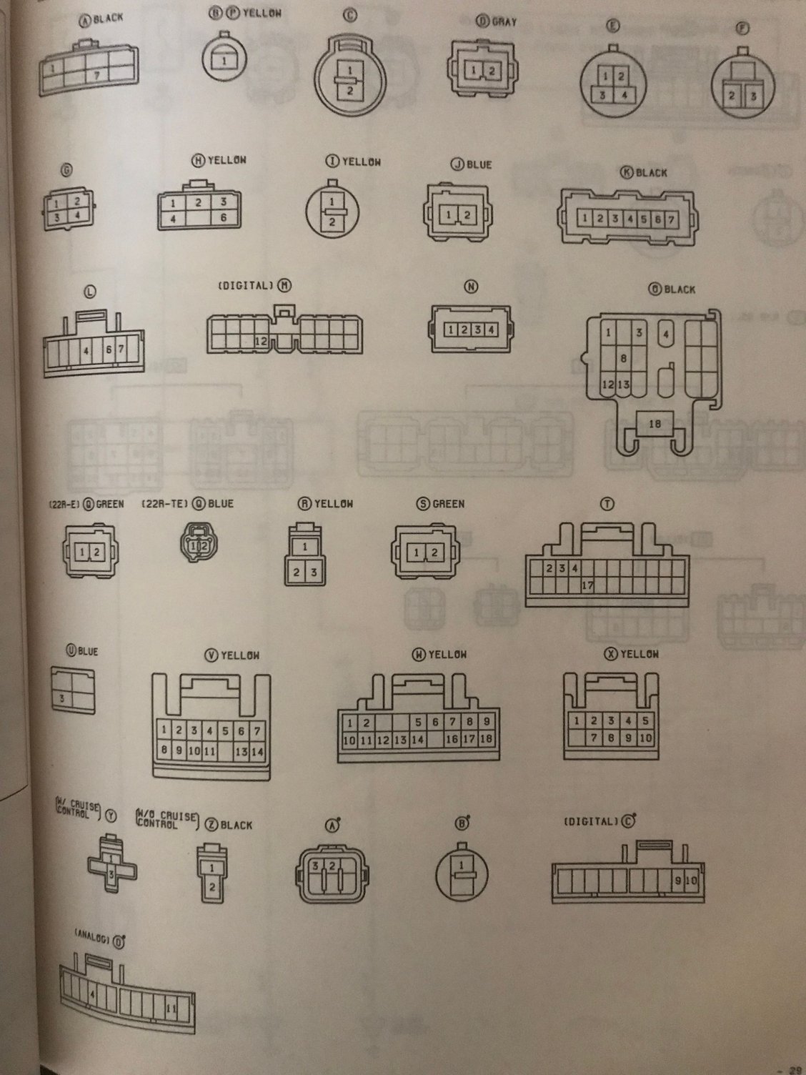

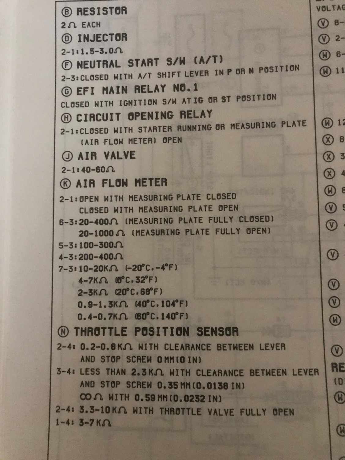

Heres some info out of my 1987 Toyota EWD manual that could be helpful. A little more insightful than the FSM.
