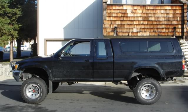

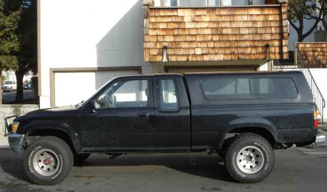

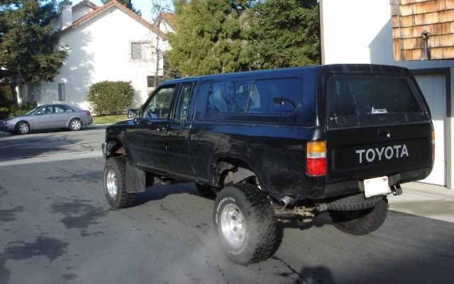

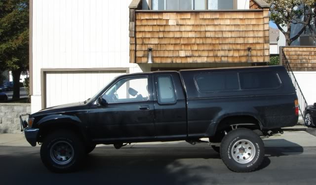

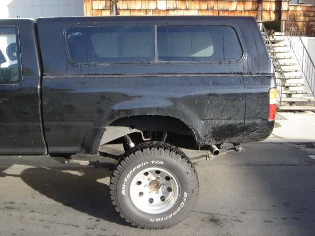

Finally got done with the whole suspension work this past weekend ...
Here are the pictures as promised
Before Swap / Lift:
During / After Rear Chevy Install. ~5.5" lift from before
After IFS Lift (4" Bracket Lift + 1.5" BJ Spacers + Slight Torsion Bar Crank]
Issues / Concerns / Feedback
- Much smoother ride than before. Chevy springs give good lift and flex great. Was expecting 2-3" lift, but ended up with ~5.5" with the camper weight. Great Swap .. except a few headaches mentioned below
- As Phil mentioned, is the rear axle not being centered going to be a problem? Mechanic recommended having the axle slightly back to have a longer wheelbase and better stability with all the lift/height. (Not sure if that reasoning is BS). Doesn't seem like a problem.
- Driveline vibrations after swap due to highly extended propeller shaft. Need to extend it by 2.5" and have it rebalanced.
-Rear bumper mounting bracket hits the shackles. Supposedly not a problem on 89 or earlier gen. Recommended to install spacers to move the L bracket outward. Will post pictures once done.
-Unable to mount the Tow Bar. The rear spring hanger had to be repositioned slightly back so the tow bar mount is obstructed now. Need to look into a fix for that.
-Too much lift maybe?... need a ladder to climb into the truck for DD .. .. rock sliders next?

Wheel spacers and taller, wider tires to match your new gears
Old Feb 1, 2011 | 07:28 PM
  #30
camo31_10.50's Avatar
Joined: Aug 2007
Posts: 5,334
From: Vian, OK
it looks like your front spring mount needs to be moved FORWARD about a half inch or an inch, and your shackle mount moved forward about a half inch or inch. maybe even more for both of them.
all of the 63" chevy swaps i seen put the axle in the center of the wheel well like it was factory.
Old Feb 1, 2011 | 07:55 PM
  #31
hgill's Avatar
Joined: Sep 2008
Posts: 157
From: San Jose, CA
Probably wont be doing it .... I have noticed that unless I specifically point it out, it doesn't even get noticed. Even with 33" Tires, it wont be hitting the fender at all when my usual DD or weekend dirt roads. Not even close...there is lots of space. Im not into Rock crawling .. however, there is always the option of fender trimming if needed...lol

I drove my truck around in a similar fashion to picture 3 and 4 for a little bit (not quite so much rake). Kinda funny.
You ended up getting way more lift then I did. Not sure what happened there.
You definitely need some taller and wider tires to be running with that much lift. Hahah.
I think you might have too much lift in the front... Could be the pics.
Easy way to find out. Find a super level spot (workshop or whatever), break out the 4 or better level. I used a digital level. I measured my buddies stock 07 tacoma (level on the bed rail). I adjusted my torsion bars accordingly. I ended up with slightly less rake then my buddy's tacoma.
If you move your axle back to the stock location, you won't have to modify your driveshaft and potentially end up with a wobbly / unbalanced driveshaft.
Your rear shackle angle is a little steep. Should be closer to 45 degrees. Mine's at around 35 degrees, makes for a smooth ride.
Yes, the taller you go, the more of a jump you gotta take to get in. You get used to it. Hahah. It's funny watching passengers get in. 75% of the time they jump too much and smoke their head.

Actually the rear axle not being centered is very noticeable.
Old Feb 2, 2011 | 12:08 AM
  #36
scuba's Avatar
Joined: Jan 2008
Posts: 11,338
Likes: 120
From: Austin, Texas
I do kind of agree with the above post.
Though, the shackle angle looks REALLY good so if you move anything forward I'd move both mounts forward a little bit.
Remember that as the axle flexes the shackles flatten meaning the tire will move back. I think it'll rub if you step up to a larger tire. But, I could be wrong.
