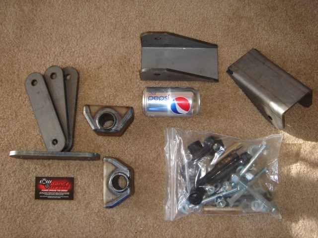

Hey Everyone, I had recently received my kit from Low-Range Off-Road .. The service and shipping was great and the packaging was exceptional!
I took some snaps of the kit for others to view if they are going for the same path.
Full Kit (*Diet Pepsi isnt included .. just for height perspective)

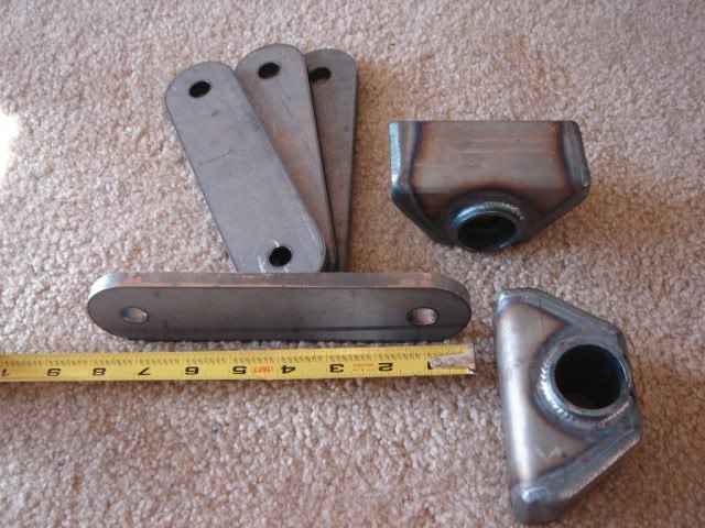

Shackles:

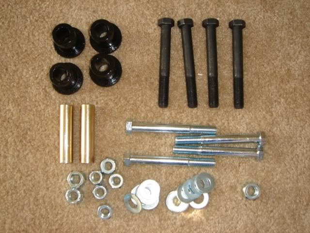

Nuts&Bolts:
Now, im off to painting them and then to my

your going to paint them before you weld them on?

I meant to paint the shackles n some other hard to reach places to prevent rust while keeping the welding areas clean for welding.

@Stuwy123: Thanks for you feedback. How much lift did you end up getting and how long are you shackles? Mine seem to be 6" shackles in the low-range offroad kit.
