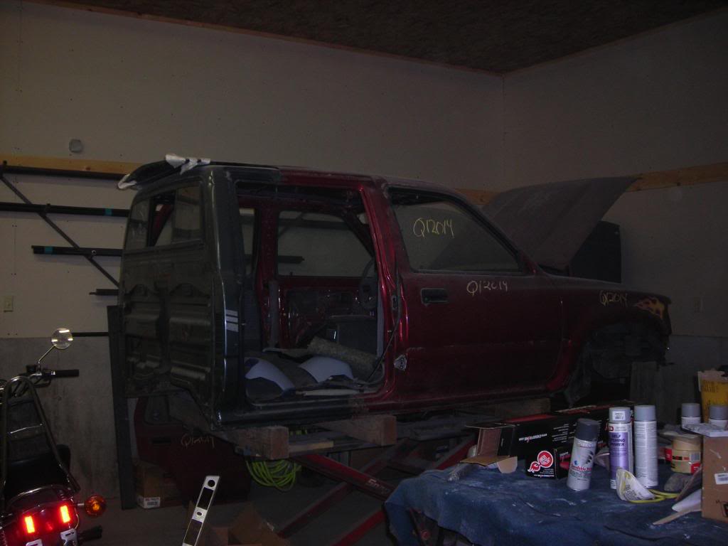

Old Jun 26, 2013 | 06:47 AM
85GT-79FJ40's Avatar
Joined: Nov 2010
Posts: 80
From: NH
This is about as far as my friend got with his. But I think 2 regular cabs, 4Runner rear doors, and a 4Runner B pillar would work.
But honestly I may just buy a 1st gen 4Runner and fix up the 89 for regular pickup duties as well as plowing. It hasn't left my yard since 06.
