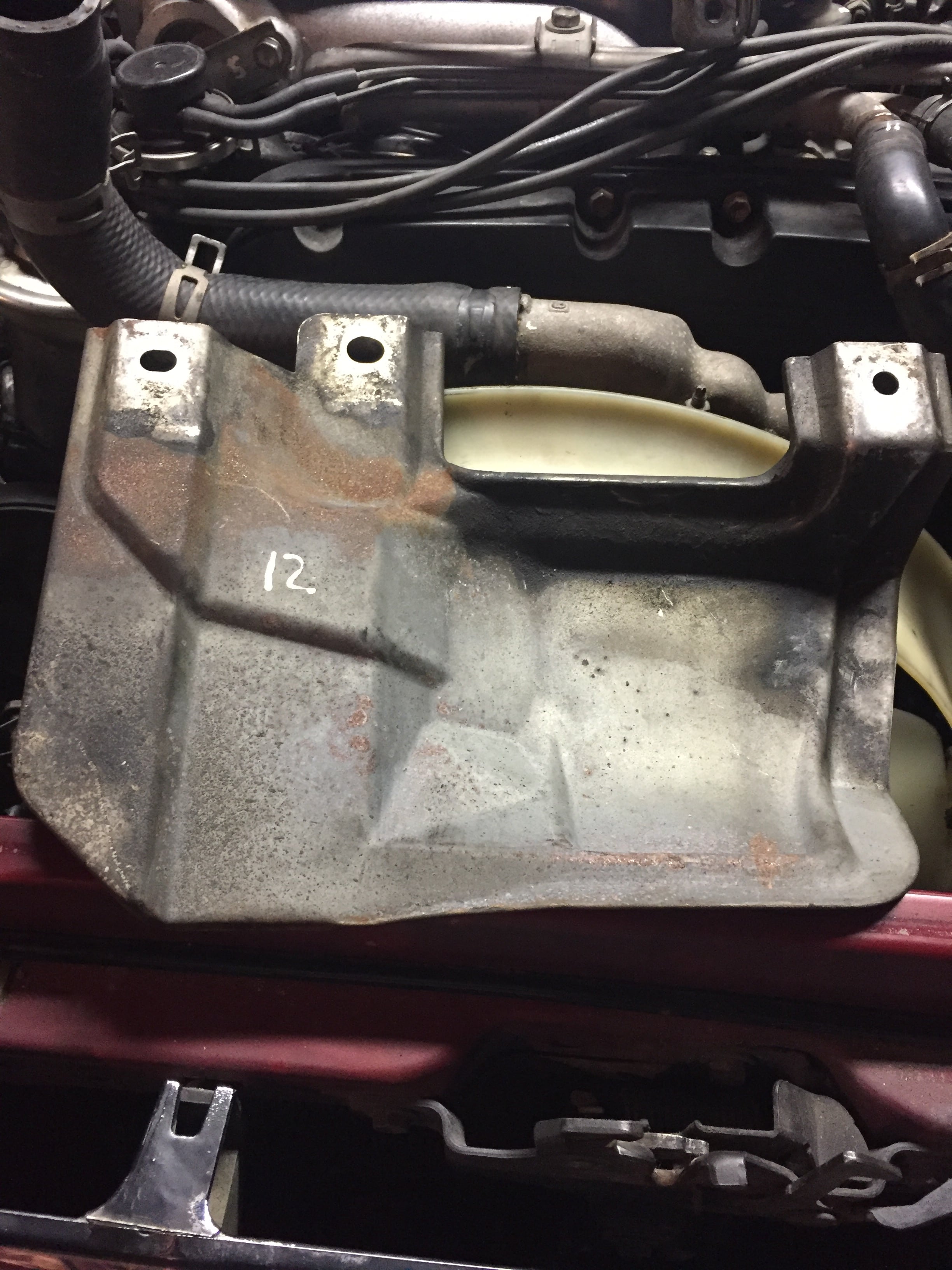

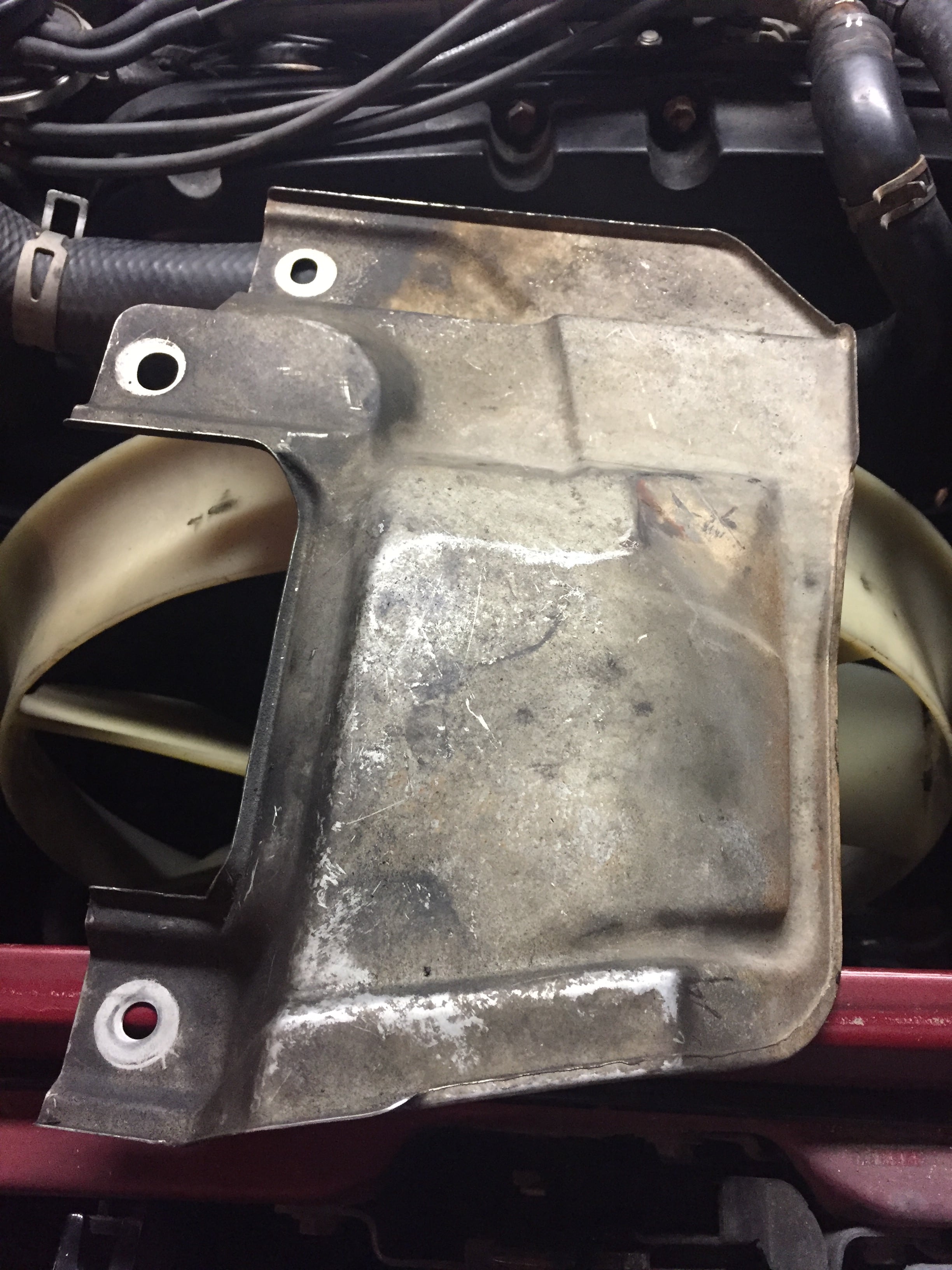

Just finishing up putting everything back together after replacing the head gaskets, and I have this metal piece that I can't find a spot for. I have a note that it goes on the driver's side, but that hasn't been helpful. Anyone know where it goes? Thanks

exhaust shielding?

Is it a filler piece for the inner fender well? I know that my '87 has a piece you can unbolt after removing the tire to get more room to work in

Exhaust shroud on the driver side frame...garbage

I don't think these are heat shrouds. They mount in the wheel wells and act as a splash shield - minimizing the crap thrown from the wheel side. You've got a left and a right there; look for the mounting holes outboard of the slave cylinder and outboard of the manifold to headpipe connection. I think they are well worth re-installing.

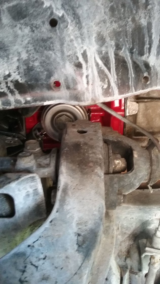

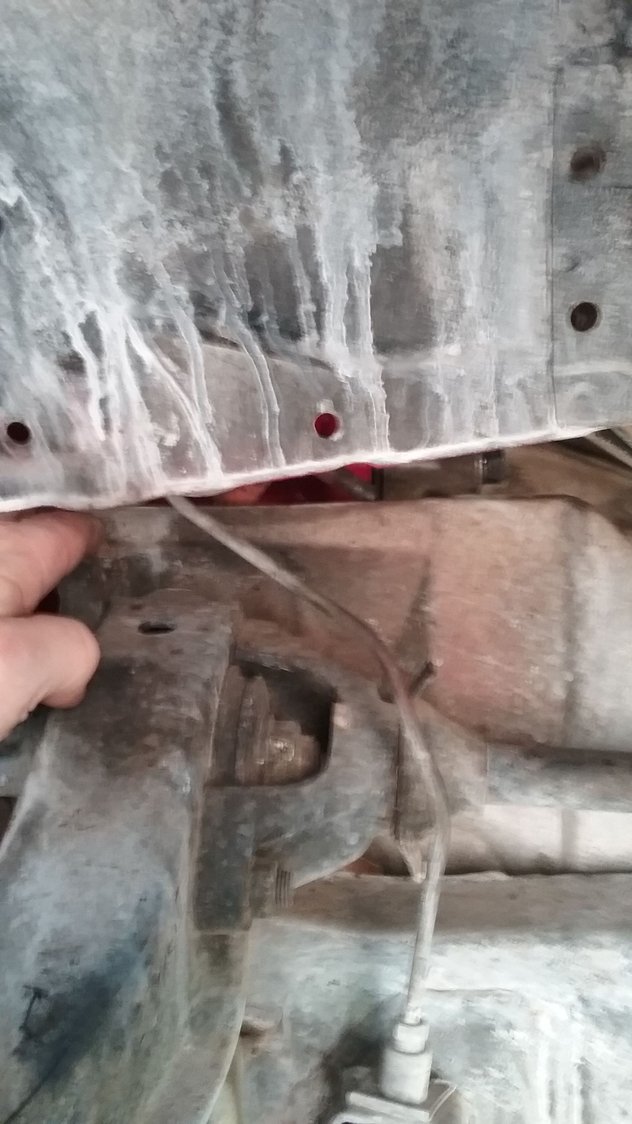

I'll wait for Labow to stroll out to his rig and re-install. If he was pulling his heads while the engine was in the truck, then this piece of metal came off the driver's side frame rail so that he could disconnect the exhaust. Installed
Uninstalled

I'm just guessing as to what the Toyota engineers were thinking when they designed the part, but I'll stick with my trash shield theory since a) there is one on each side and b) it doesn't line up with the exhaust.

It's a heat shield for the down pipe from the manifold by the brakes. It is garbage because it's only in the way of everything when you are working on it and it shield the hard metal brake line coil from exhaust heat. It doesn't make any difference I threw mine away. It does not stop mud as it is too far back from the tire.

Insulator, Brake Tube Heat
47393-35110
https://parts.lakelandtoyota.com/sho...rimLevel=18292
https://www.toyotapartsdeal.com/oem/...393-35110.html
Garbage? Well, you can take the opinion of some real automotive engineers who designed a truck that's already lasted you about 25 years. Or you can listen to some anonymous posters on the internet, some of whom candidly admit they don't know why the part was installed in the first place. Your choice.

Just a quick FYI. Most splash shields are plastic. They don't tend to make splash guards out of metal, as metal and water and mud aren't the best of friends. But I still stand by it, it's really there as it's someone's job in engineering and design to ensure ever possible failure point is eliminated. It's very very harf to boil brake lines from an exhaust which is more than a handwidth away.
