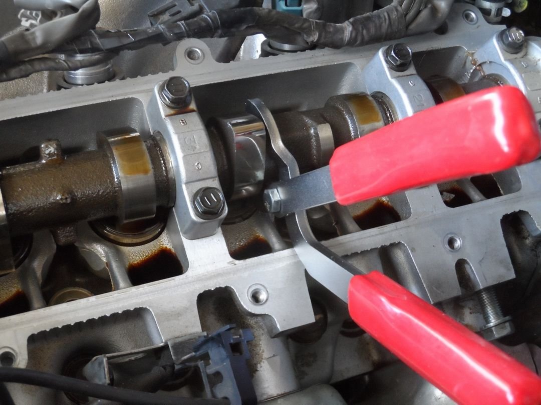

It is possible to remove and replace 3vz valve shims without removing the cams, but it is a pain.
The tool is such as this>>
Amazon.com: Schley Products 88250 Valve Adjusting Tools : Automotive Amazon.com: Schley Products 88250 Valve Adjusting Tools : Automotive
There is a learning curve, and use of compressed air and a powerful magnet along with the tool are helpful.
But if there are only a few shims out of spec, it beats removing the cams.

In my experience, it might take you 10 minutes to remove the first shim with the Schley tool, then 2 minutes each after that. I think that's what millball calls a learning curve.
I don't know how compressed air is used, but I found a small screwdriver can be used to lift the shim (there is a notch in the bucket for that purpose), and then an ordinary magnet-on-a-stick will slide out the shim.

Compressed air applied thru a thin tube at the bucket notch can sometimes help lift a shim that is stuck down tight in its bucket by the surface tension of the lube oil.
