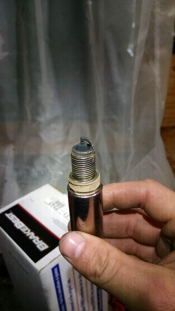

1988 3vze no more than 6000 miles on professional rebuild. Injectors cleaned and tested at time of rebuild no issues.
symptoms:
ran fine two days ago then:
starts fine cold until ANY throttle input then it loses all power and barely idles at 100 rpm, once it reaches operating temp idles terribly but will rev up to 2200 rpm then acts like its being limited there, laggy throttle response at all temps. when ignition is turned to "ON" fuel pump runs continuously, i can clearly hear the fuel being sprayed into the cylinders. all 6 spark plugs are fouled, looking into the cylinder all I see is black soot. after shut down i can hear fuel in the lines dumping into the engine until the pressure equalizes in the system.
what I have ruled out:
No vacuum leaks, initially I thought I had a major vacuum leak but a bottle of starting fluid ruled all that out. I haven't checked timing but I cannot turn the distributor so IMO I don't think timing is an issue. obviously fuel pump is working. fuel filter was changed when the rebuilt engine was installed.
So...
looking for more input, I guess I am a little overwhelmed as to how many things can cause this issue. First thing that comes to mind is that there is a sensor telling the ECU/EFI that the engine is in a overheating condition and is dumping fuel in. along those same lines maybe there is a wiring issue. before i start replacing all the temp sensors and senders can i test them? anyone have a table of values for them? or even better does someone know a cause that is super duper simple?!
