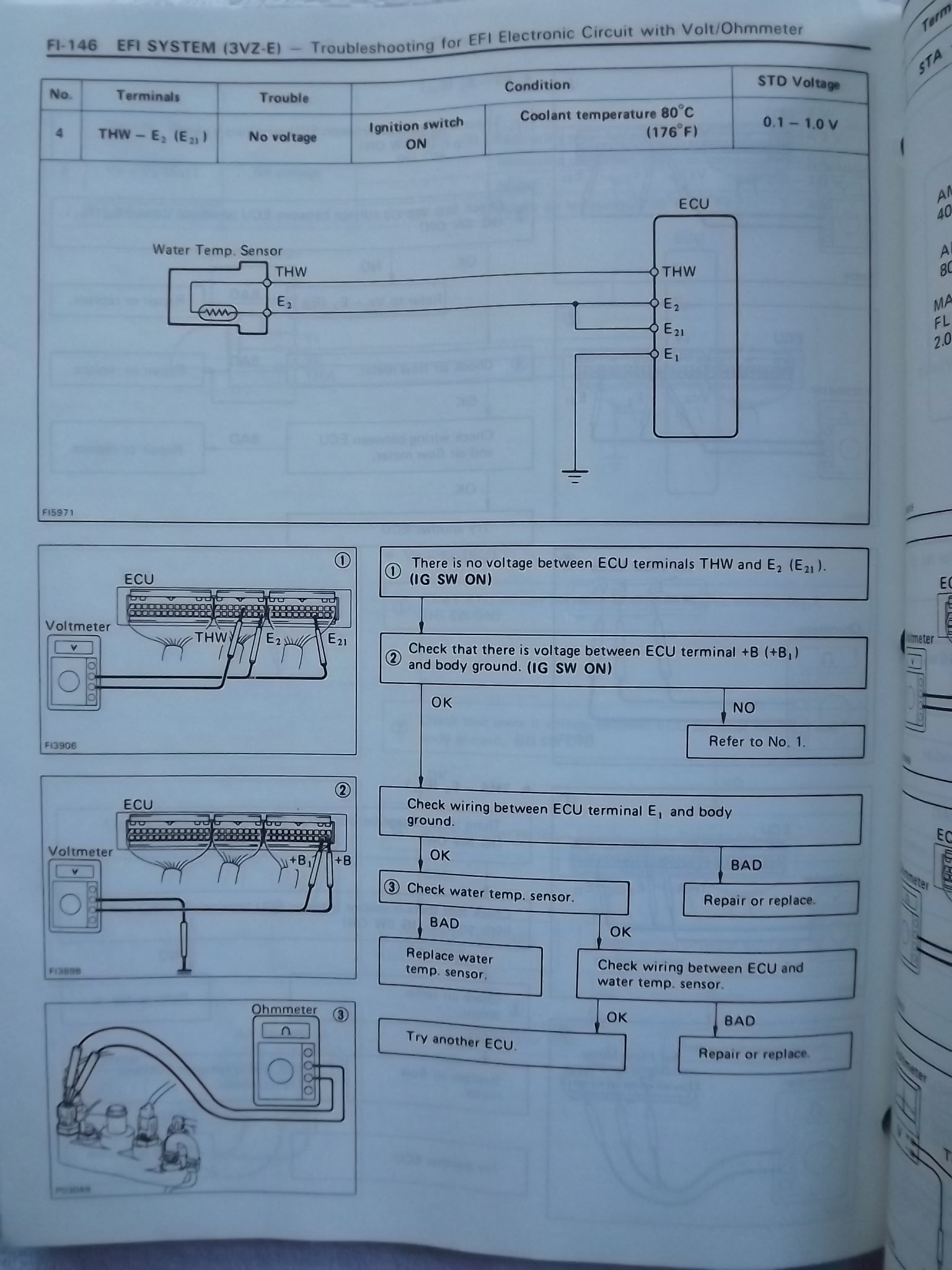

Glad you got your fixed. I just replaced the head gasket, now have code 22 and same symptoms. Idles fine, timing show spot on, but hesitates on acceleration. 1992 FSM says code 22 is a "open or short in the water temp sensor circuit for .5 seconds or more. Trouble area Open or short in water temp sensor circuit; water temp sensor or ECU."
I am still troubleshooting mine, but for others that might have this issue, I have attached a picture of the procedure.
