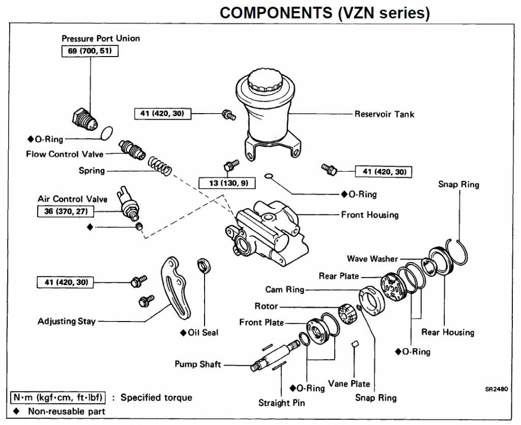

Away from my truck at the moment and I can't remember where the vacuum lines lead to, but isn't the "Air Control Valve," shown in the diagram below, somewhere in the intake circuit? Someone please correct me if I'm wrong! I'm working off of my shady memory here!

The "air control valve" (see the picture above) is just a vacuum switch operated by the pressure in the PS pump. If the diaphragm in the valve fails, there is a connection from the ATF in the pump to the vacuum of the intake. Sucking ATF into the intake does you no good at all.
But it's easy to check; just trace the two hoses from the valve up to the plenum, remove them, and see if ATF drips out.
When I replaced my PS pump, the rebuilt came with a new air control valve. If you're pretty sure it's leaking "from" the pump (rather than from the high pressure hose, for instance) replacing the pump might just take care of it.
