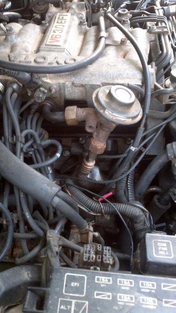

EDIT: OK not sure how i missed this but....
i cant seem to find any loose connectors but I can dig more.

I may have misled you a bit in my first post. If the throttle is completely closed so that the idle switch is closed on the TPS, you'll get 0V for both of those measurements. The throttle has to be slightly open so the TPS switch is open. That's why I suggested also doing the measurement at 2500 rpm, where you're sure to get valid readings on VF1.
If you truly are getting 0V both with and without TE1 shorted, and the throttle off idle, you have a confused control loop. The O2 sensor is telling the ECU to enrich the mixture, and the ECU is doing its best to lean it out, and it's still too rich. You might want to check continuity from the O2 sensor and the diag port back to the ECU.
