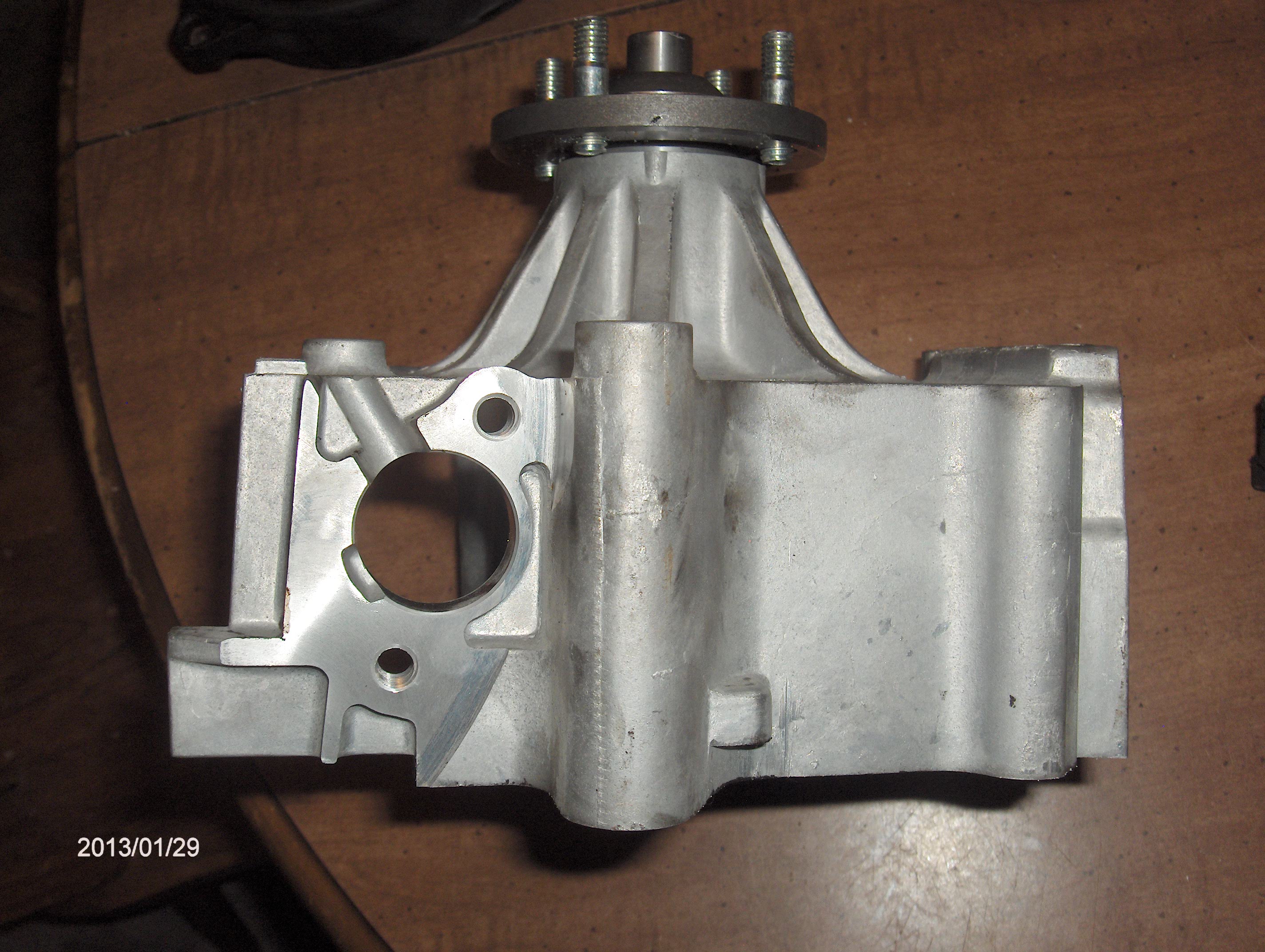

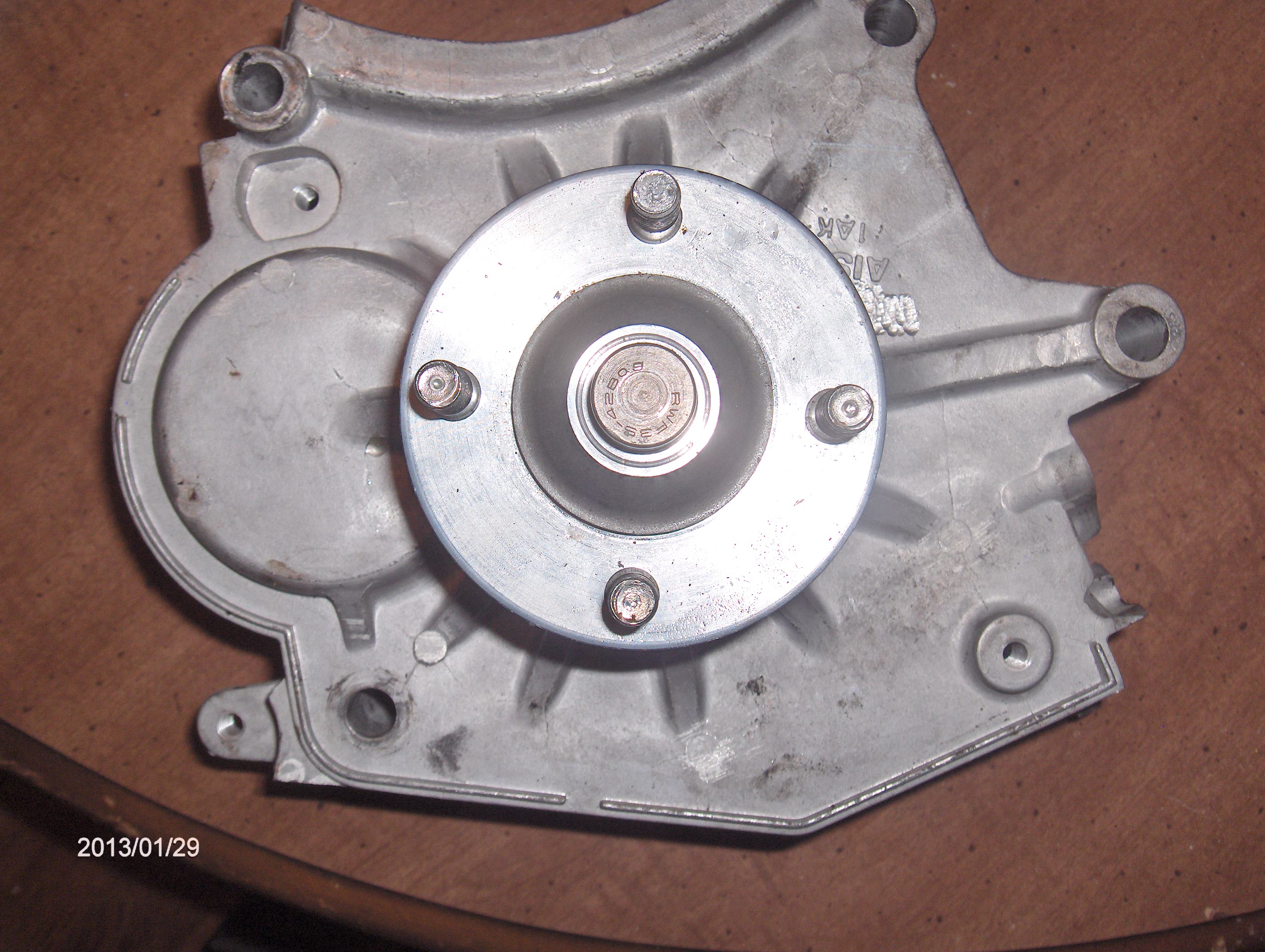

my fan bracket seized up on my 94 4runner on sunday; no auto parts stores in my area stocked the part, so i decided to order one online. i found an aisin at amazon for $98, i paid an extra $25 for one day shipping; when the part arrived i noticed it was a little different, i didn't want to send it back, so i trimmed the timing belt cover and did some grinding on the bracket, i think it will work now. i don't know what the extra hole was for, maybe you guys will know. here's some pics of the two.

I got mine from Napa. I also had to trim one of the brackets also because the casting was a little off. As for the extra hole mine did not have that. Hope u get it fixed!

Its not a super-old thread, so I'll bite.
That extra hole is for the hydraulic tensioner that the 3VZE's had starting in mid-1994. I assume yours is the older spring-tensioned kind. You are correct in that you got the wrong part. I hope you sealed that hole up somehow, as Toyota went through a lot of trouble to make the timing belt area water-tight.
