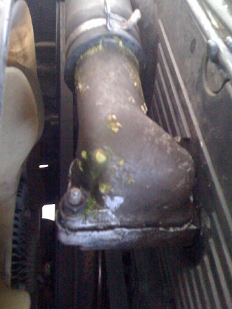

yesterday i was looking to my 4runner engine and feel a strong coolant odor!! so a leak was in there but where?
i found that the engine water outlet was corroded and has little pinpoints holes that leaks when the metal expand,so i cleaned and take for a ride after 20 min. inspect the water outlet again and it was leaking a drop or two by minute.
so i know is time to replace it but i cant find it in any auto part shop. i live in puerto rico and i dont want to get an used one new is the way to fix it.
any help with this???
thanks!!!!

You could try cleaning it and using JB Weld. Follow the directions on the package to make sure you get a good bond.

You can order this part at the Toyota dealer.
Don't forget Toyota Seal Packaging 102 (FIPG)
to make the "gasket" for the part.
