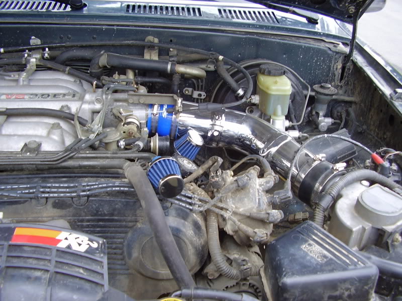

you dont need the snorkel right away but, and ISR mod is dirt cheap, and so is drop in filter, about a $100 total, trust me it will a big difference
i bought this from summit racing, its a build your own intake

Yeah that looks good. heres the guide i'll be usng. Im gonna use exhaust pipe and have it fully customized and what not. here, take a look.
https://www.yotatech.com/forums/f130...4runner-75167/
