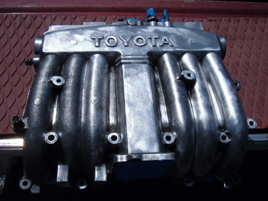

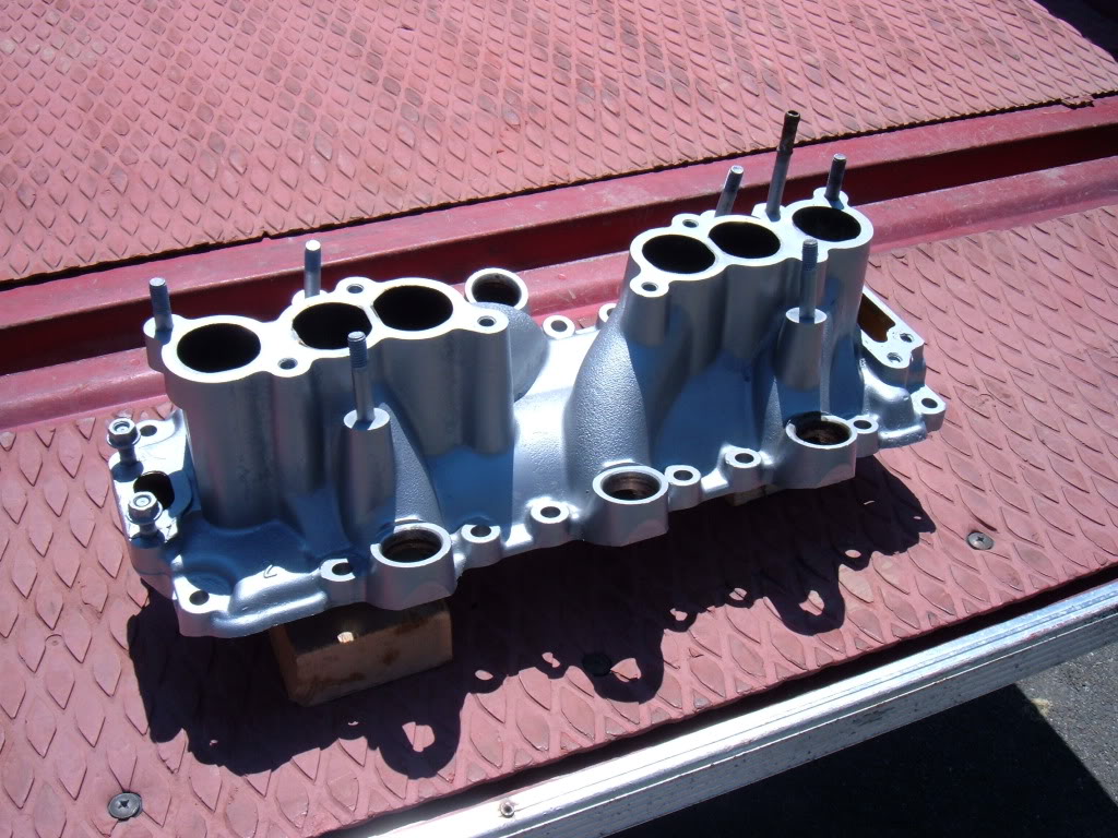

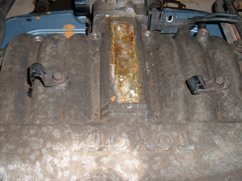

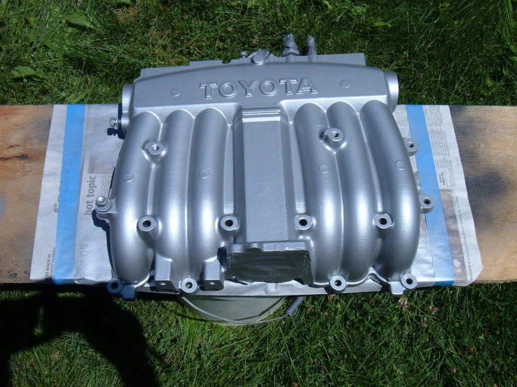

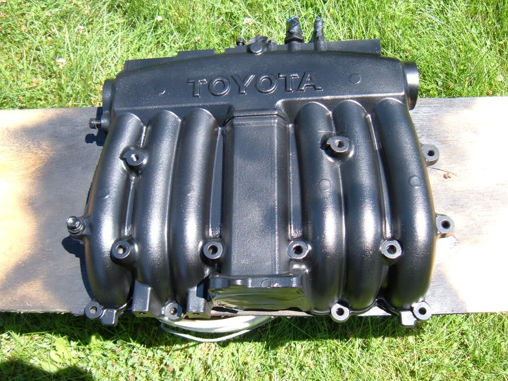

no soaking. just a wire wheel and persistence.
and pics.....cuz I'm a pic whoore.

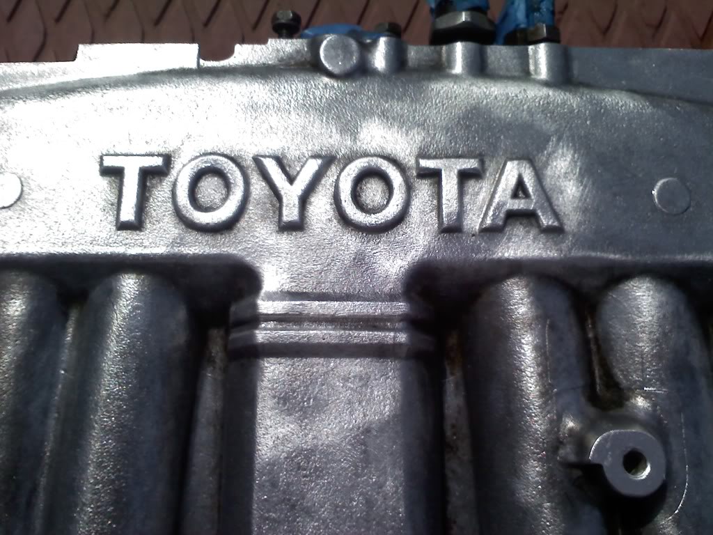

After being bathed in solvent tank for hours , then had the hell ported out of them , then degrease wax remover spray then 4 coats of vht high heat primer coats , then four coats of vht cast iron metallic high heat spray paint , and a new badge , and used testers red model glue on the raised Toyota lettering thou doubt that's gonna handle the heat ? It's the finished product for my engine build in a few months .
