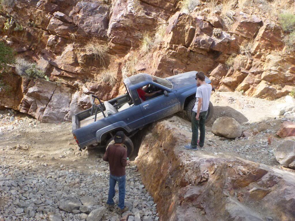

Thread resurrection!!! 4wheeling last weekend P accidentally had my 88 3vze up to 7000 rpm when i high centered her haha...id rather not do that again...anyone have experience with any aftermarket options for rev limiters out there for toyota?
pic for the heck of it:
