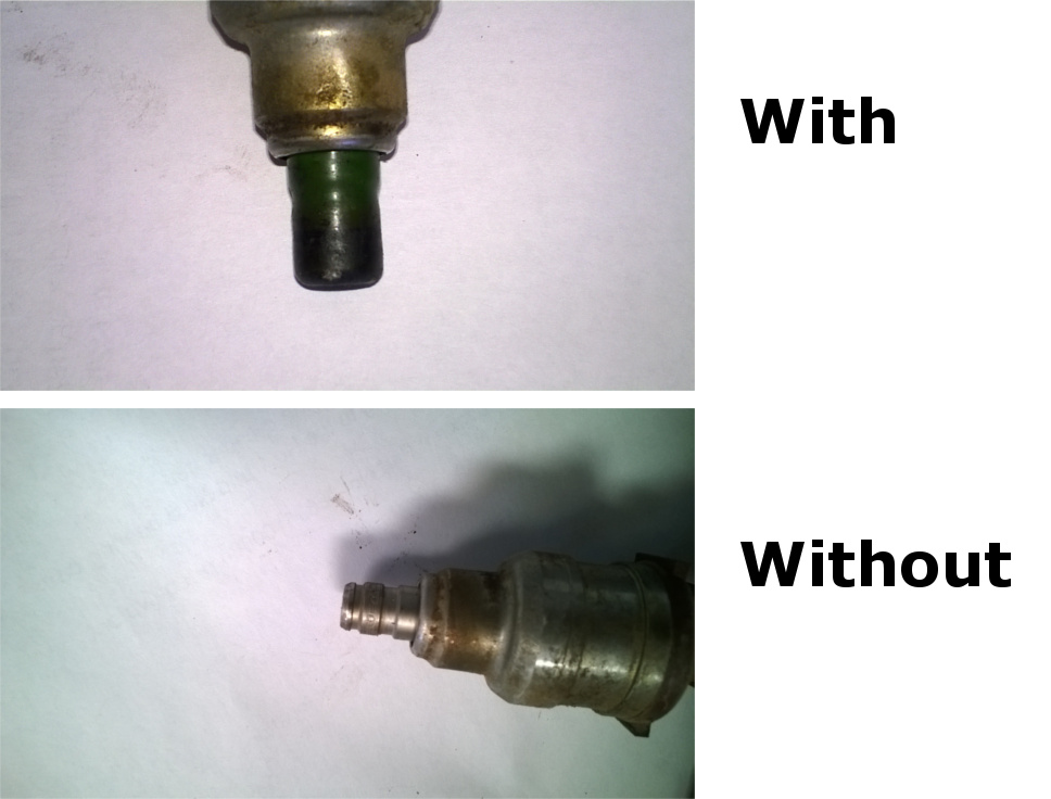

First I was looking for information on Injector nozzle "pintle caps". I took the following pictures to ask the question and then did a search and found part of what I was looking for in this thread: https://www.yotatech.com/forums/f116.../#post51129975
The first picture is the "spacer and the grommet"
The second picture is the injector nozzles, one with and one without the "Pintle Cap"
Three of the six nozzles did not have Pintle caps (some stuck in the spacers and broke when trying to remove). There was only Nozzle with a bushing out of the nozzle end of the injectors. Mr Injector seems to have a reasonable price for service kits.
After working on the pictures, I decided to post them anyway. Ha!
Now for the next question. Does anyone have a good source for the electrical connector ends for connecting to the injector nozzles?

I have NOT ordered from these folks. http://www.driftmotion.com/category-s/1847.htm
I don't even know which one to get. But you should be able to tell just by comparing yours to a photo, and then you'll report back.

Thanks Scope,
That was the info I needed. The ones I need are "Top Slot" or F1. I found them also on eBay without the wire pigtails (less expensive and free shipping). All I need are the plastic pieces.
