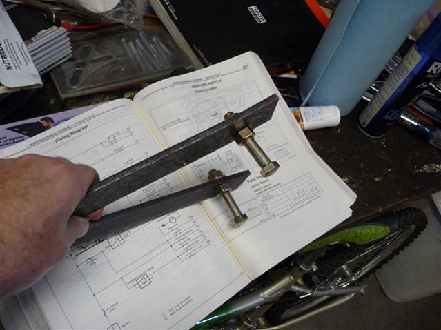

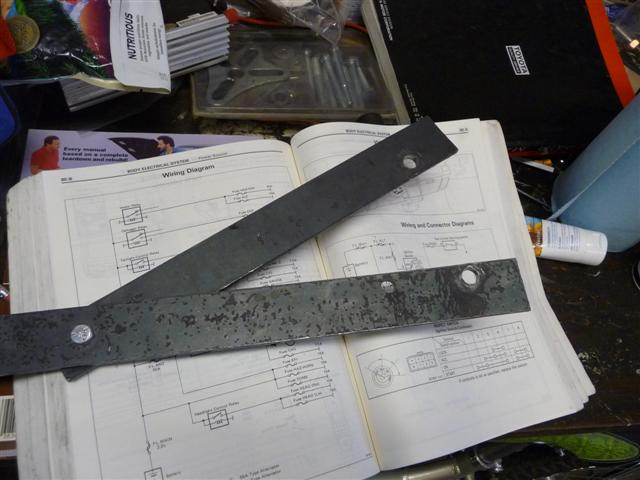

I always replace the cam seals as a cheap precaution against leakage that will ruin the timing belt so I remove the cam pulleys. I made a special tool to remove the pulleys that works great and makes the job simple. For a description of the making of this tool go here: https://www.yotatech.com/forums/f116...l-tool-186081/
In my experience, the crank pulley will have to come off to remove the timing belt as the belt goes around the inner crank timing belt pulley, which is behind the lower timing belt cover. The lower timing belt cover cannot be removed unless the crank pulley is removed. A steering wheel puller will work fine on the crank pulley. Replace the crank seal while you're there.
Bolt the tool onto the crank pulley where the threaded holes (8mm x 1.25) are and it will hit either the floor or frame and stop the crank from turning while you remove or install and torque the crank bolt.
Install the two gold bolts in the tool and it can be use to hold the cam pulley from turning while loosening or re-torquing the cam bolts. Place the gold bolts through the openings between the spokes of the pulley and then use a pipe on a breaker bar to loosen the cam bolt while you hold the tool to keep it from turning.
