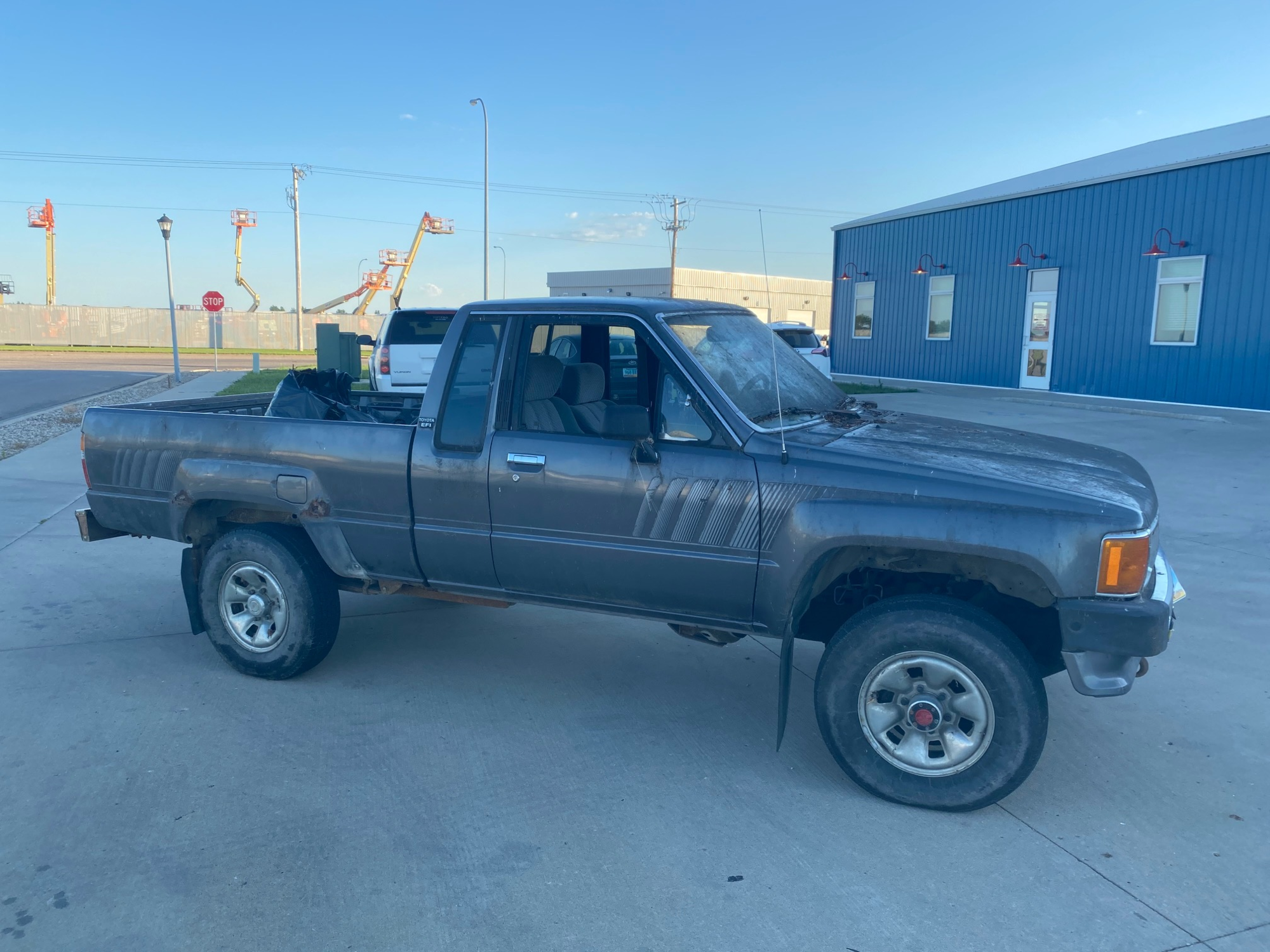

Been eyeballing this truck sitting in the trees in someones yard for about 4 years now and finally the opportunity to get it came up. This was the first time i got to see it up close and thats when i saw the dreaded V6 emblem on the grill. Big time bummer but the price was right enough to still bring it home. Next project turned to parts truck just like that. Hate to kill a complete truck but I cant afford to have a 3.4 swap done in it.

I wish there was something to like about it. Runs but its like the accelerator pedal is disconnected (its not) and I do not have the know how required to diagnose and repair one of these engines. Trades for a 22re truck are welcome

changed out the fuel filter and put some fresh gas in it (Id rather do a 22re fuel filter blind folded than one of these again), cleaning the airflow meter seemed to help at first, then not. swapped it out with a known good one, no change. Starts up and idles and acts like the gas pedal is disconnected. can hold wide open throttle and it pretends like its not happening, just idles, poorly. checked all hoses for cracks and leaks. can not find any obvious ones and cannot find any by spraying carb cleaner around them.No check engine lights or codes stored. Washed it up and did a quick vacuum and its actually a really nice rig. would be a great candidate for a 3.4 swap. Maybe ill have to sell one of my 4runners and get it done. Or maybe I can find someone with a 4cyl truck that wants to trade (hint hint ..I like regular cabs and will travel..haha) I was so excited to finally get my hands on this truck, its such an epic let down that its a 3.0

Put plugs, wires, cap and rotor in it just because it never hurts and it didn’t make any difference. Then decided to check into the timing...that was the problem. Jumpered the terminals and set it to 10 and it goes to 8 when removed. Set idle at 700. Runs and drives great now. Very responsive and smooth. But to get the timing where it is I had to max out the rotation of the distributor. I’m guessing it may have been installed a tooth off at some point in time. Hoping maybe they did some work to it like a timing belt and never got it in correctly and left it as I’ll is. Going to check it and see if I can get it lined up better. But for now runs great.

Ive pulled the distributor out and tried changing the position about 100 times and it will not run in ANY position but where its at now. Which is with everything lined up correctly. But i still have to crank the distributor ALL the way clockwise to BARELY get it to 10. I assume the timing belt has jumped or something. I figure if im going to dig into it i may as well just do a new belt, water pump, etc. and be done with it since i do not know if/when its ever been done. For now it runs and drives pretty well.
