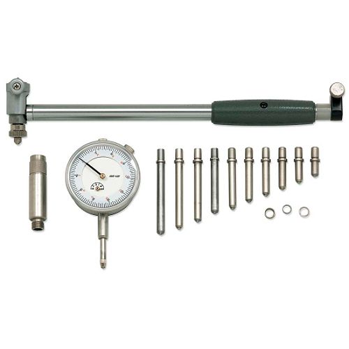

A cylinder bore gauge to measure the cylinders for the correct size pistons/rings and to check for cylinder bore distortion(out-of-round/taper). Which can also be used to check the connecting rod big ends for correct bearing size too.

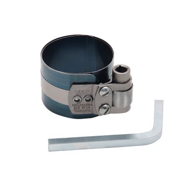

A piston ring compressor to re-install the pistons.
